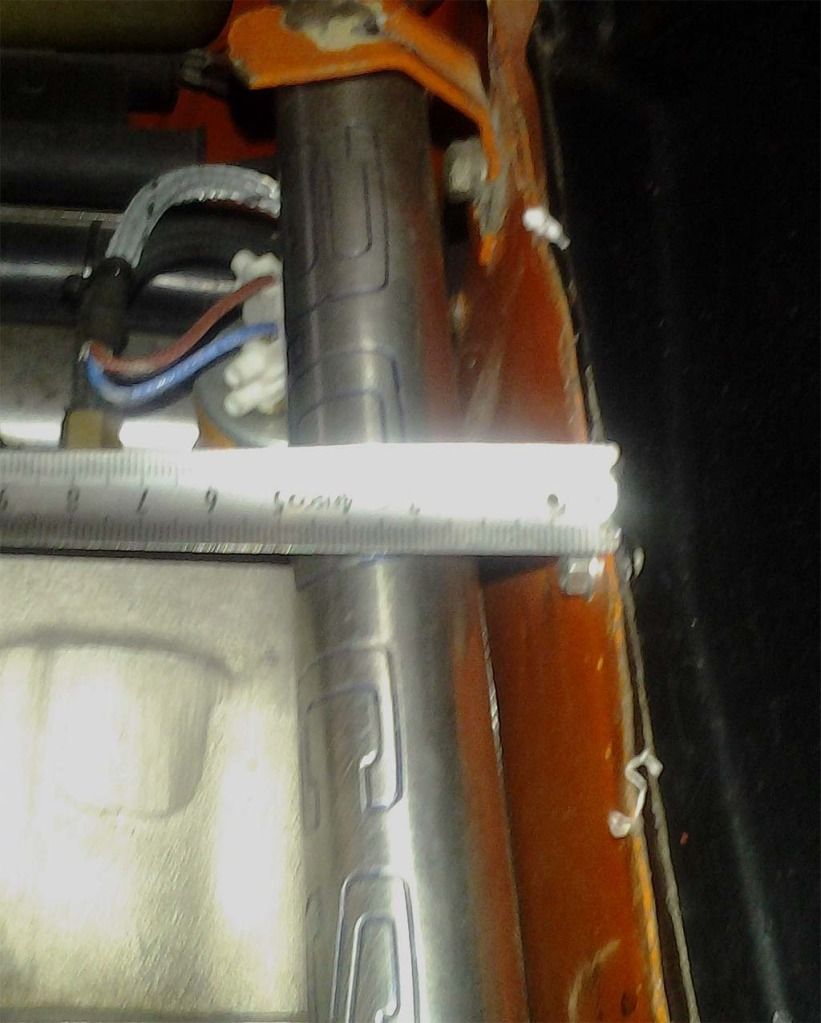

Strut bar.......
Orangener
1,100
93
Vienna, Austria, Europe
Surface treatment : plates are black anodized, rod is brushed stainless steel, all other parts galvanized
I deliver the strutbar with untreated plates, you can leave them untreated, powder coat in any colour or paint with lacquer.........
The CSL hood support is needlessly complicated, therefore I will make the corrections on the casting mold
The pedestal for the rod is optional, only for those who need the CSL hood support, the engraving too

Still in progress ! I was on vacation, now I´m still searching for a foundry to make the plates. The problem is the price, delivery time and the correct material.
I try to make 30 sets.........
Orangener
1,100
93
My search for a foundry is finished, thank God, yesterday I found a plant!
They will make me the 30 sets, in suitable material for a fair price in a reasonable time.
It will took more or less 6 weeks to held them in hand, so the complete machining maybe ready before X-mas..........
Next question is the shipping...........to find a facile solution for such a bulky parcel, because I will try to make a all-round carefree package, with the pre-assembled strutbar ready to mount.......
I'll still keep you informed. ;-)

That's great news. Thanks for doing this. Questions:
1. What is the material for the mount ? (the section which is bolted to the shock towers). It almost looks porous.
2. For shipping, I highly recommend not using DHL. Having run logistics for companies in the US (think millions of units shipped), I have never had a good experience using them.
Thanks again.
Orangener
1,100
93
@David :
The last foundry made the casting with coarse-grained sand, its not porous, only rough. The new manufacturer promised me to use oiled sand, to make the surface much smoother.
The company, where i do my job, has a own shipping department. I will ask the young lady if she knows a solution for my problem ;-)
