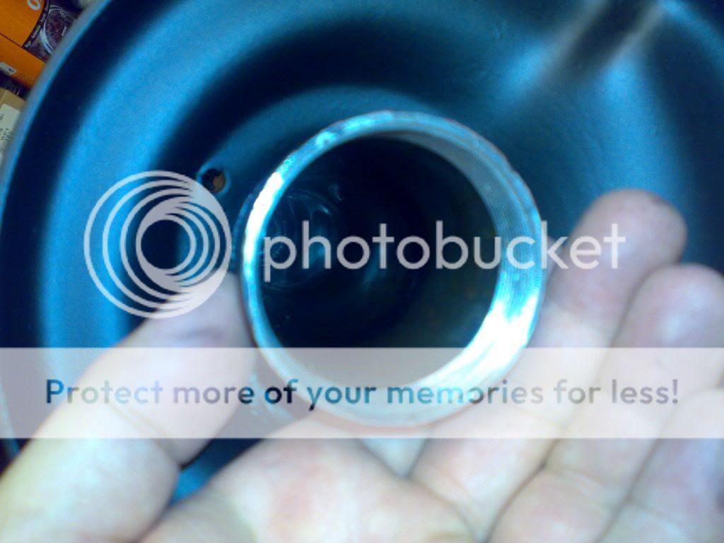

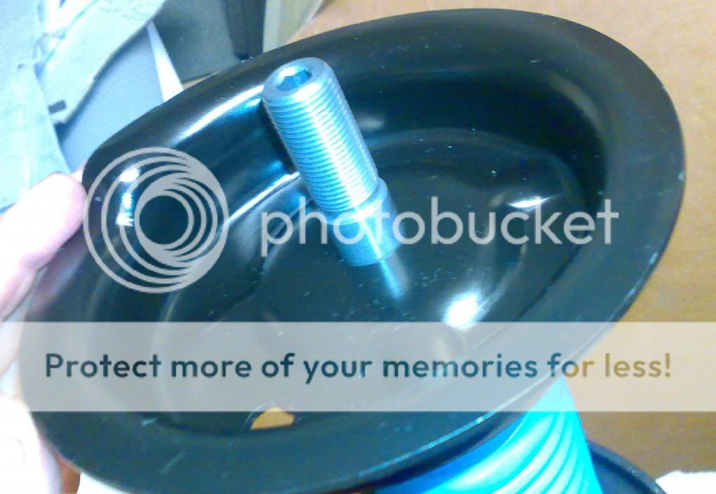

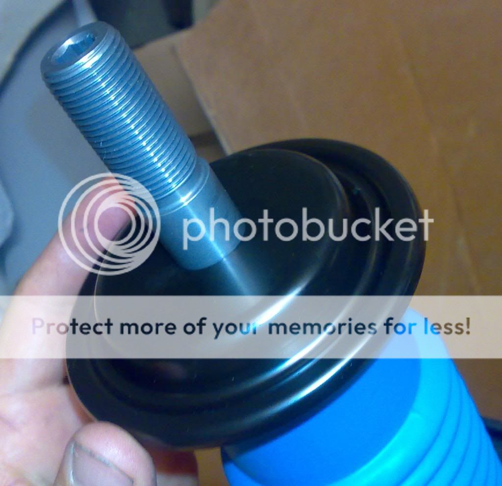

another question

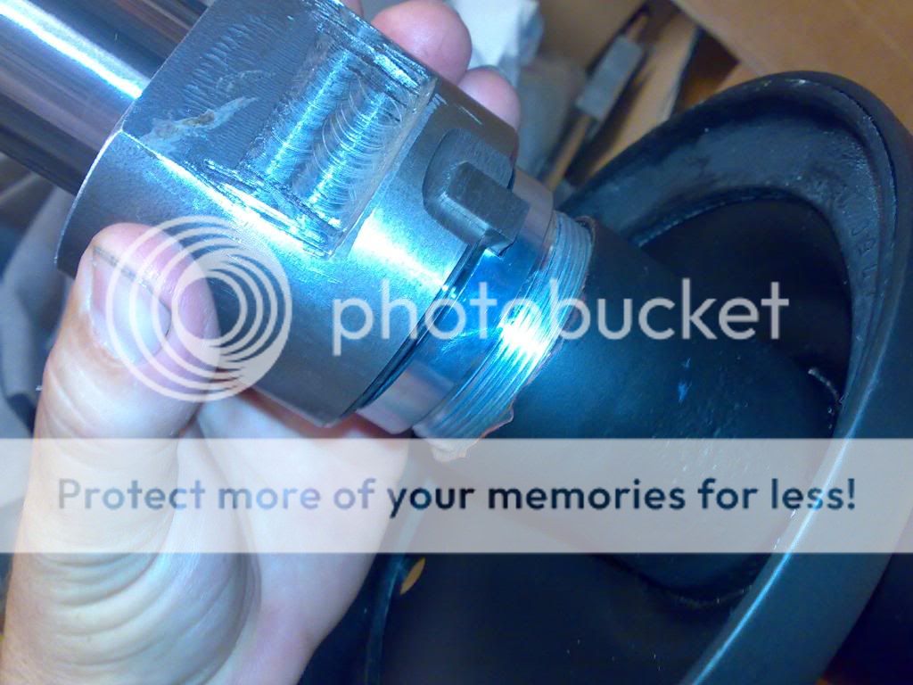

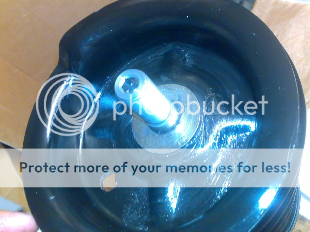

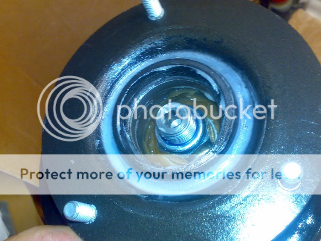

in the front shock tower there is a big nut that retains the shock, in my car the PO installed KYB shocks, and the original big nut was replaced by this:
now i am going to install bilsteinsHD, i have just ordered them, my question is:
1- do the front bilsteins come with a new big nut in the box ?
2- if not, did you reused the original big nut without problems ?
thanks
Stevehose
13,011
5,685
Sarasota, FL
Bilsteins do not come with the nut, it is specific to the strut housing. It should fit with the Bilsteins.

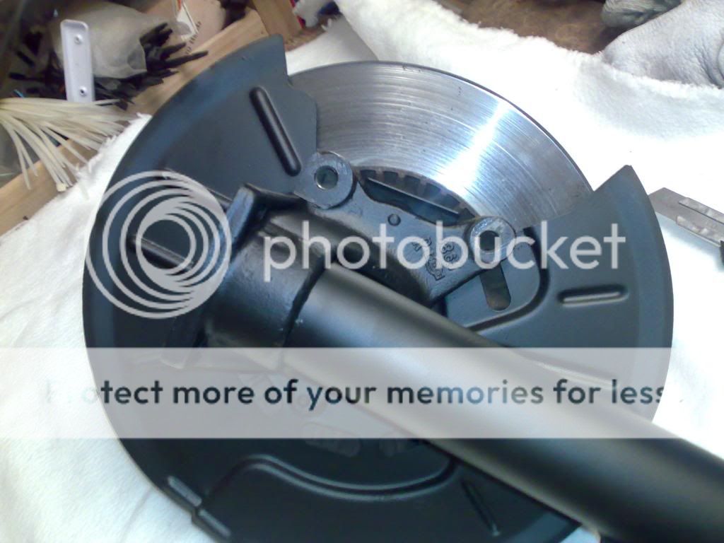

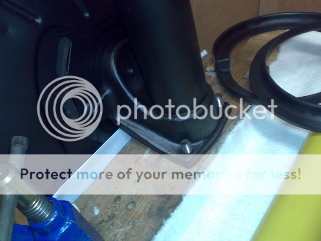

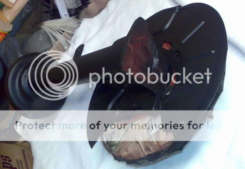

today start painting
anti-rust from rust-oleum:
two times in preparation for final paint, i will not go for original dark green colour, but black matt, in order to simplify things...

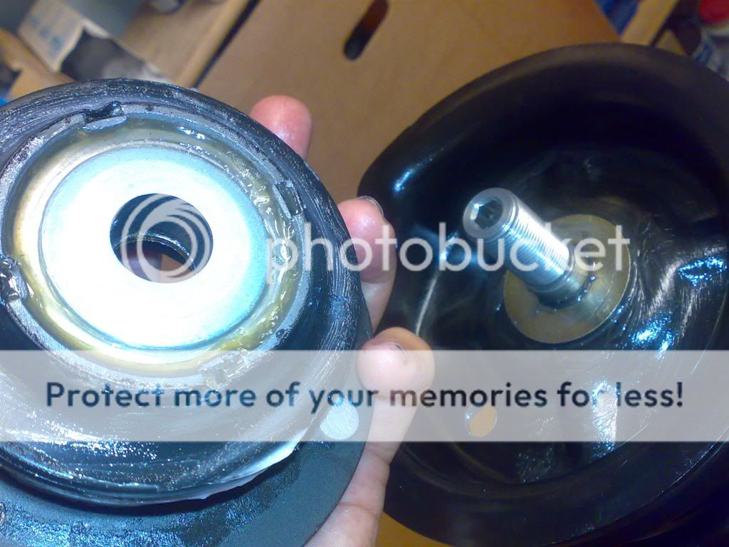

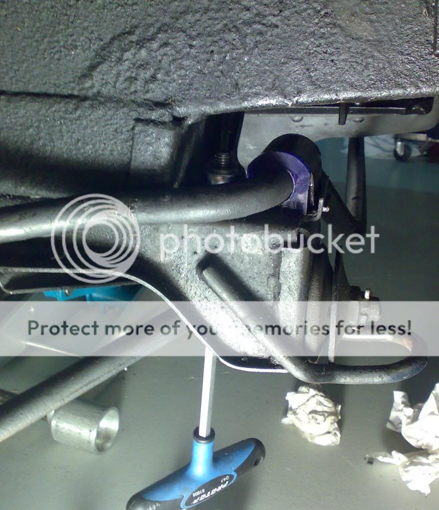

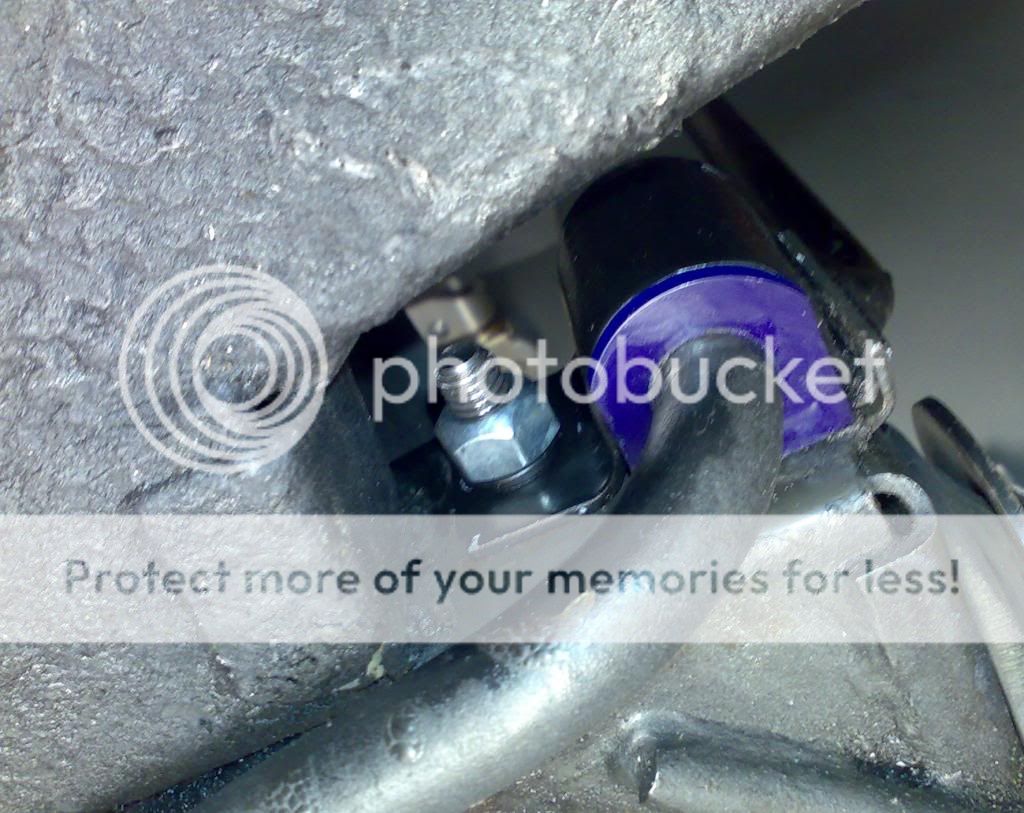

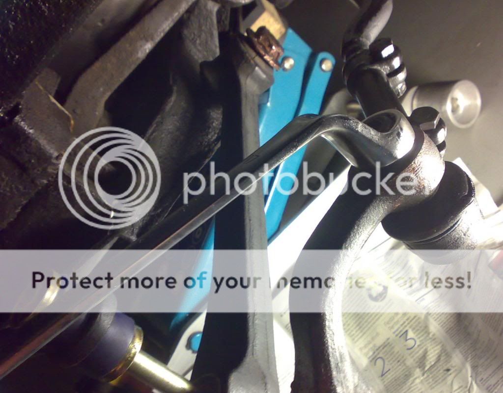

polyu bushings for the antisway bar
not very easy to remove this hidden bolt, i needed a 8mm allen tool and a lot of torque to remove it

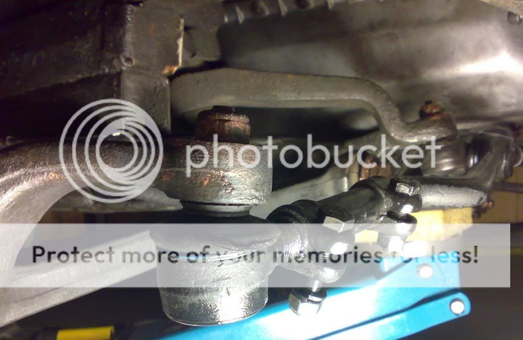

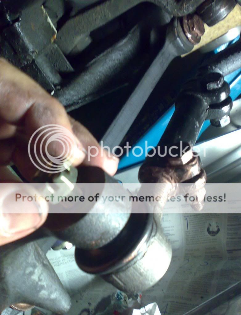

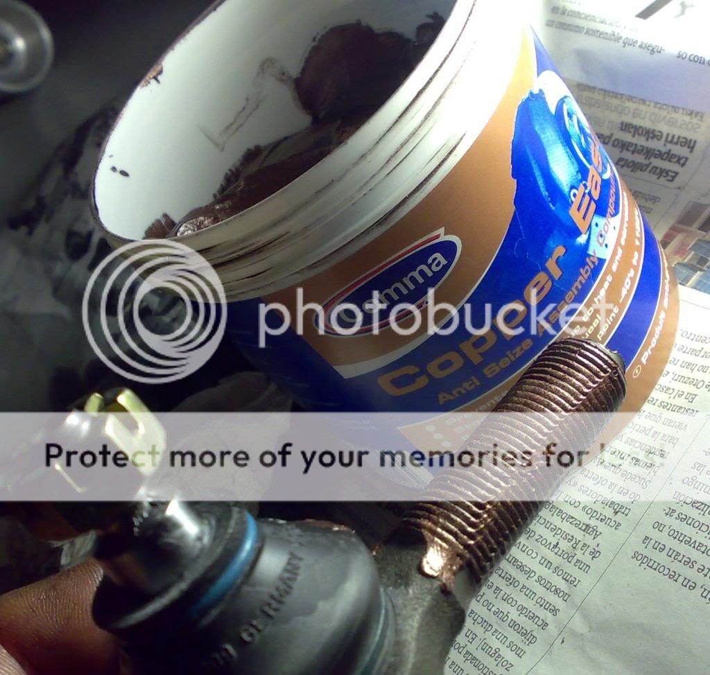

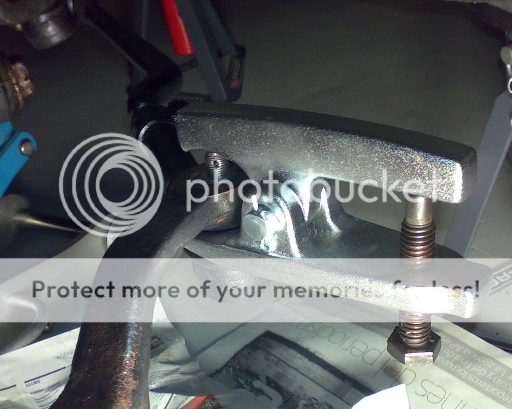

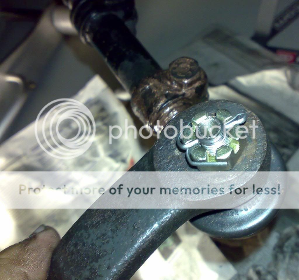

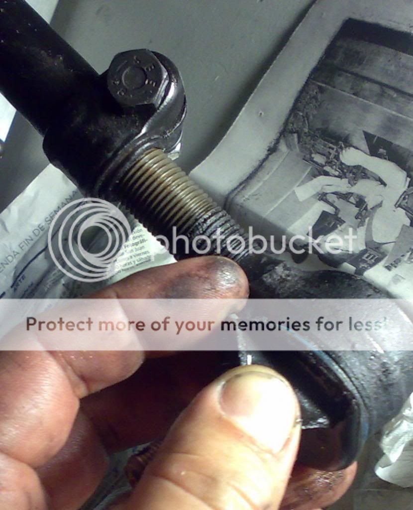

then the steering balls:
remove the 17mm nut
scissor extractor
new ball joint, using copper grease to avoid corrosion on the thread, i bought it in the uk (halfords)
i meassured the old ball joint position to place this new one, nevertheless i will bring the car to the shop to do it properly after i finish the suspension
40 N.m torque, and fixed with retainer
Cornishman
705
163
Essex, UK
There is a Big shaped Wäsher on the tie Bar, Does the hollow side Face in to Match the Bush, or outwards to to give a progressive effect When a Force is Experten on it? Your One Looks to be Faceing in, Mine Face Out!
Sorry for all the grammatical errors, my iPad Seems to have Been corrupted Since two Young children Moved in this Summer.
C
deQuincey
Quousque tandem...?
8,421
2,432
C
i do not know, i have not done this by myself, any ideas ?

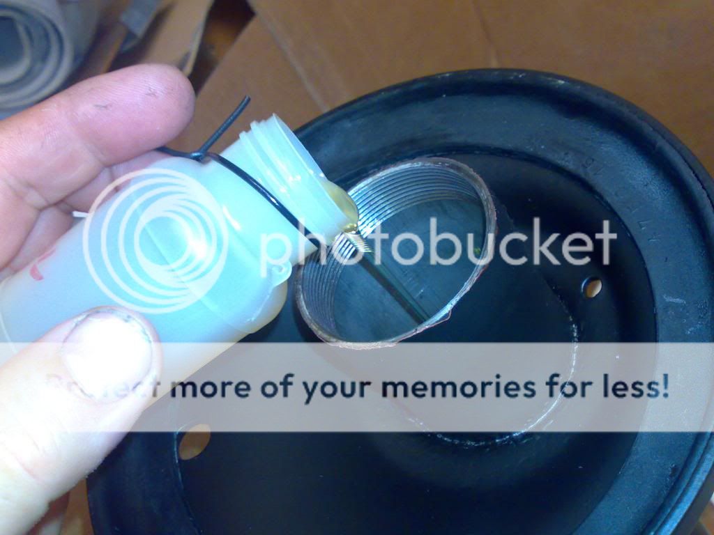

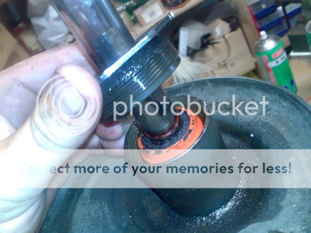

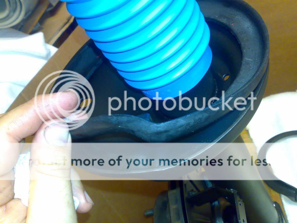

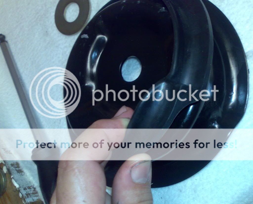

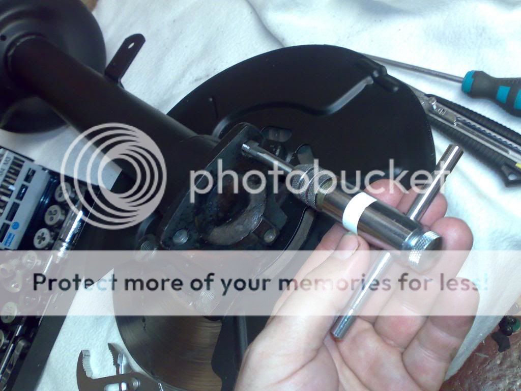

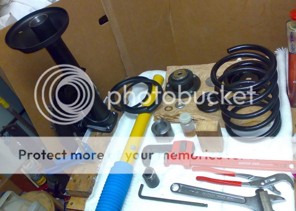

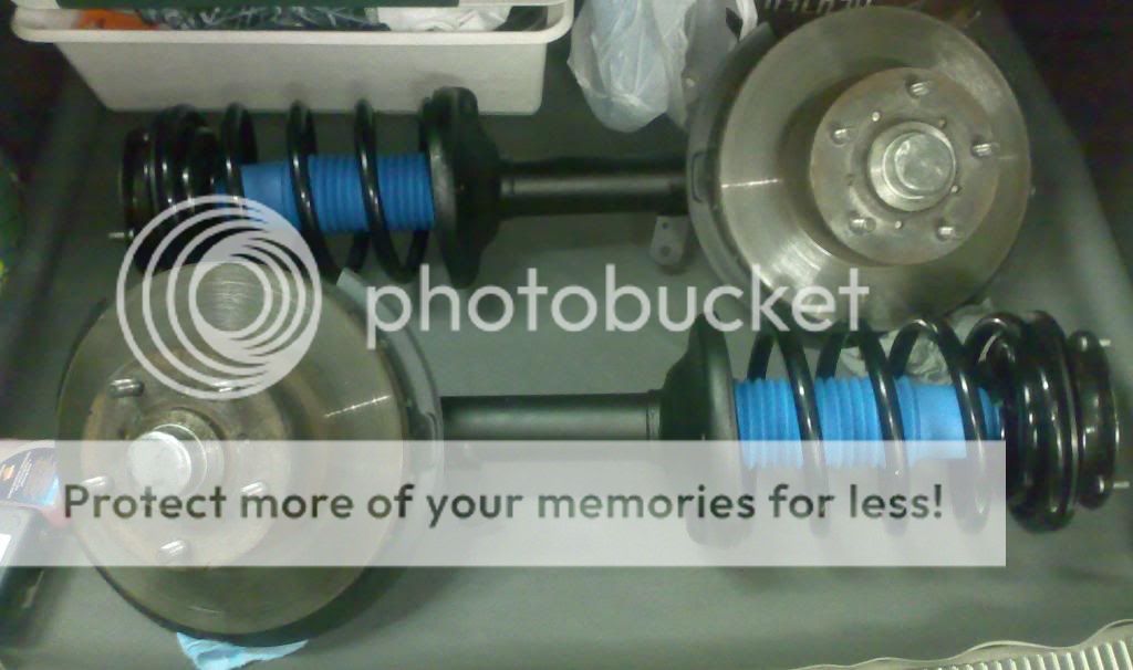

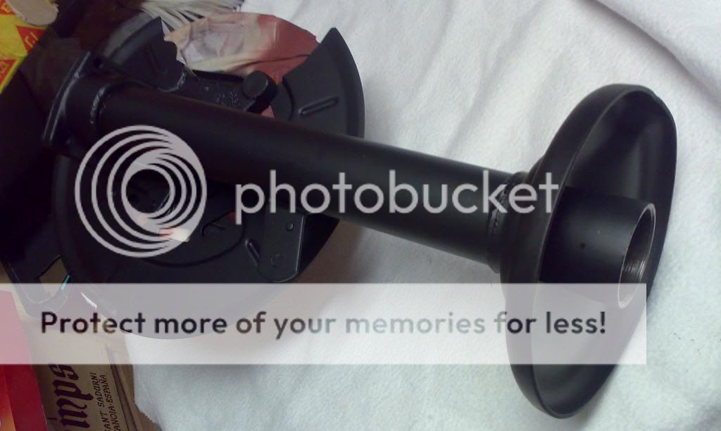

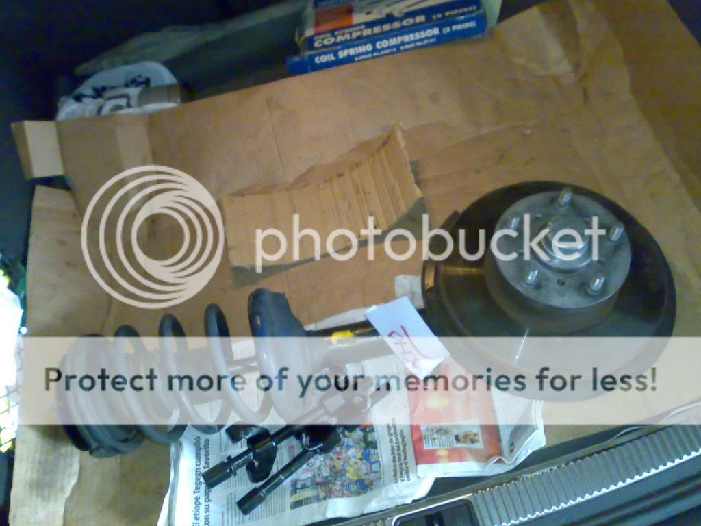

the assembly of the two front struts has been completed,

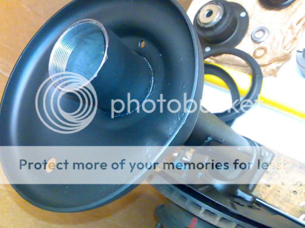

once the strut towers are painted, regreased and ready, i placed one in a solid and firm support

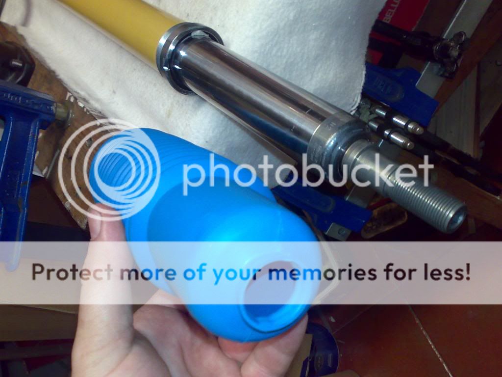

overview of the required parts and tools:

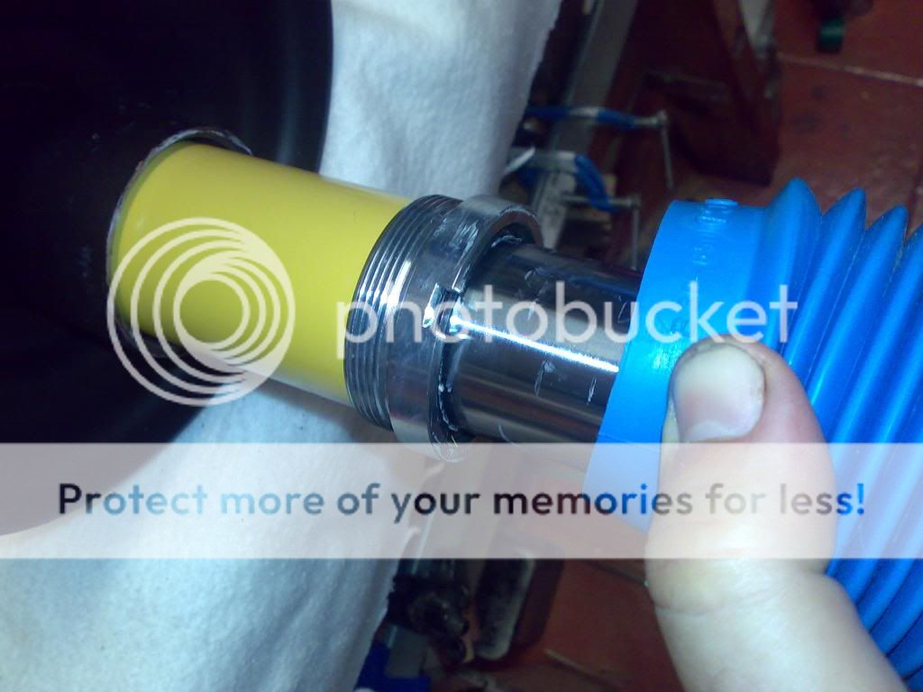

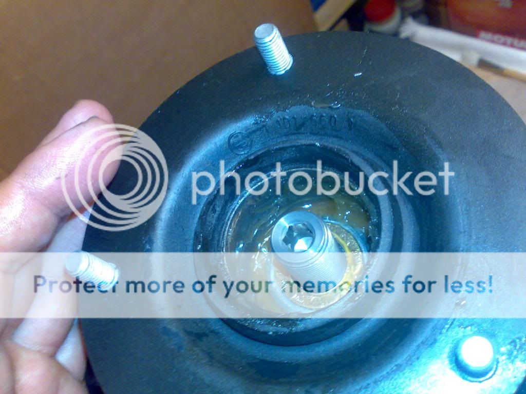

start removing the blue cover from the shock

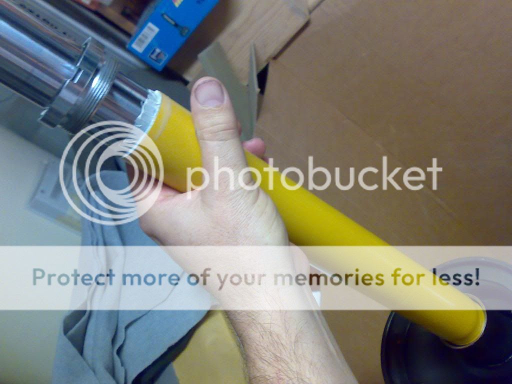

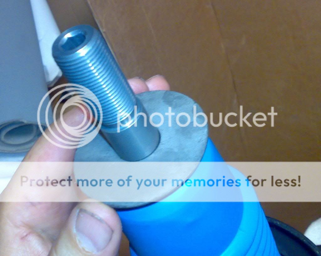

pour 40c.c. of engine oil into the strut cylinder
insert the shock

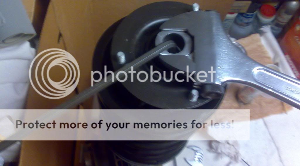

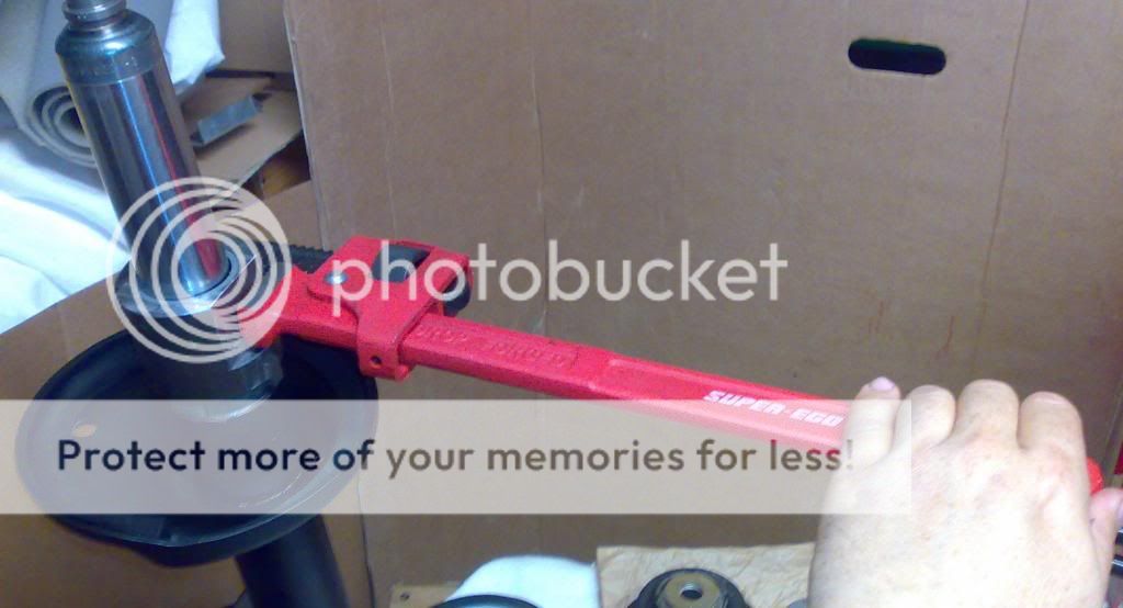

place the tool for doing the nut, torque must reach 130N.m

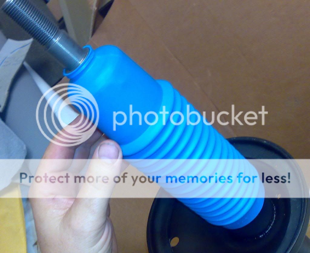

insert the blue cover again
sequence of needed pieces
torque 80N.m

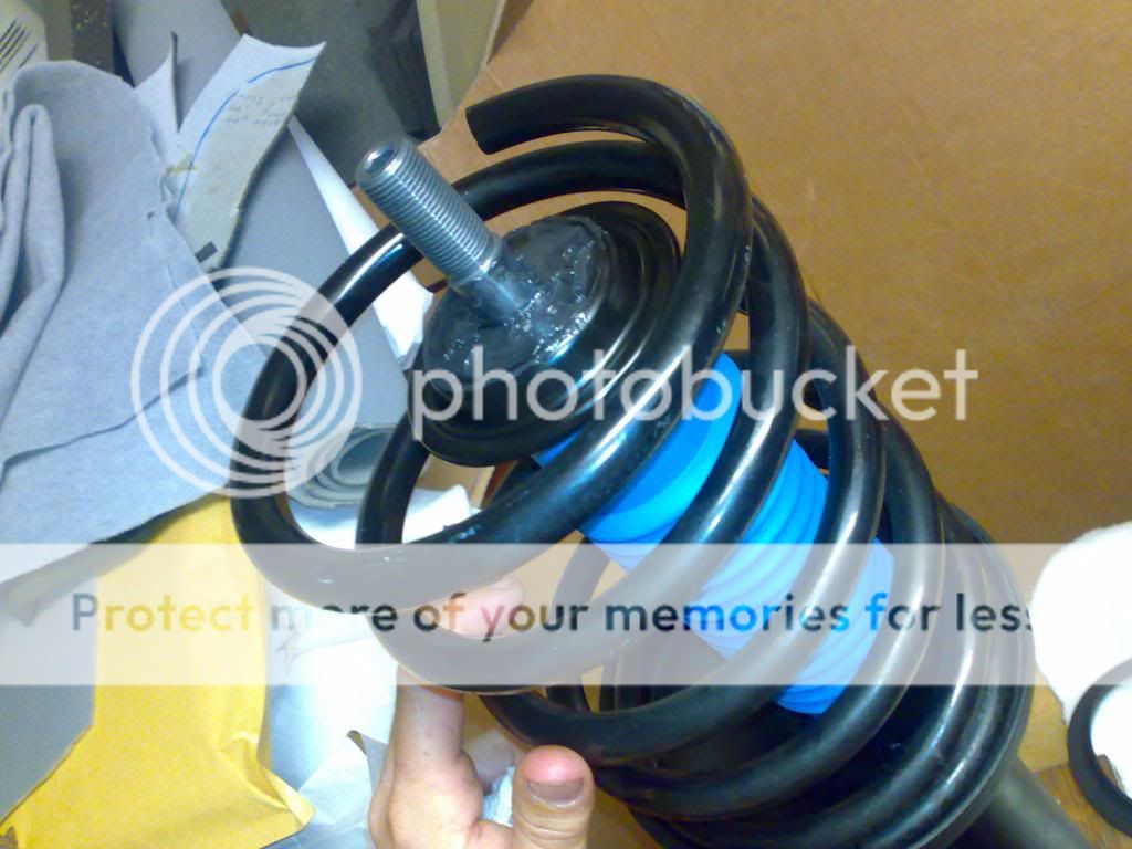

funny enough, the carl nelson springs do not need the compressors to be put in place...
ready...love when they are clean and neat
