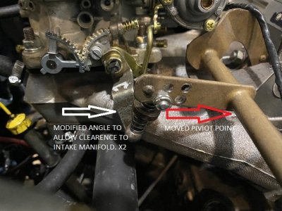

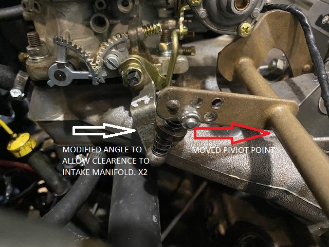

I have the post on sticking, my solution was different but effective. To my thinking the linkage was too linear to the throttle arm on the carbs which caused an almost locked situation (sticking). By removing the engine throttle linkage modified the hole location on each arm to allow for free floating motion. Achieved WOT on both carbs synchronized.
pickman
406
132
South Haven Michigan
Attached is a photo of the various positions of the linkage used to determine best location to preclude sticking. Slightly bent the throttle bracket on the carbs to provide add clearance to intake manifold both have to be identical. By moving the adjuster toward engine it eliminated the over top condition where the adjuster was pulling the carb throttle link strait up instead of rotating the carb throttle link. All adde holes have been filled for strength.

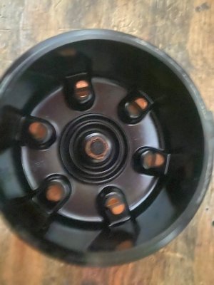

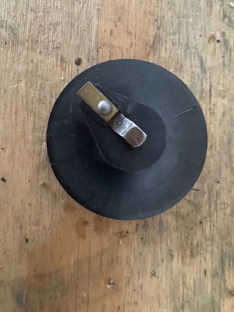

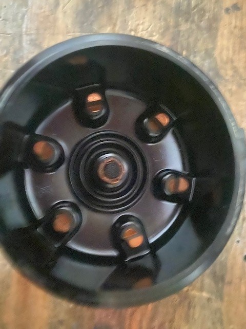

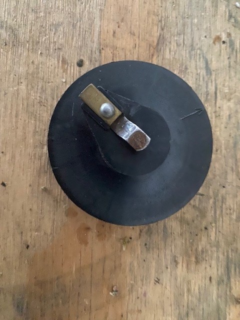

Been pondering the 123 upgrade. Below are photos of the Mallory cap and rotor note the rotor has plenty of corrosion on the center contact. Although the dual point original was adequate it took some fussing to get the dwell and timing on spot. This Mallory distributor was an upgrade 25 years back, the 123 is SO much more user friendly and performance enhancing. There is a unique stretch of freeway near me straight and usually clear of traffic. Using the Mallory ignition there was a noticeable slight shimmy (front end) at around 95 -100MPH that possibly due to the advance, could not get past it, was white knuckle territory, with the 123 the car blasted thru this and handling became smooth well into the 120 MPH range. This was a short duration test but relived my concerns on the top end handling, the car is capable of high speeds and good ride and handling unfortunately we do not have an Autobahn here. Too old to want to explain to the police, drive within the limits please. Thank you forum for good advice and help with many many issues.

It ain't perfect, but the 123 is a great piece of tech that unleashes the potential of the M30.
