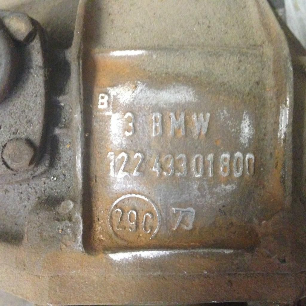

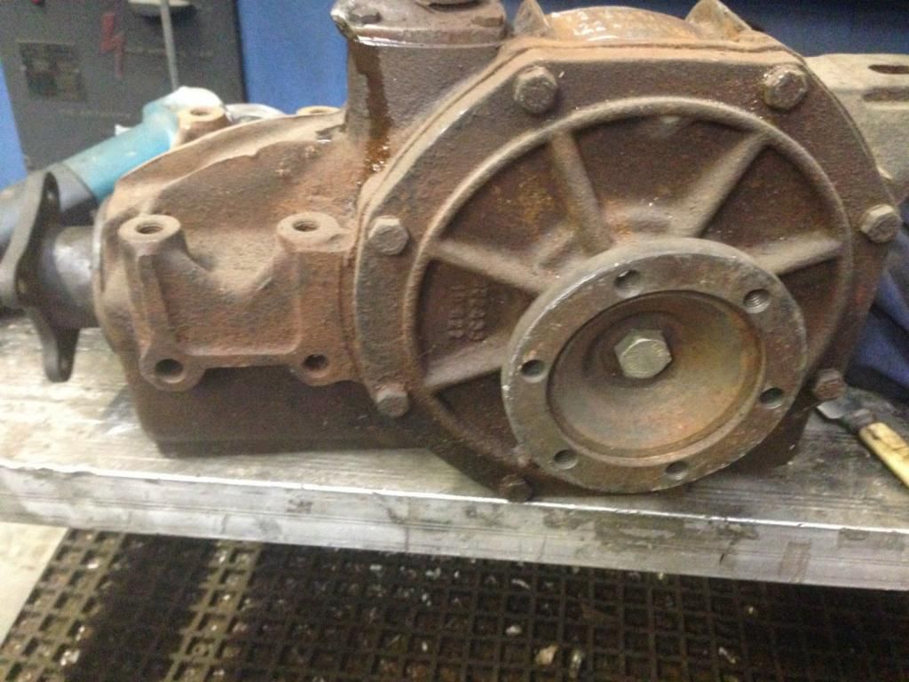

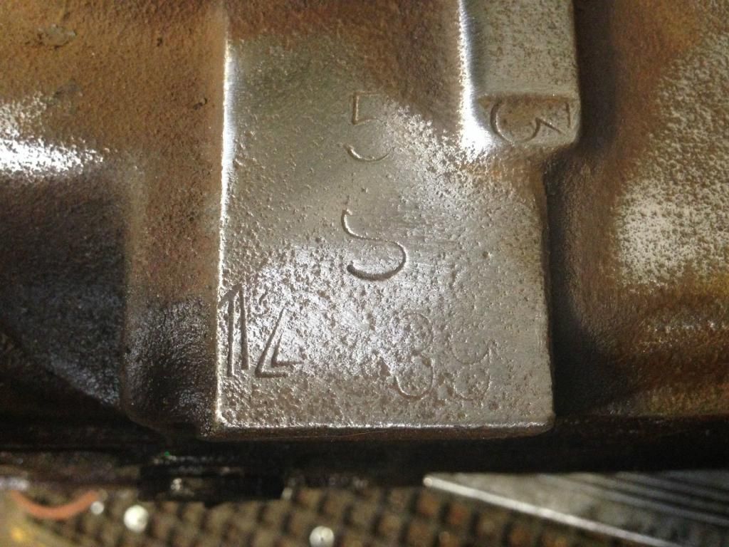

I was going to point out the one on ebay but it seems its the one in the photos. I seem to remember a white S being painted on them but obviously that can be long gone.
