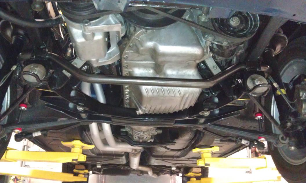

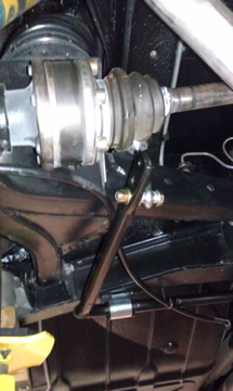

based on the feedback
I installed the heavy duty sway bars. Quite a difference in that there is very minimal body roll and I don't feel like I'm going to tip over when I go around corners.
Next question; I think the feeling that is still not quite right is that when I make a turn-left or right- say at about 30 MPH I get very little "resistance" in the steering. In the other cars I drive there is an amount of push-back that contributes to the road feel. With my set up it feels like it wants to turn TOO easily- I don't know if that makes sense? in-put most welcome!
