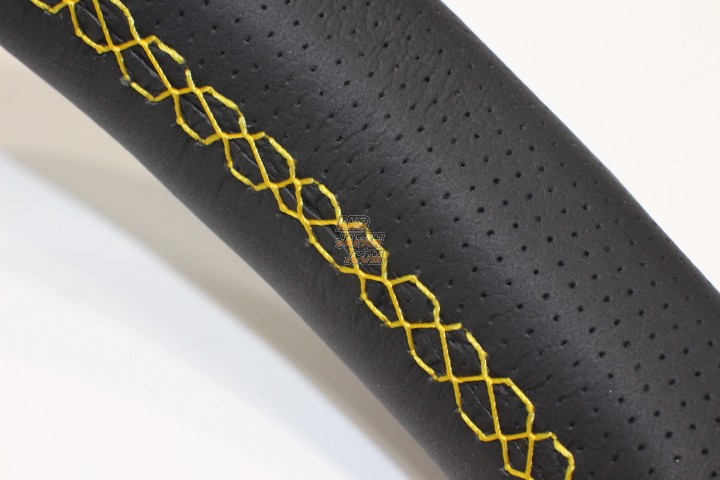

Euro Stitch
Momo Parallel Stitch. This one is interesting. What you see here is a new Momo Herritage wheel. They went so far as to include the "stacked" momo logo. The heritage wheel does not include the square stitch which ended in the early 80's
Early Momo Square Stitch on the back:
European Stitch Diamond/Hexagonal:
Parallel Stitch:
Machine Skiving (Hey I found one in english):

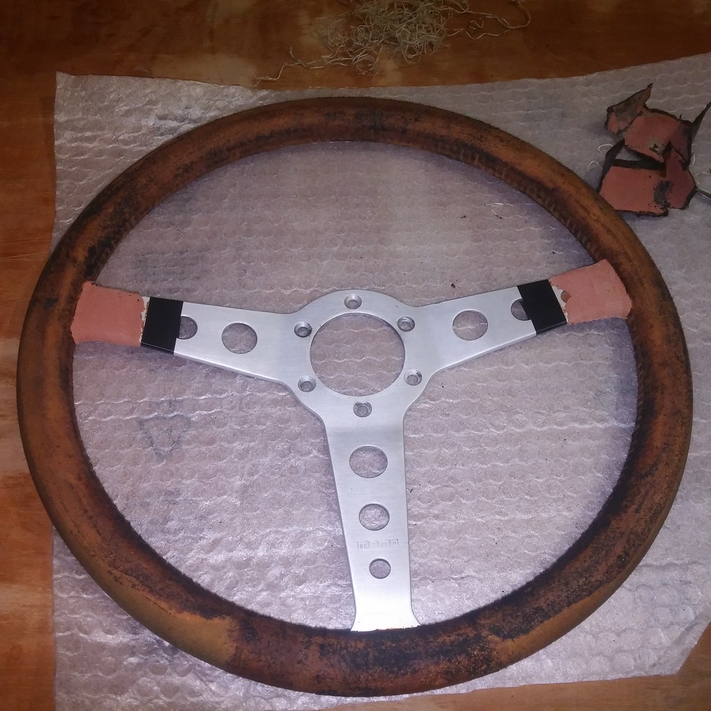

Here is an old momo wheel in the flesh. I’ll post some pics when it’s done. This one is from the mid 70’s after the stacked logo but before date codes started. I’ve seen his before with Shanon’s alpina wheel. Underneath the spoke wrap of a prototipo you will find a third hole (see upper right spoke). The prototipo, Indy, Le Mans, and Daytona all use the same blank.

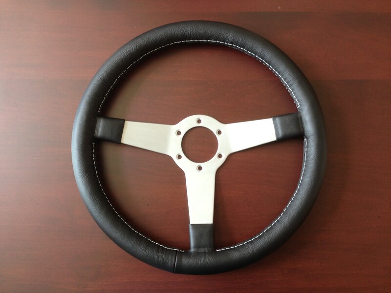

1st pic is a USA mashed potato filled item,

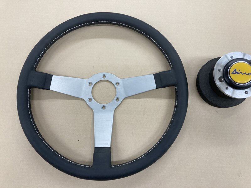

second one is one done by an ex Momo employee.
Same exact wheel.
You be the judge.
