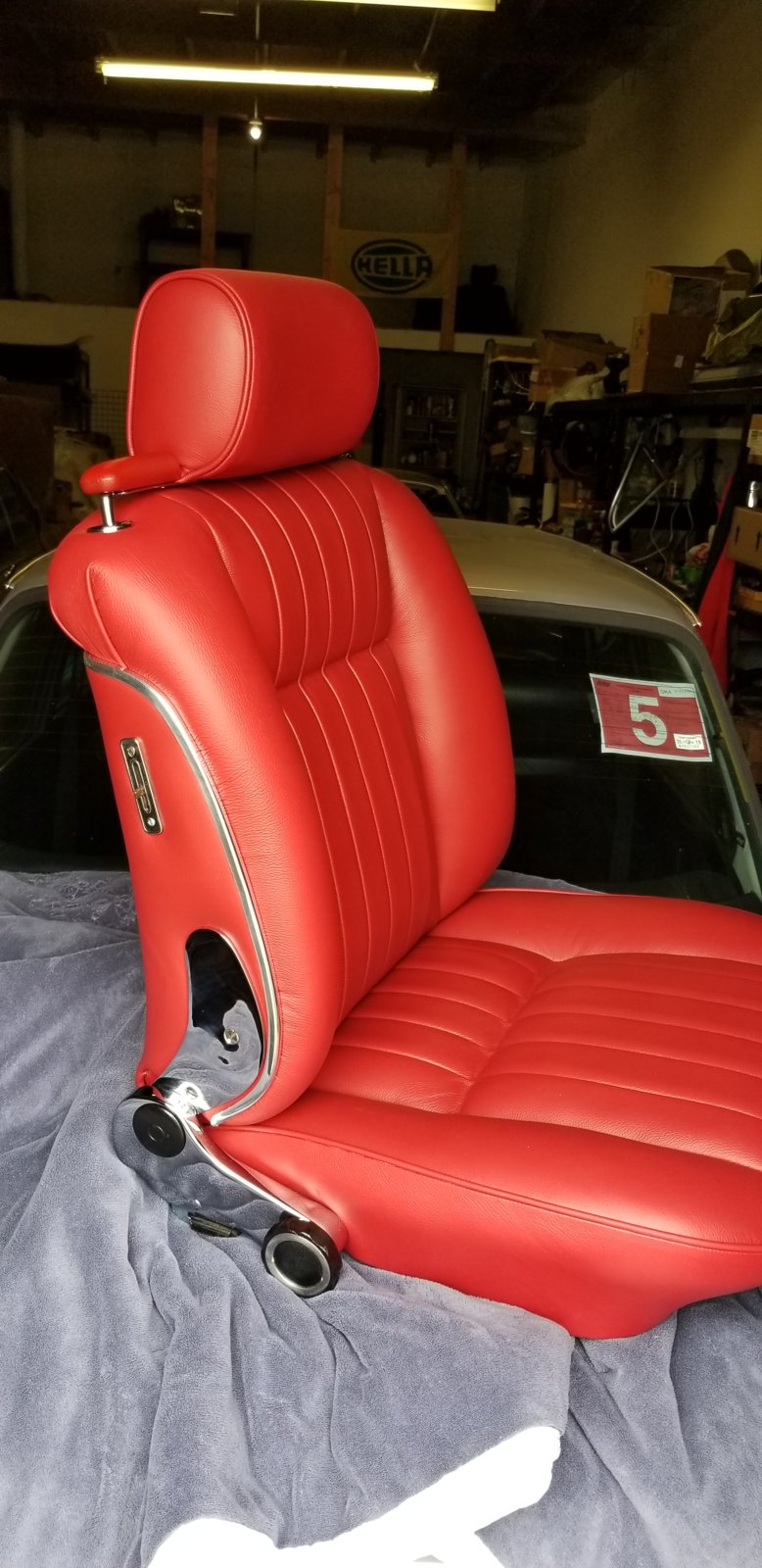

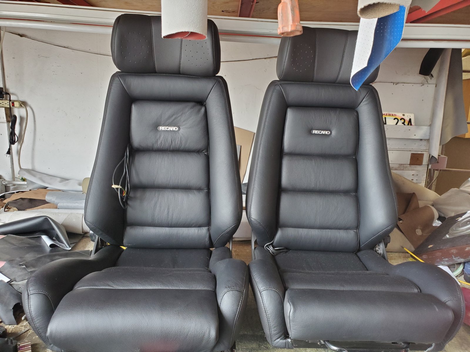

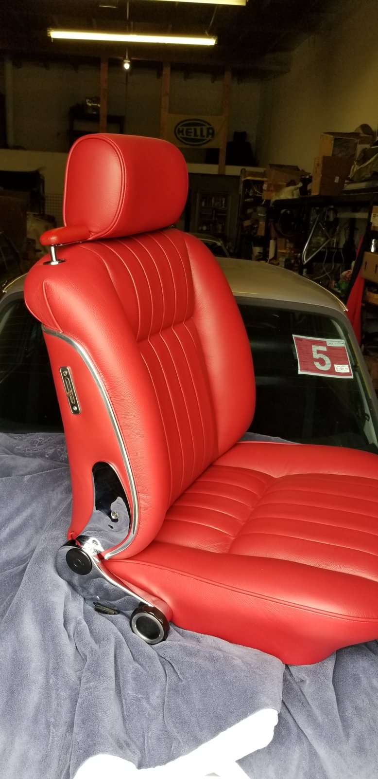

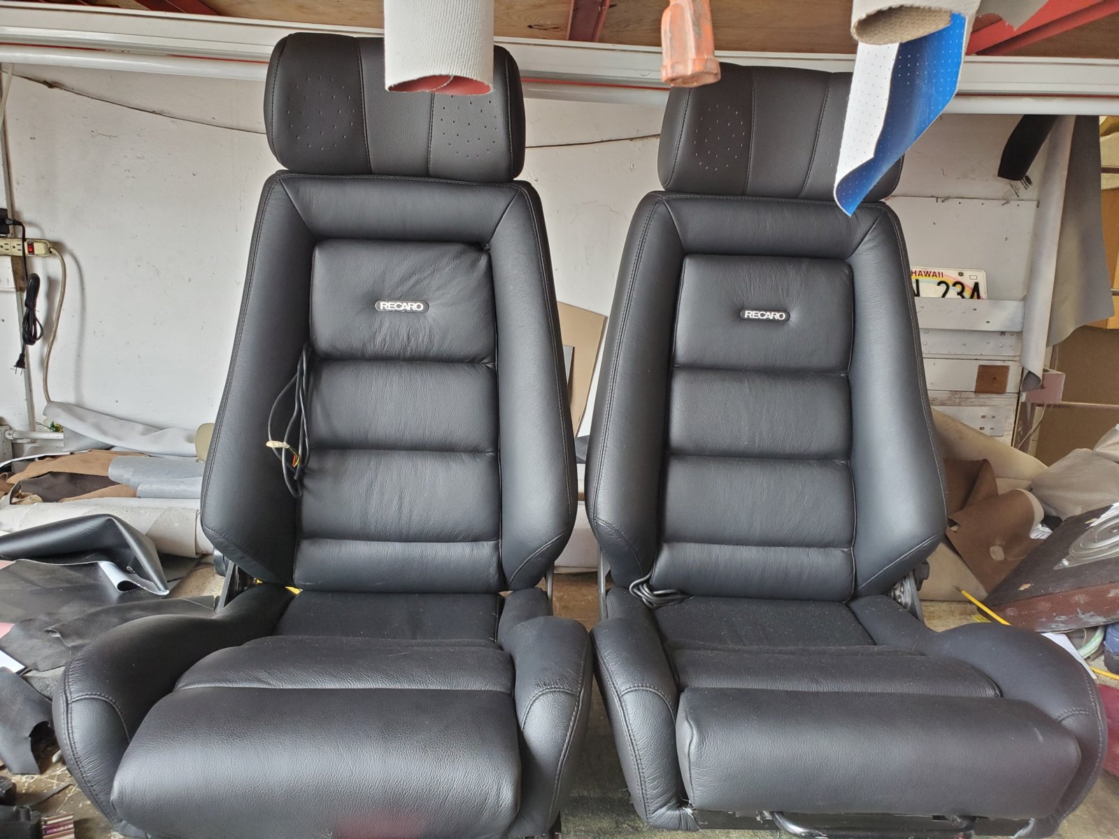

Where are you located? I have a good source here in southern california that get them for me. He is pretty reasonable and the quality is good. Below some seats I have redone for my e9 and my 2002.
