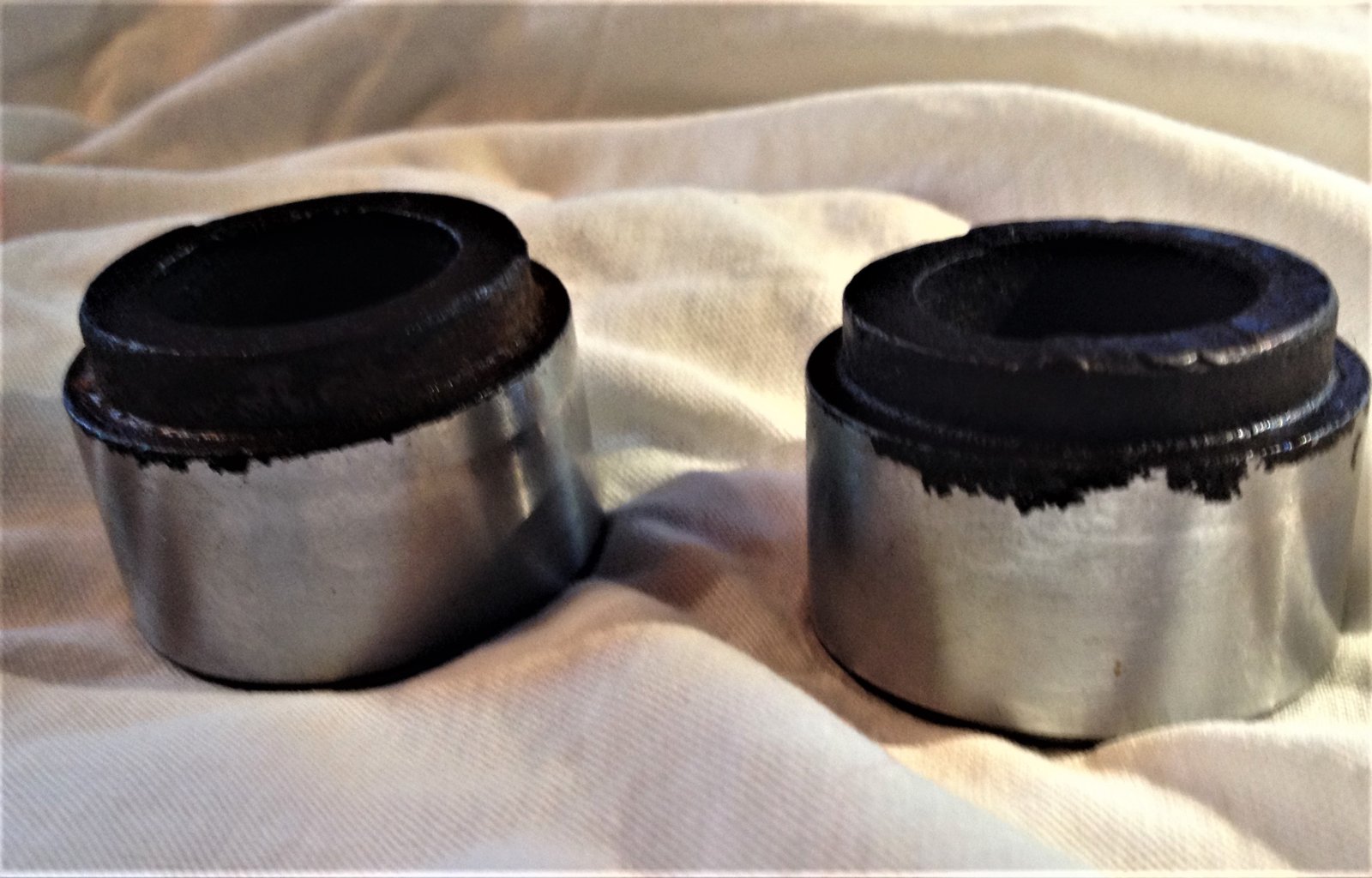

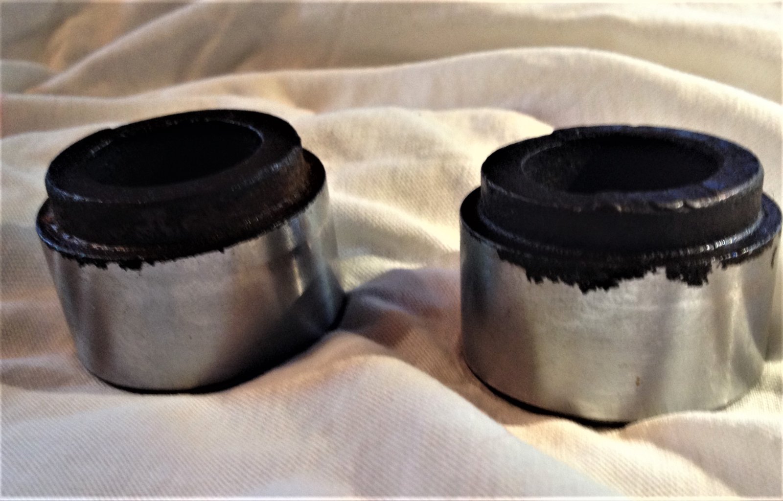

I borrowed a compressor from my neighbor, and finally got the stuck piston out. It's on the right in the pic, which was taken after I cleaned the pistons with light steel wool. Rust can be seen near the top, mostly on the piston at right. I'm hoping that since most of the piston's 'action' occurs further down, where piston meets the inner seal, the rust may not be a problem?

The last time I rebuilt the calipers I bought new pistons from W&N. After 50 years and several rebuilds they were looking a little nasty.

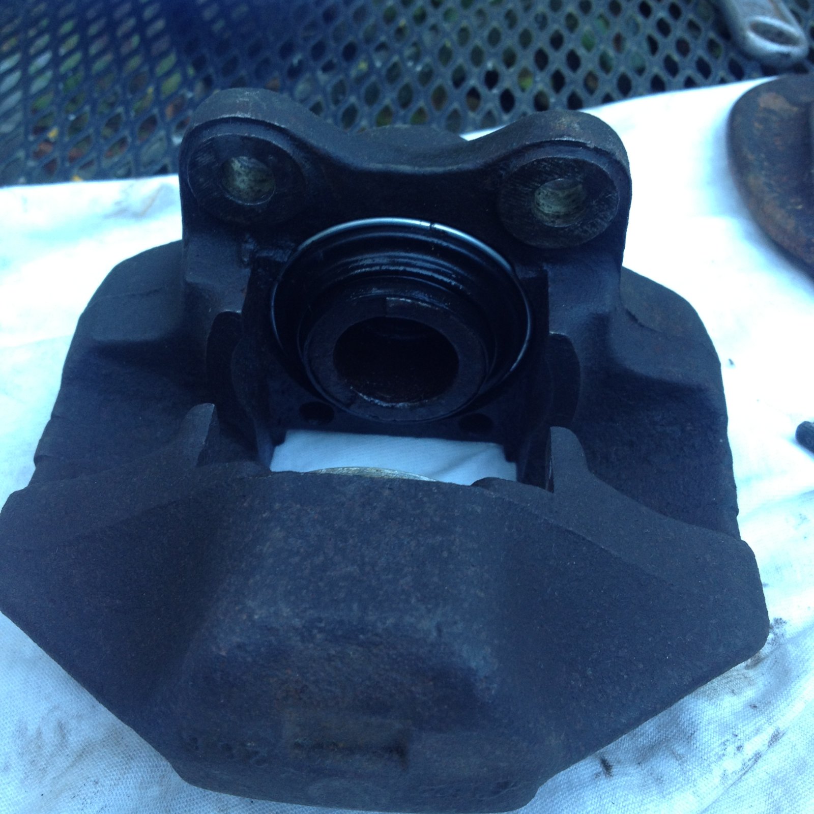

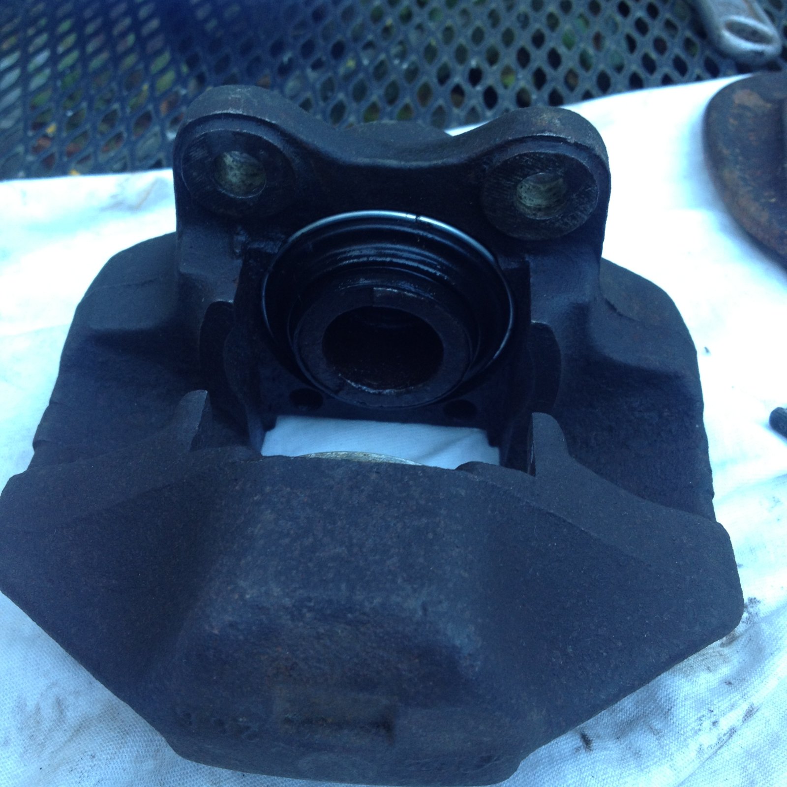

I think the piston is now seated property. It gets easier to seat after it slips past the inner gasket. Many thanks to all who have provided their expert input.

I may have jumped the gun, but had reinstalled everything before reading the above suggestions (for new pistons). After a test drive this morning, the brakes are working normally and the left rear with rebuilt caliper runs cooler.
