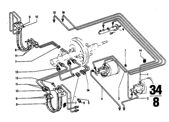

Again, I appreciate your detailed description of the e9 braking system. I have a question: When you say "The first hose you replaced was plugged. I would guess that the remaining 5 may not be in the best of shape," are you saying there are a total of 6 brake hoses on the car?
I know the front brakes have 2 hoses (one per brake), replaced not long ago) and the rears have 2 hoses (both replaced a few days ago).
Where are the other 2 brake hoses you refer to?

The front calipers have two hoses per...

I just looked at mine and you are correct. My 3.0CS' six brake hoses are all fairly recent, so that's done. The RR caliper was replaced with a new one in '94 and now runs cooler with the new hose. The left rear caliper may be original ... it's the one that's overheating the most. I've owned the car since '85 and don't recall replacing it.
