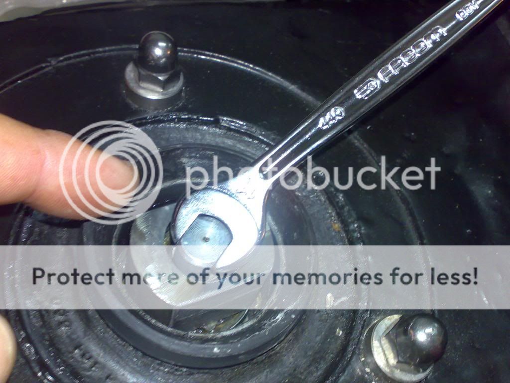

the question that i am facing is how to remove the front shock tower nut, it is something that i will do later, when the whole tower is out from the car, but i am trying to get myself prepared for it
the setup seems to be a little odd, it has the standard springs and bilsteins B6 right now:
the nut is M18, that needs a 27mm tool, but it needs to be undone while blocking the inside shock rod, no way:
i need to have access to the inner part through the 27mm hexagonal vase: i cut a vase and made two parallel faces to hold it with another tool, but it is so profound that i can not hold it
it is not a good way, i am figuring out another way, but, anyone knows how to solve this ?

Before I had power tools I made a special wrench by cutting off the drive end of a six point socket and welding on a handle (long) to the outside of the socket. The open end that you cut off provides easy access to the inner rod.
Now that I have a powerful pneumatic impact gun, its sufficient to apply a light restriction to the shock tube via a strap wrench and 'power ' the big nut off. If I had to pick one, I'd make just the wrench S it also. Eases instAllayion of the new parts.

Be careful with the air impact wrench. I've seen that provoking the rod inside the Bilstein shock absorber come loose! Since more than 10 years I hence always use a open hex with a custom handle welded on to it when doing this (like descibed by bfeng)

good, the external hex is ok, but what do you use for the odd shape of the shock rod ? in my case it is 11mm on the two paralell faces, and diameter 15 on the rod

Here are pictures of the tool I made, I welded an old wrench on top of the 27 mm socket as a grip. You must mill or drill out the top of the 27mm socket to get room for the 11mm socket.
thanks, yes this will be the way to go, but instead of welding, i will probably cut the top of the 27mm socket and then make two parallel faces to use a conventional wrench
