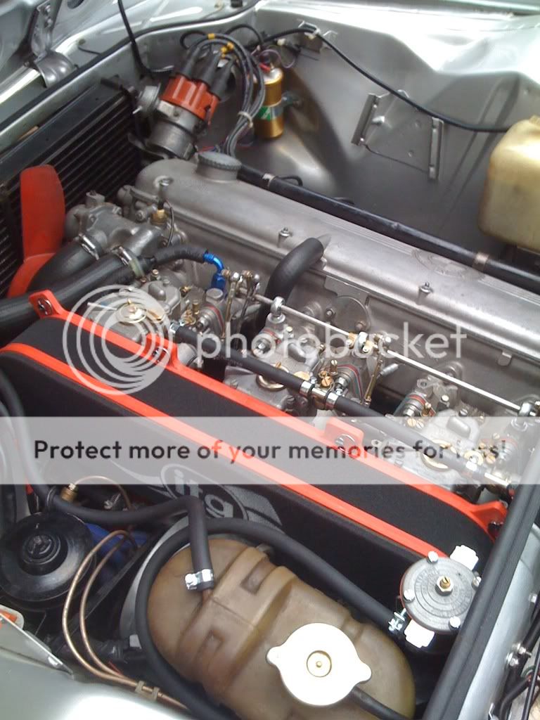

Engine before:
The strut bar is oranger's one from the group buy - lovely bit of engineering.
I have lots more photos, to be fair it was in great shape before as I had the car nut and bolted a few years ago. Bodywise its still like the day it rolled out the original restoration - thank god! This was whole process was brought on by the premature demise of the engine due to a rebuild error where it had spun a shell. I got carried away while waiting for the engine to come back and had everything under the bonnet rebuilt/replaced or powder coated. I learned so much last time it was easy to go to the right places to get what i needed done. I'm especially glad I went for the CR 5 speed, it really livens up the driving experience. The rebuild of the box makes the shift rifle bolt accurate in combination with the uuc short shift.
