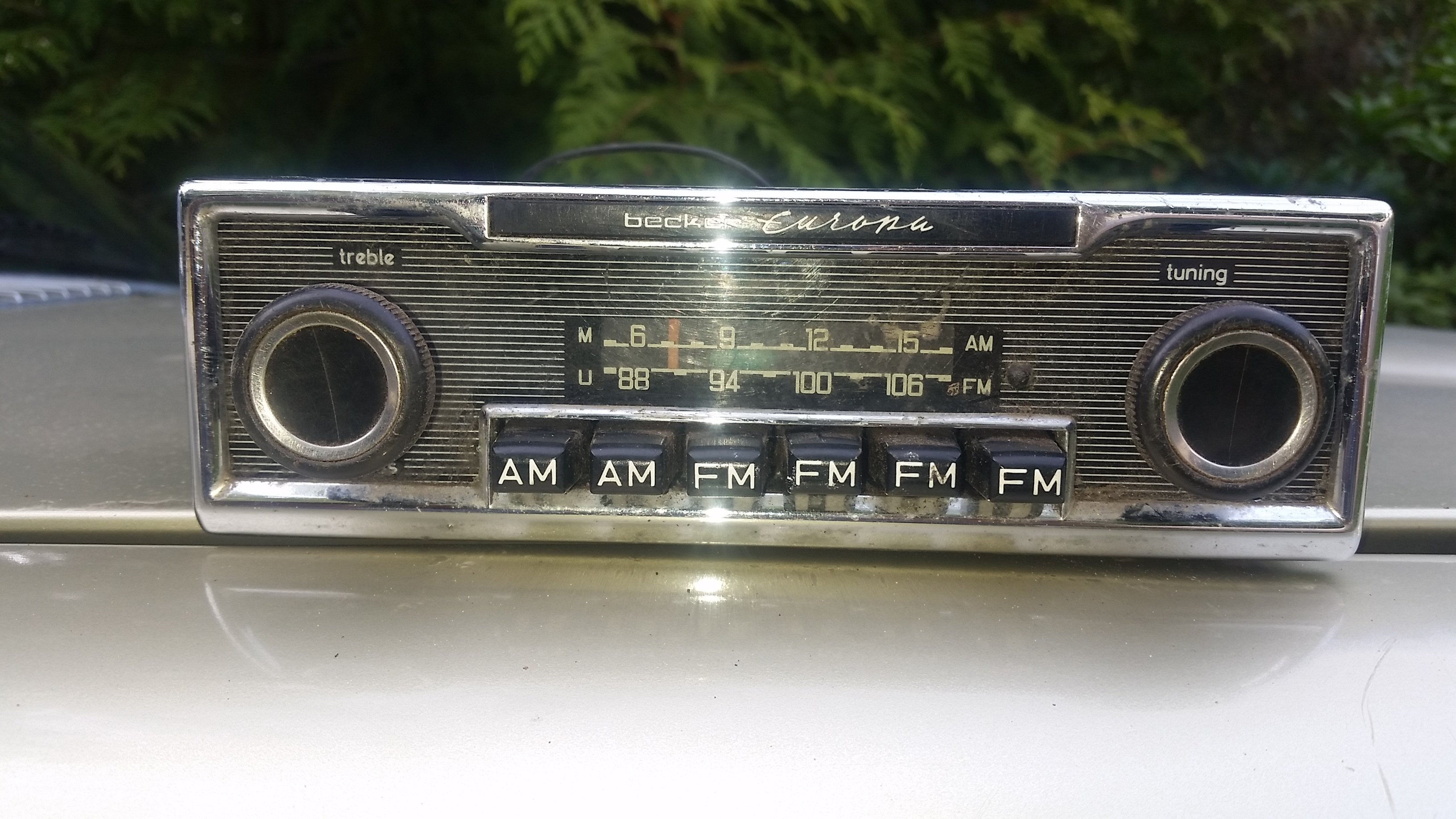

Here's a shot of the radio I got from Becker Autosound. It does look a little too "electronic" for purists but it dows have a removable face plate with a CD slot behind it, USB port, and plug for the XM. Also two output ports for 4-8 speakers and a pretty good amp (40W?). $600 drive out I believe. And no, it doesn't really fit right, I think it's a shade too long. But I really like the modern functions with the original knobs.

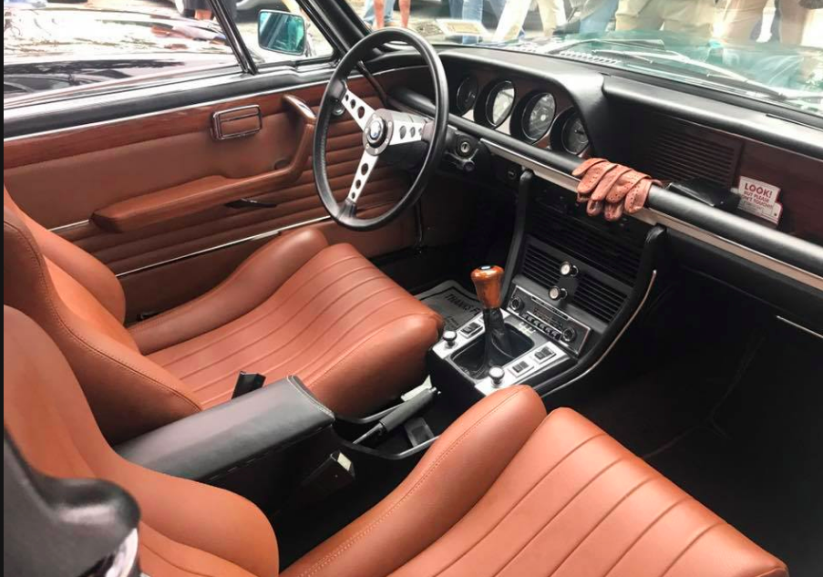

Is the zipper in your shift boot facing the dash?
Yes, is it in backwards? Whoops! Lame excuse: I didn't put it in, I had another guy do it while he was doing some other stuff.
And, according to the instructions, it is a single DIN rectangular hole. It appears to have some sort of mounting sleeve such that I can pull the radio out but leave the mounting sleeve. Ever heard of that?

Has anyone installed this Becker? I notice it has 6 pushbutton, wonder if there is room in the faceplate for this.

That faceplate requires a full DIN cutout (7"x2").
To FIT an AC plate, you need the Europa that has the non-DIN faceplate (they are interchangeable).
See this:
