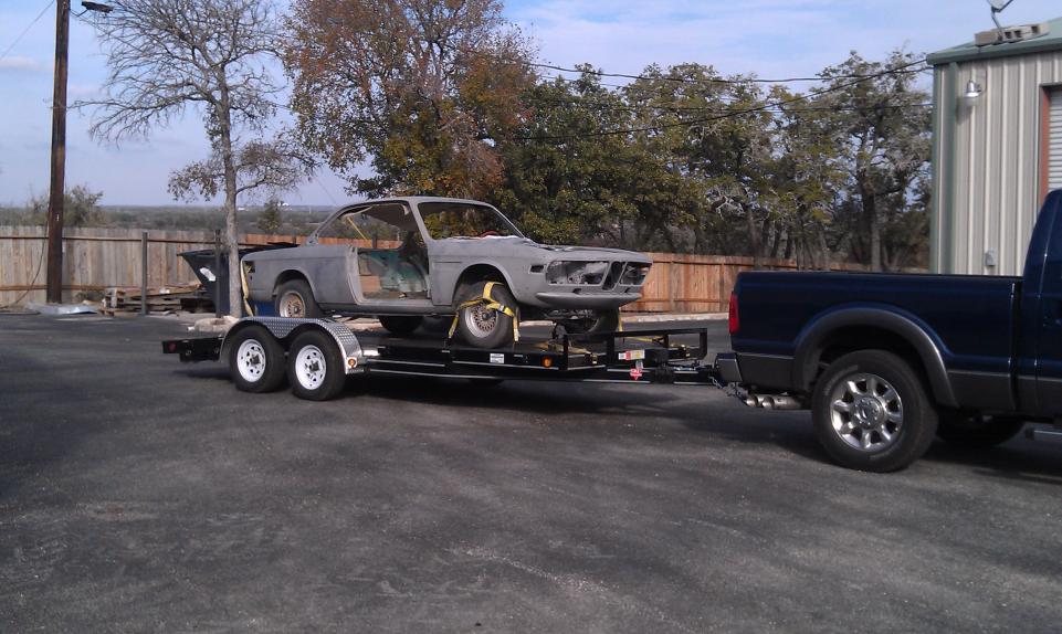

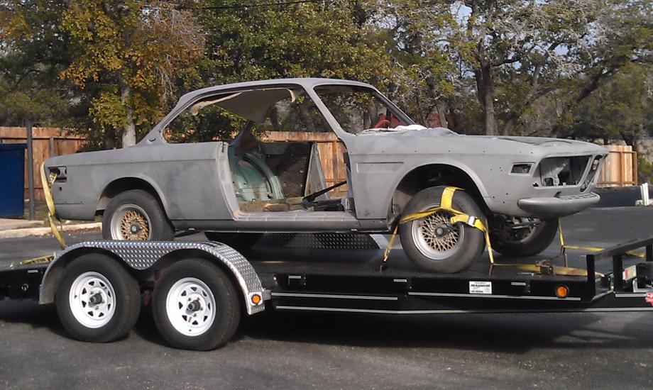

Just got her back from the blasters - She had a couple of dents (drill holes) but no rust. here are some pics.-comments welcome! Tim, I start examining the parts tomorrow so we'll see what works in my little world.
