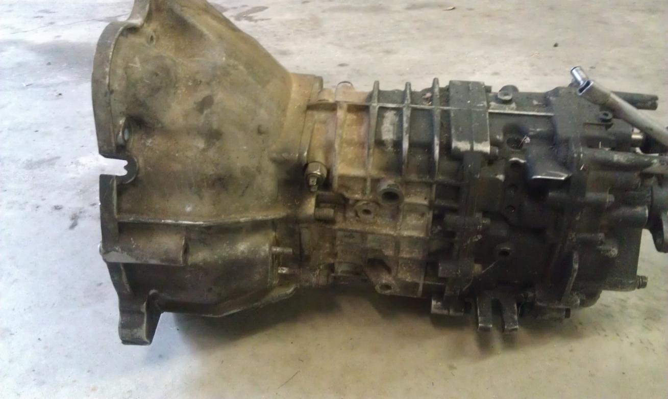

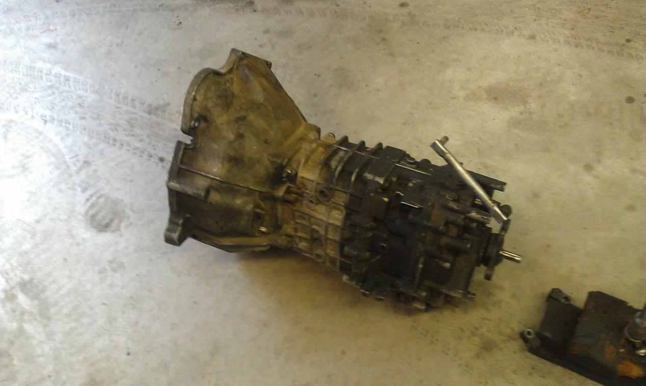

Play in Transmission input shaft
Hi - Hoping to get some advice on my donor transmission; I have a Getrag 265 5 speed and it shifted very smoothly and quietly when it was in the 1980 633 CSI through all gears forward and reverse. When I got the trans out, and was inspecting it I noticed that there seems to be allot of play or wobble in the input shaft and I was wondering how much play is normal. Also if there is a recommendation for any routine maintenance or "freshening up" that should be done I would appreciate it.
I also includes some pics of the trans and donor engine in case anyone has any comments or suggestions. Thanks
