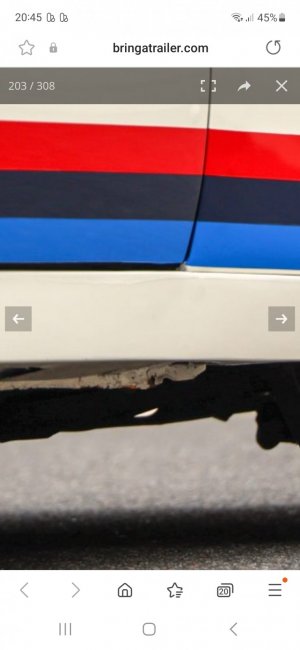

”Interesting” location of the front pads on the lift! It’s either got very strong floors or very dented ones?!
It's the last: very dented, and disappointing, but I'll use this image in my diy thread "how to lift your coupe" .
See the fold in the floor, just right side of the jack pad.
Hey, we all learn something thanks to him. I always *thought* the floor couldn't support such loads. Now I *know*.

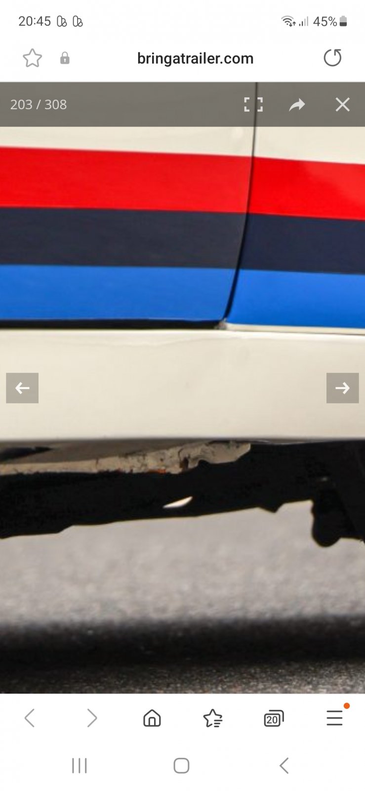

eriknetherlands
2,789
2,028
Netherlands, Eindhoven area
The sill seam at the right front also looks a little suspicious; It ( the white curve below the car) is supposed to be a nice gradual curve going up into the A - pillar, not this jagged shape.
