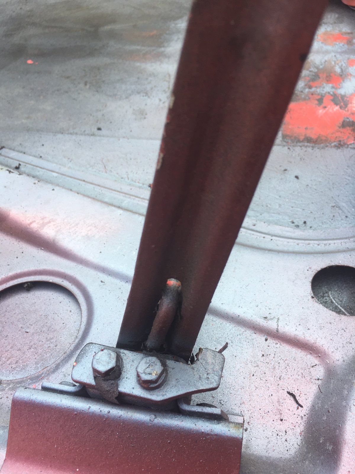

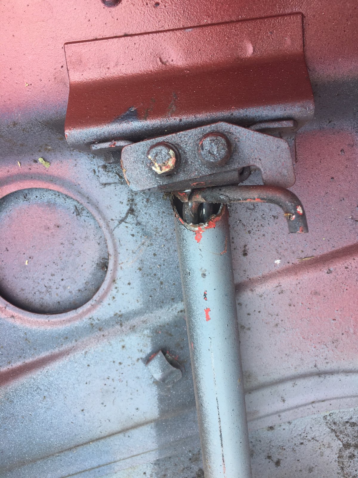

I hope these pictures help you do what I couldn't accomplish.
They were taken before I disassembled the broken hood torsion bar to weld the broken "rod end" (my terminology).
I couldn't figure out how to piece it back together, so now the whole assembly sits in my garage, replaced by a custom 2 x 4.

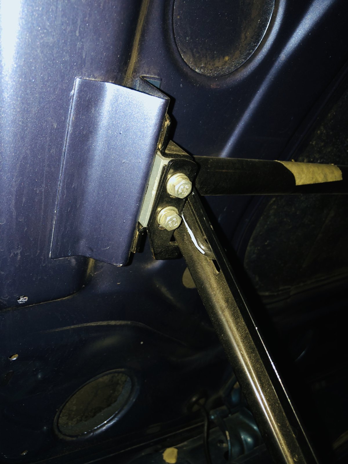

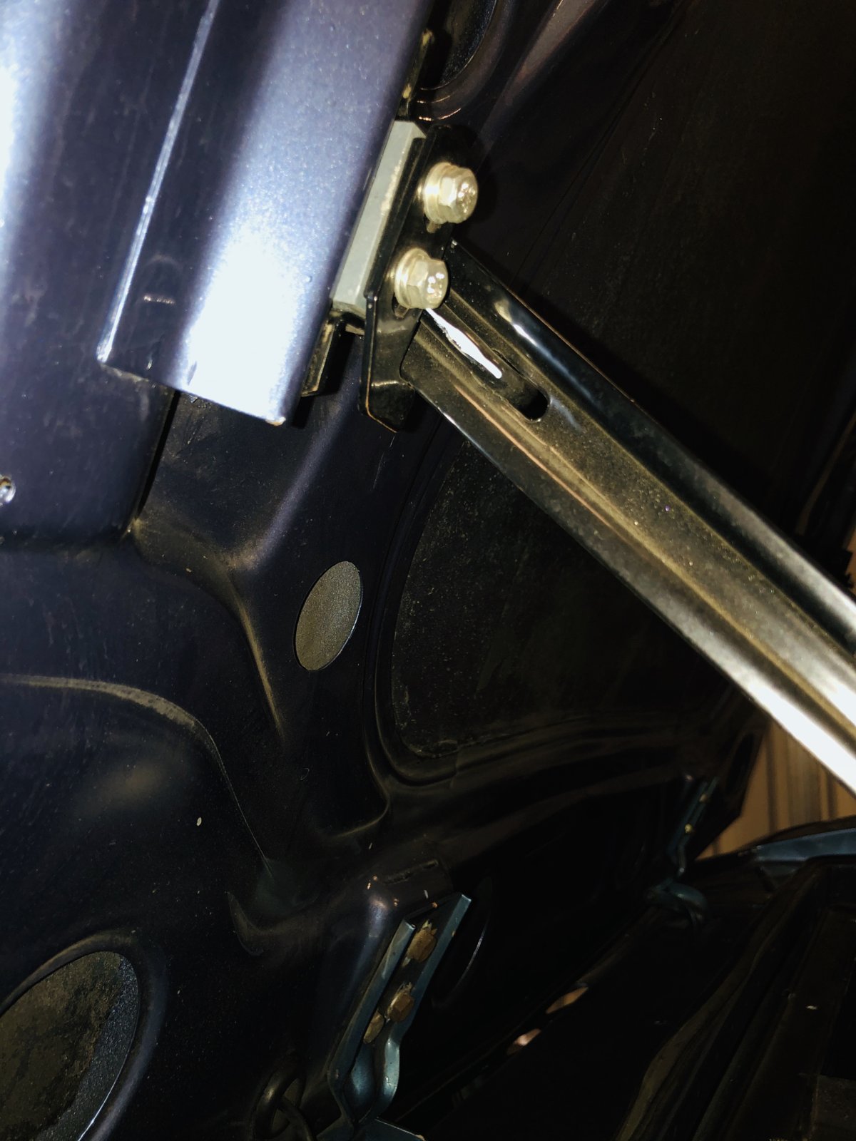

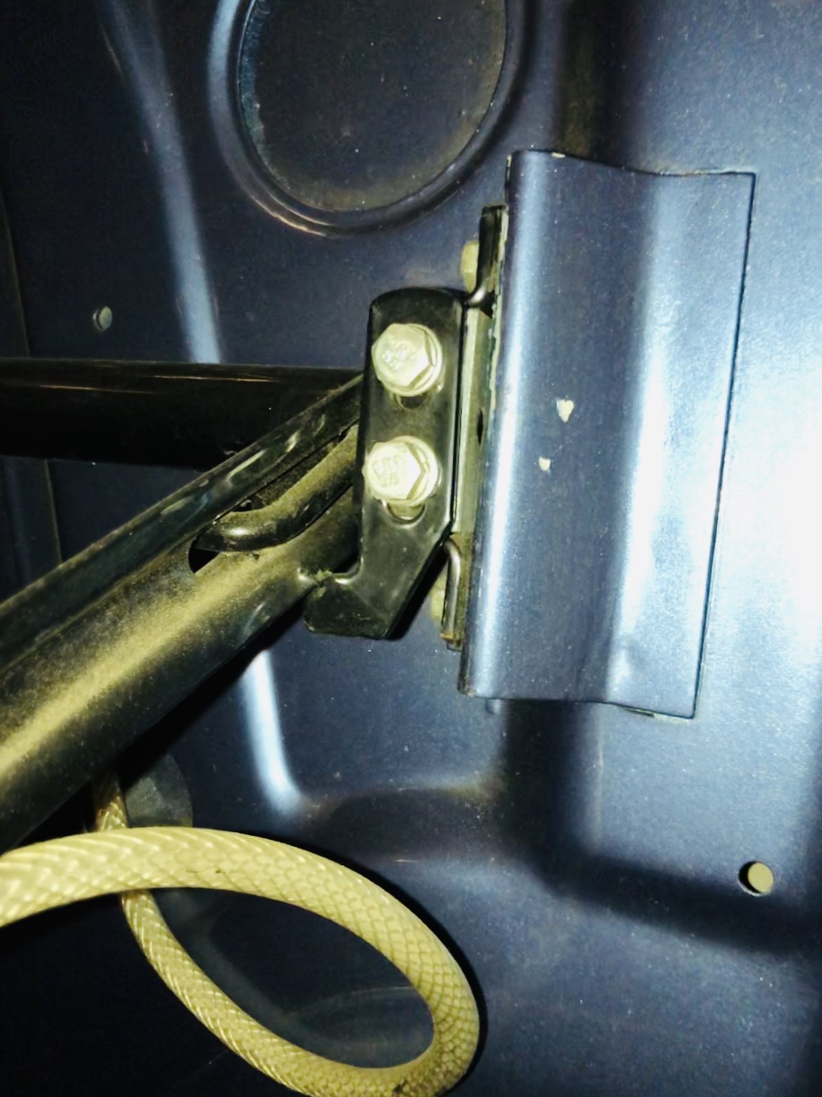

I hope the pics helps. I believe the side u r holding is for right side of hood. Pics 1, 4 , n 5 are left side n 2 n 3 are right side.

I got it, built in stop. My E3 has no such thing....or it was removed over the 45 years of its life.
