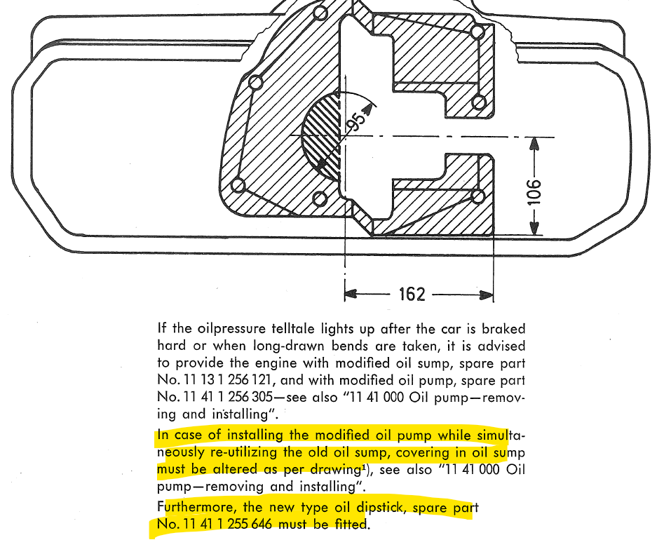

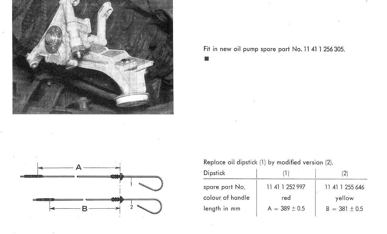

when replacing the oil pump with a new one i found a curious page in the mentioned booK
so does this mean that if you fit a new oil pump, you must replace the red handle dipstick with the yellow one ?
and what is more important, does this mean that you should increase your oil level in 8mm ? so you have to use a higher oil level ?
i always keep my oil level in the middle between the marks
but i have a new oil pump, and i still have my old red dipstick
i can make a mark just 8mm higher, that would not be a problem, but should i ?
should i increase my oil level in 8mm ?

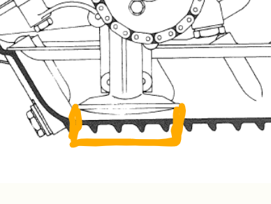

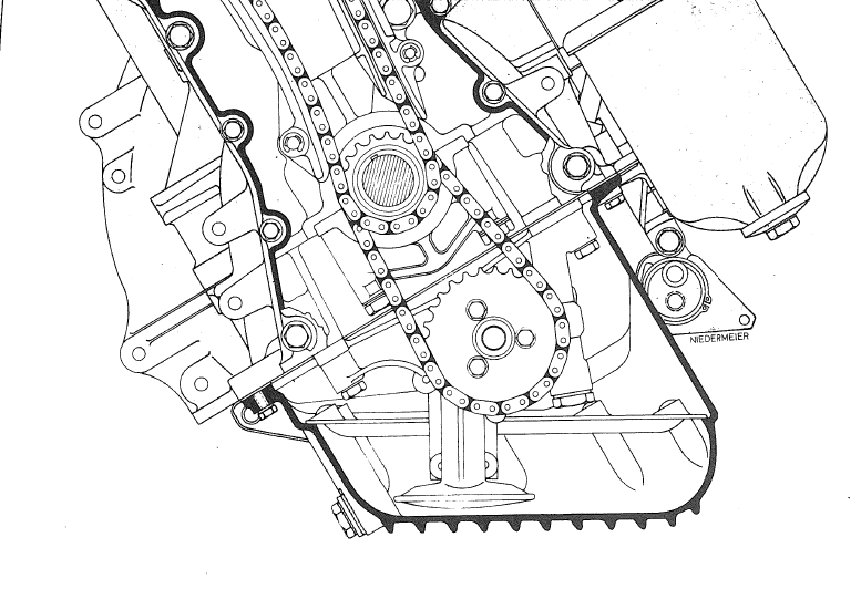

the old version is this one:

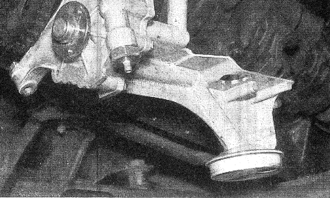

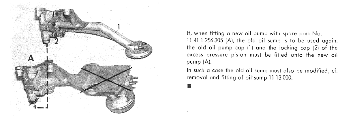

new version has extra depth, and the carter is not valid (the case you can see in the next pic hits the bottom of the carter)
i can not understand this notice:

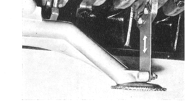

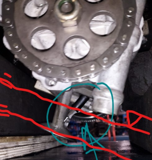

this is my case:
and you can see the original RED dipstickhere how it looks like
a detail:

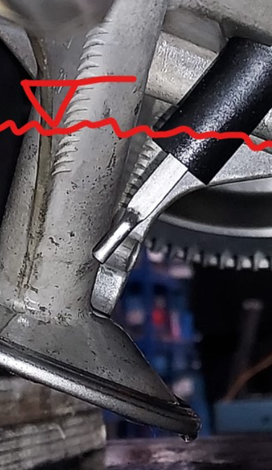

is this a correct oil level
why should i increase 8mm of oil ?

Older cars had no baffles in the oil pan causing oil starvation when turning, I found this in our 2800. All cars afterwards had the modified pump if I read this correctly.
