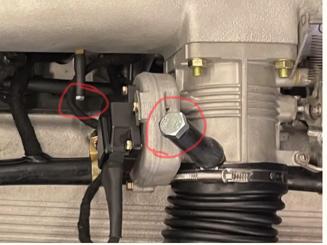

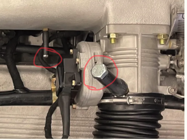

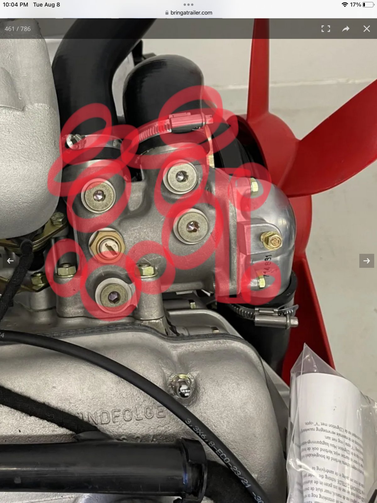

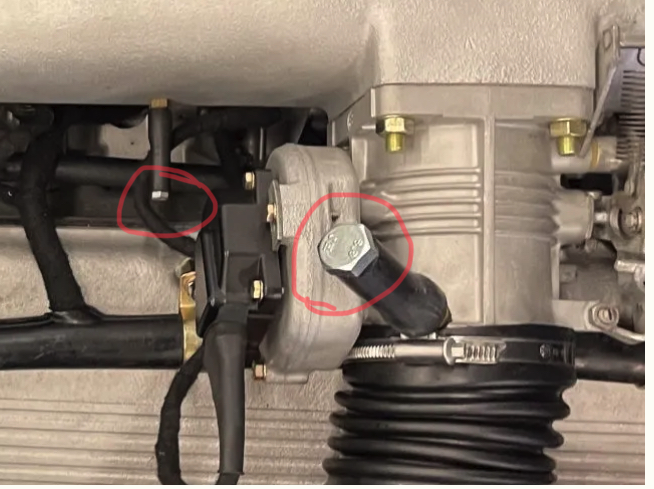

some of this car is so good and some is so hard to look at. Was this a test to see how much you could do wrong per square inch?
Ooh I like this game: So the thermostat housing should be replaced with the proper part not requiring pipe plugs. The nuts should have lock washers? Hose clamps too short? Oriented the wrong way?
OCCoupe
1,943
1,299
Monterey, California
It's not that much more effort to do things correctly, especially when you are trying to achieve a high sale price. Putting a bolt on a vacuum line to block a port is not a proper solution. Put a vacuum cap on it.

For my education, what would be the reason for installing these 2 blank rubber hoses ?

The seller has posted photos of those being fixed (different thermostat housing and throttle body). Looks like they pay attention to the criticism by experts so that bodes well.
I was curious what would have required that modification to the throttle body with such a large tube to begin with.
