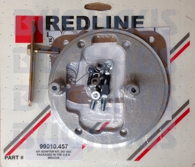

A little searching on ebay located the adapter Dick wants, distributed by Redline:
Unfortunately, I only saw it as a part of a complete conversion kit and didn't see just the adapter available separately on the Redline site - suggest you contact Redline.

The one you linked to in the kit is the one I'm looking for. I do not see Redline offering it separately, however. I'll email them.

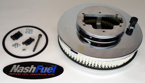

I'm reviving this older thread to ask if anyone has tried the adapters discussed above: the Redline 99010.457 or LCE Performance 1033-030. Yes JAM also makes an adapter, but as we discussed earlier, these shift the e3/e9 air cleaner rearward, creating some clearance issues. The specs for the Redline and LCE adapters say they are for air cleaners with a 5-1/8" id opening, while the BMW cleaner has a 5-1/4 id hole. Perhaps that small difference doesn't create a problem, but before ordering one or the other I thought I would ask if anyone had tried them.
Here are the links to these two Weber 32/36 to stock air filter adapters:
https://www.lceperformance.com/Weber-32-36-38-Carb-to-K-N-Filter-Adapter-Kit-p/1033030.htm
https://www.ebay.com/i/201399708243...YBbufUOdS0eaZ6GgGq4VseRo2xpaUcZAaAqUXEALw_wcB
