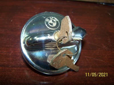

getbmwparts.com shows the 3.0cs gas cap for 14.50
quick word to the wise, i believe that the gas cap is different for the 2800cs and the 3.0cs. if i'm not mistaken, one is vented and the other is not. i don't remember which is for which. i just looked it up on realoem and it shows the same for both.
if you want a lockable cap, its available ... but 100 bucks

The $14 one is plastic. All coupes use a non-vented cap, Ohne Luftung. Before the vapor canister and in Europe they vented with a pipe below the rear bumper.

Thanks everyone for this thread
Just tried a used gas cap from my 97 318ti
Nice and snug on the coupe, going to get the car painted and wanted to remove my shiny locking gas cap
and avoid having the shop deal with a key
