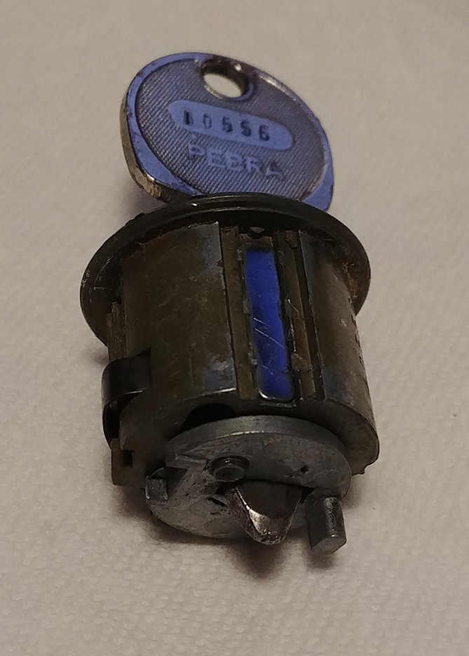

I took the family to a BMW meet in Nevada this weekend in the 3.0cs. During the trip, the ignition became harder and harder to turn. The last time I started the car to return home, I had to turn the key with pliers to get the car to start. I removed the entire ignition lock cylinder tonight and separated the tumbler. I can easily rotate the assembly in the larger cylinder, but the key/tumbler is stuck. I've tried dry graphite lubricant and WD40 to no avail. Looking for a replacement tumbler with matching key (my car has always had a different key for the ignition than for the doors/trunk anyway). This is, of course, the PEBRA dimple key. Thanks ahead!

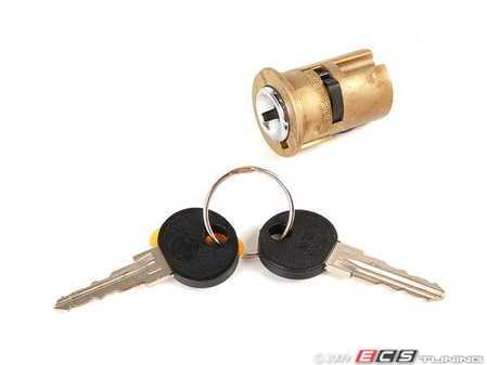

Ignition Cylinder Lock
Steering wheel ignition cylinder with keys
Mfg Part #
32321108976
32-32-1-108-976
32 32 1 108 976
ECS Part #
ES#53422
Brand
53.34
$60.03 (11% Off MSRP)
Free Shipping

Not necessarily, but I forgot to mention that it does have to fit a European delivery car (Mine was originally delivered in Italy). This site suggests that maybe some ignition parts are not exchangeable between US and Euro cars:
http://www.delockandkey.com/bmwdippage.htm
Looking at images of the part number you gave, it looks like the tumbler is too long to fit in my ignition assembly. Which is probably what is meant by the "short" Euro ignition vs the not-short US version.

Our Pick: Brand New
Ignition Lock Housing MTC 1101
$39.99
Free Shipping
