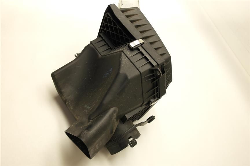

heres the modified air box.
first i cut off the bottom to make more shallow as it was too high.
then i cut out the inlet pipe and relocated to the back face, as it was too far forward.
then i cut off the diagonal corner as it was just unneeded mounting
then cut off the L portion of the air filter itself. as it was too long and was in the way of the
radiator hose.
so i will get a new air filter and just square it up to sit in the box.
all the joints are rock solid
i can get you the dimensions of the air box you need -then you could make one
i can make a cad file.

heres more clearer pics of the size and scope of work
now it sits back far enuff to clear the radiator hose
and align with the front outlet tube of the air box
as it exits at the front
