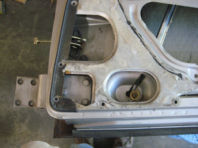

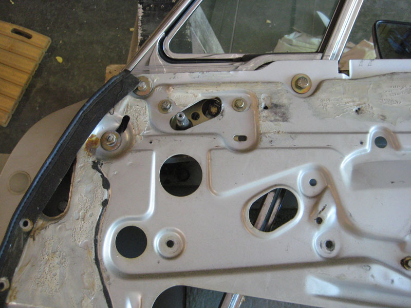

There are two bolts near the front top of the door panel, accessed from inside that secure the triangle assembly. There is also a bolt a bit down along the front edge (in a long slot). And one bolt at the bottom to remove. Note the bolt's positions before removing. In addition to holding the assembly in place they also provide fore/aft and side/side adjustment.
IIRC, I think the vent window turning mechanism can remain attached to the door. You will need to unbolt it from the spindle at the bottom of the turning triangle window. You may have to loosen the bolts holding it to the door framing for some maneuvering room.
