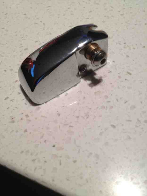

My cast blocks (the bit that goes onto the splined shaft) were in a really bad way, so I carefully removed the spring clip and have had the block re chromed, I have bought a M3mm tap and 2 tiny M3 x 4 cap screws that I plan to re attach the spring clips with (i have re bent these into shape so they grip the shaft better), theres not a lot of material to screw into in the block so I will have to be very very carfull, one little slip and I will poke the drill out the top of the freshly chromed block!!
You will notice the big hole, this is where I drilled out the pivot hole for the wiper arm as it was very worn and sloppy, drilled out for new brass insert
So when all assembled you will see the SS dome head screws, these hold the arm on
And the clip inside that holds arm onto spindle, this is held in place with a M3 x 4 SS cap screw
And clip screwed in place
Should all work well... I hope?

Impressive, my satin ones don't look that thick? I could not pull off that tapping job so I'll just hope my epoxy holds - so far so good.

I tapped mine and used a small machine screw. You are right there is not much meat to tap into. It has held so far.
