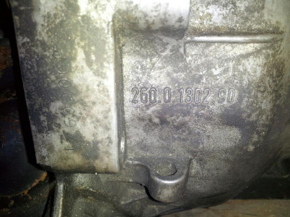

Will this Getrag 265 be a good swap candidate for my early M30?
Kev
10
0
One of my buddies has a spare 265 he received along with his 87 535is. I've read up on the 5 speed swap process and learned the 85 535is 5 speed compatible. I've attached the serial number on the gearbox. Will it swap? Should i buy it? How much do these typically go for?

Thanks, Peter. I appreciate the advice, I'll have to take you up on it. :)
I looked at the transmission in person today and found that it was actually a Getrag 260, not a 265. It turns out my friends' E28 is a bastard machine with a hodgepodge of parts from various E28s. It wasn't a three-piece, and it lacked the speedo drive on the bottom right side of the tailshaft housing.
My search goes on. By the way, were the OEM manual 4 speed 3.0 cars equipped with Getrag or ZF gearboxes?
