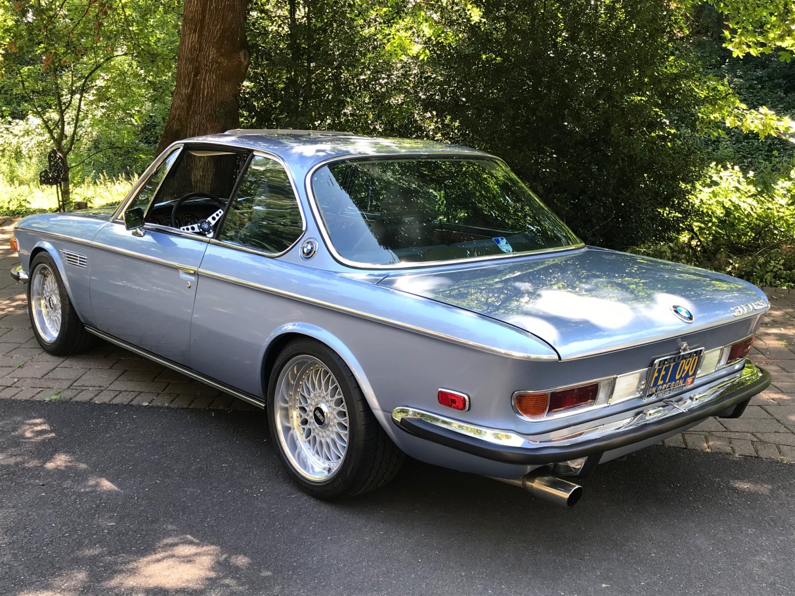

take a look at the FAQ - wheels + tires - sizes / options. there is a link in my signature below. if you want an affordable bigger wheel - look at some of the 17" wheels like the style 5 (BBS RC 090), style 42 or the more affordable style 32. pic of the bbs RC 090 below. there are also some newer wheels that might float your boat.

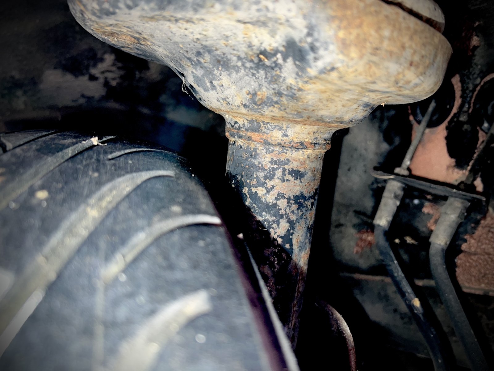

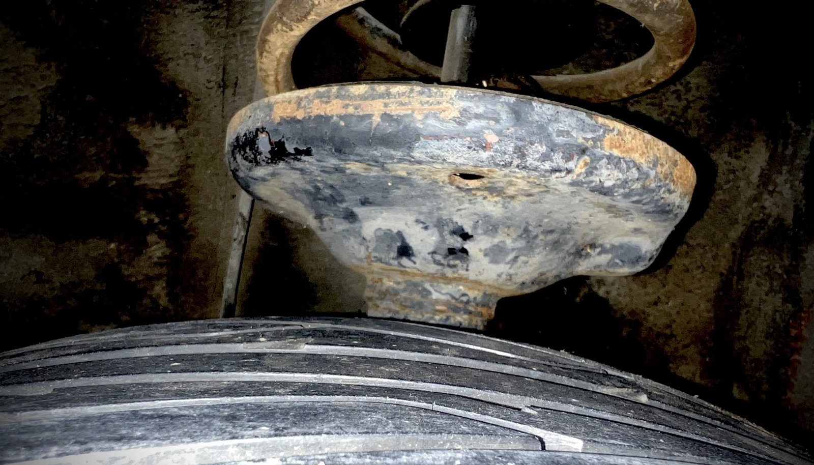

I don’t know what you might gain or lose(?) with coilovers. The coilover kits I’ve seen for E9/E3s use modified stock strut tubes. On the stock struts, the lower spring perch and hub/wheel/tire are in fixed positions relative to each other. There’s plenty of vertical clearance between them. So, unless you’re going to donk it, that’s not the issue with wider wheels and tires.
Forgive the rust and dust:
