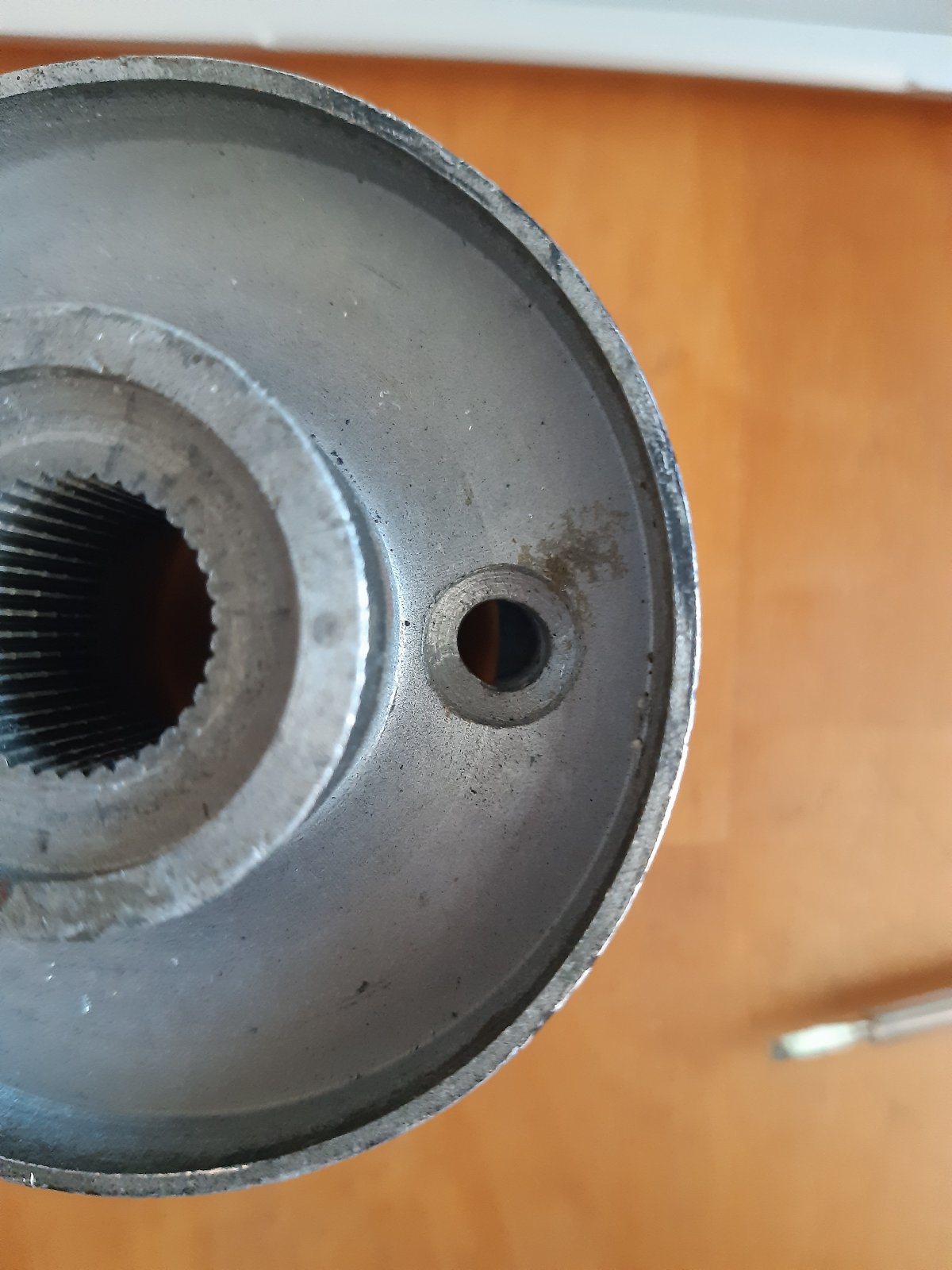

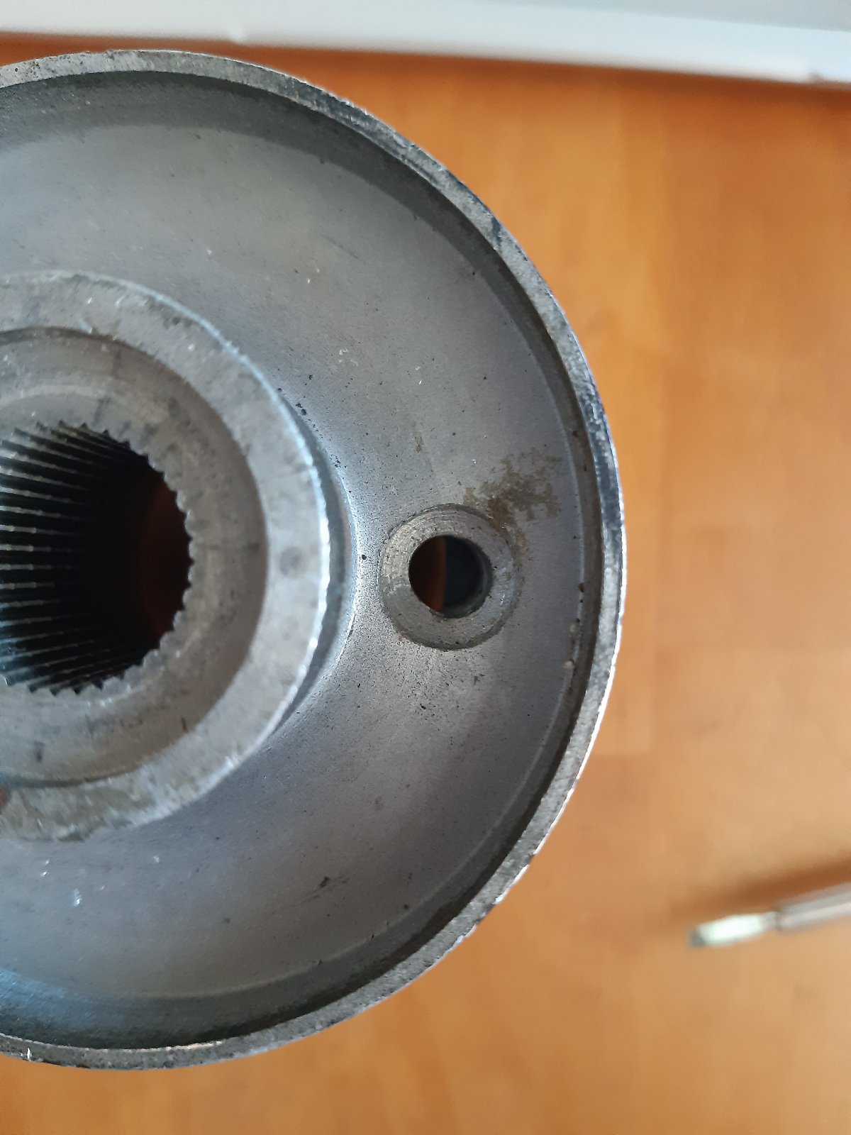

Here comes a pic, that shows the hole for the wire in a 153 hub. It is a bit smaller in diameter than in the 152, so the original 152's horn pin doesn't fit without some rework. There is also no rectangular plane around the hole like in the 152.
The other dimensions of the 152 and 153 I have here, are the same.
Best René

Thanks @Renni! I think that helps to clear things up.
