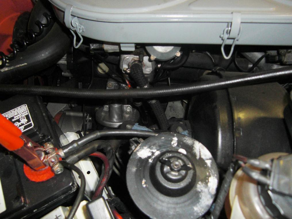

My 72 CS brakes real hard. I took it to two different shops and they could not solve the problem. SFDon came over to see my car and spotted the problem in 10 seconds. He called my attention to the vacuum boost hose that was almost kinked closed at the top.
I assumed it was easy fix to get the correct hose and install. But I am not sure of the correct routing.
I am including some pix of the hose. Thanks

Should not be kinked like that, it comes straight out and curves in a loop nearer the booster. There is a clip to hold the hose on the inside master cylinder attaching nut. Looking at booster, hose starts at 12:00 and goes counterclockwise to 9:00 (clip), 6:00 and stops at 3:00.

Turns out the hose was too short. Just ordered 1 meter of new hose and with new routing which should solve the braking problem. Thanks

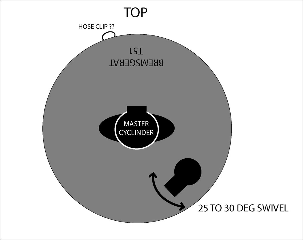

Booster drawing
Just installed the now reinforced hose (Belmetric). But I could not perform the routing you suggested. Do you think my booster was installed upside down (see drawing)?

your booster is not upside down, butthe plastic connection tube is
i mean it is a black plastic tube, and it is fixed by introducing and turning it until a "clack" sound is produced
but you can fix it in three different positions
the one that ends facong up is the roght one
i men your hose then will come up vertical and you can do the routing with the correct rigid hose
is it clear ? i am afraif i can not post pics now to explain this better
I can move the tube about 35 degrees to the left or right (until it stops). I have been reluctant to force it for fear of breaking it. Should I put an open end wrench on the base and turn it until it faces up? It will not break????

No, pls. don't force the hose fitting on the booster. Leave the hose extra long, create a loop about the size of your fist, then get the end near the manifold before final trimming to length. That's what I did only because I like things out of the way.

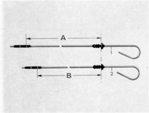

2 Length DipSticks
Turns out there are 2 dip sticks. Red (mine) and yellow.
The way I am reading this is that if you change the oil pump you have to use a shorter dipstick. My engine was rebuilt and I would not be surprised if the mechanic change the oil pump (and not the dipstick)
Here are the manual pages. What do you think??
do not force it!
when you move anticlockwise until a stop then you can pull it out on that position
do that and then insert in the next position, and then turn it clockwise to fix it
you can start it in three different positions, probably you will understand tgis when you pull it out
regards
jmackro
2,463
728
San Juan Capistrano, Ca.
do not force it! when you move anticlockwise until a stop then you can pull it out on that position do that and then insert in the next position, and then turn it clockwise to fix it you can start it in three different positions, probably you will understand tgis when you pull it out
That's right. This is what is commonly referred to as a "bayonette fitting" - it works like a gas cap. It is NOT a tapered thread fitting - that is you can't just apply more torque to get it to move a little more clockwise.
