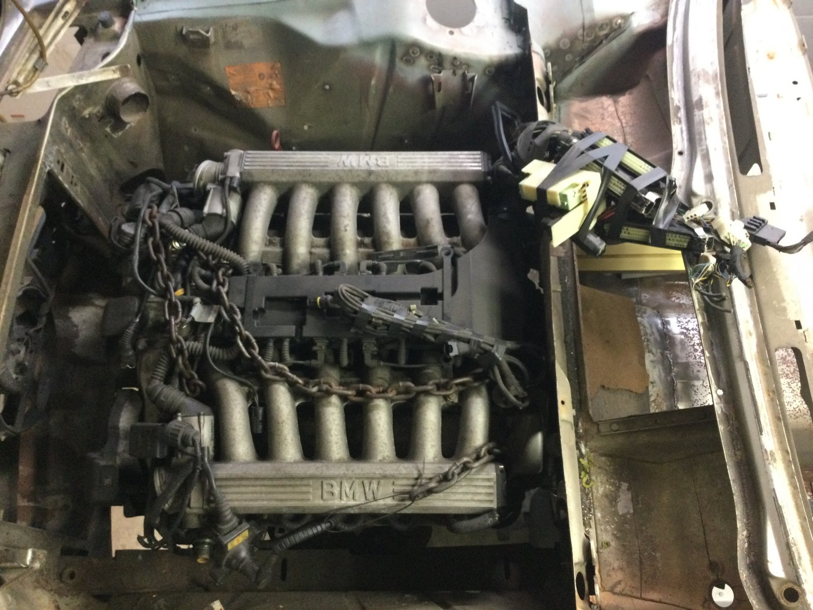

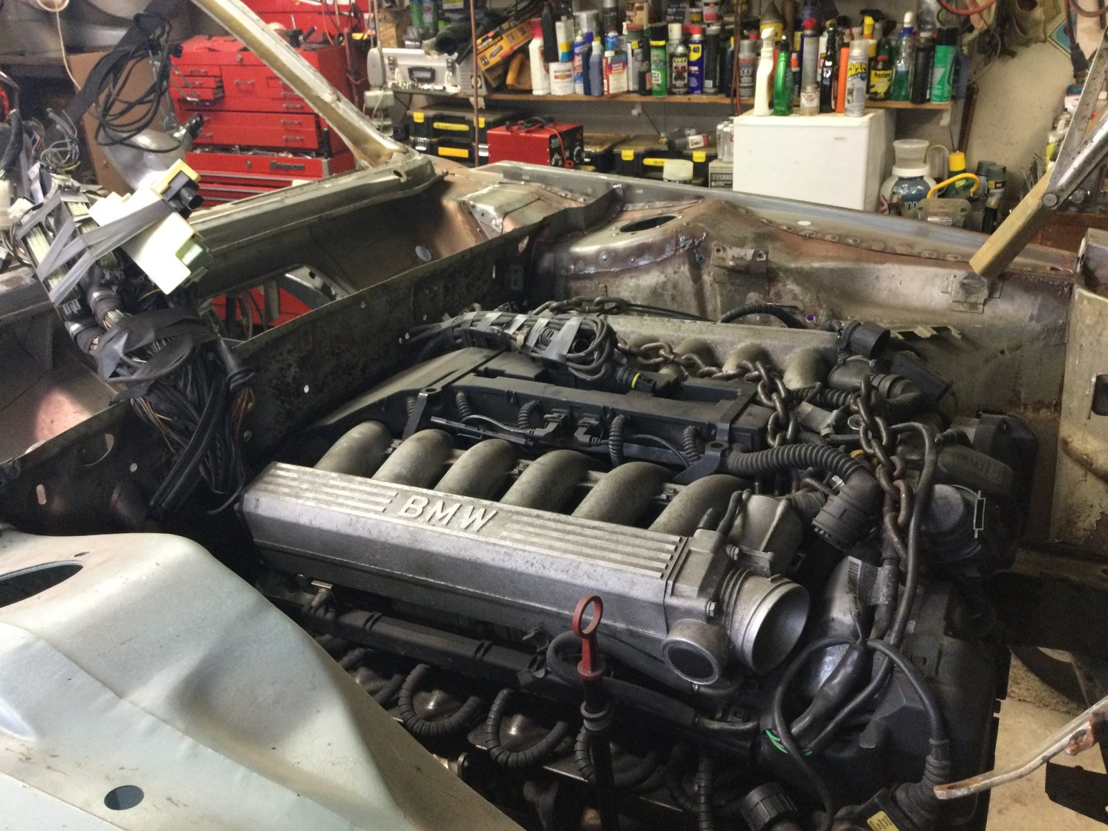

This is what it looks like

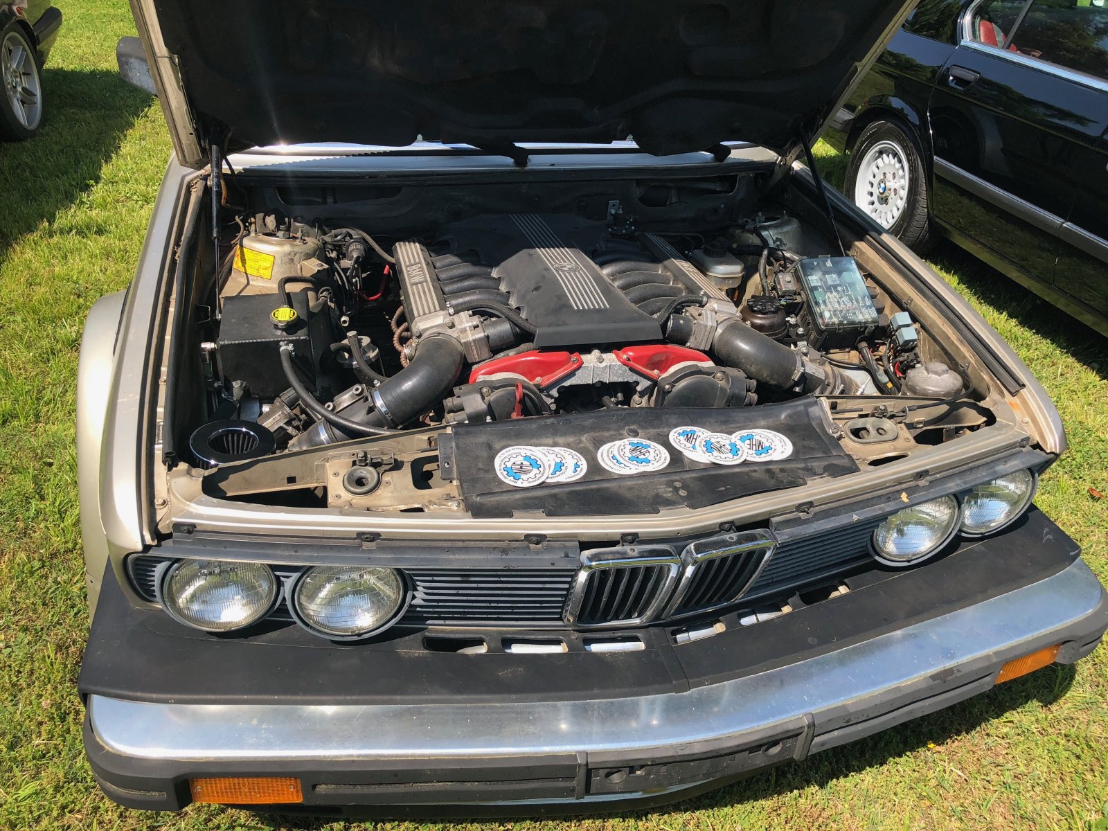

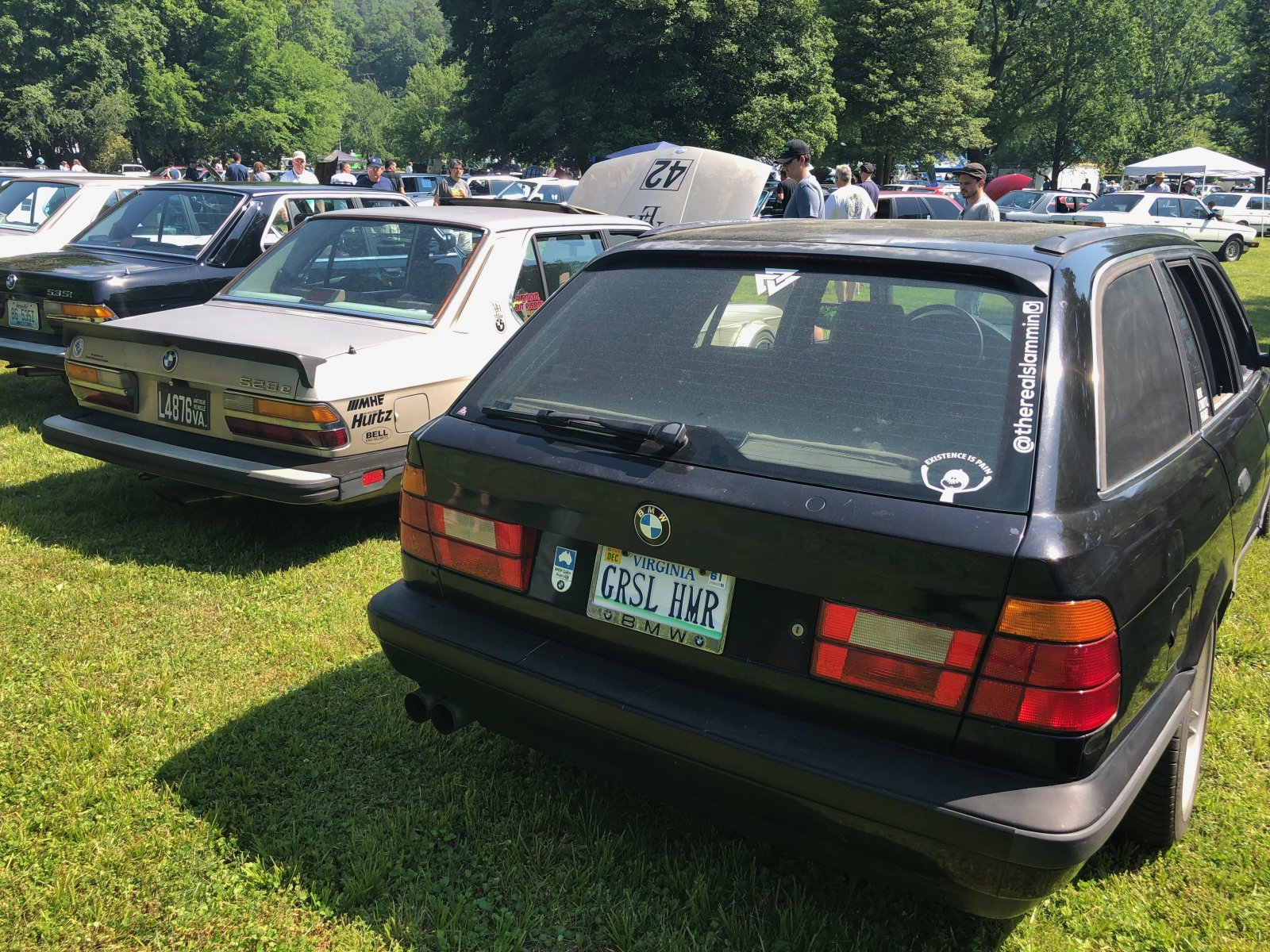

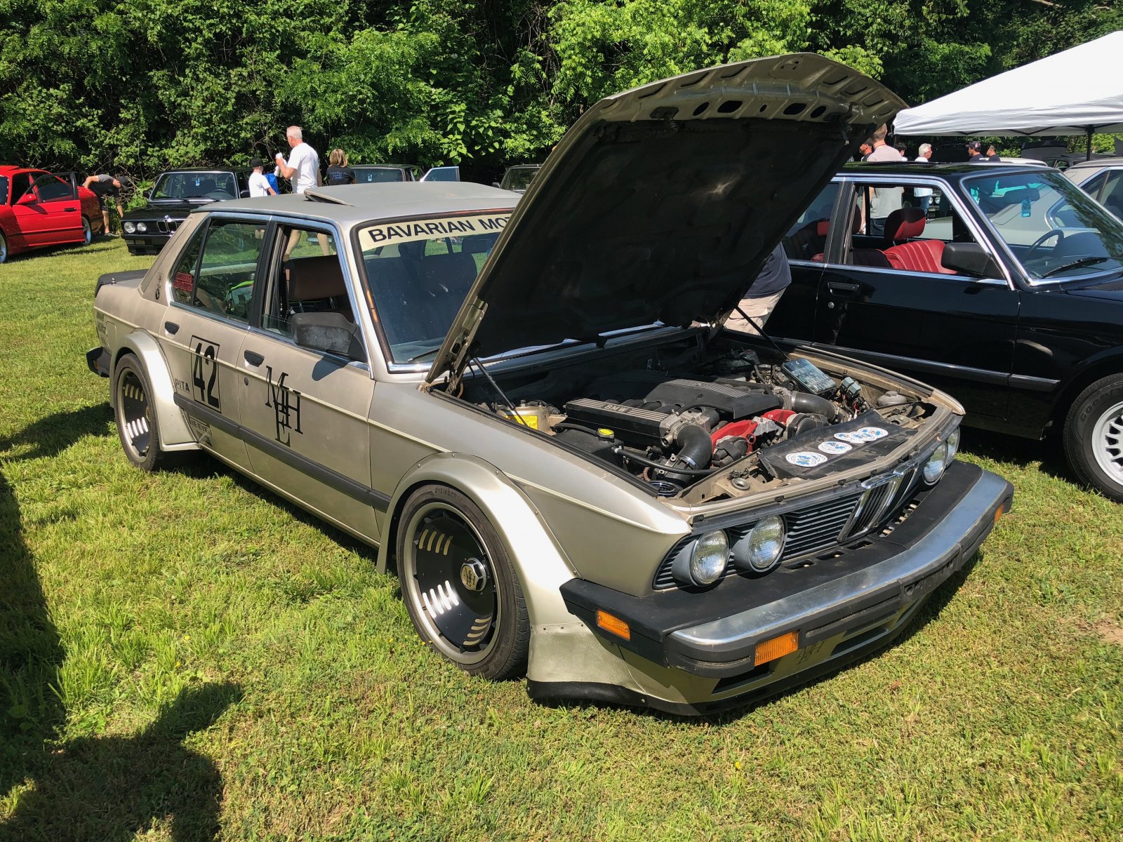

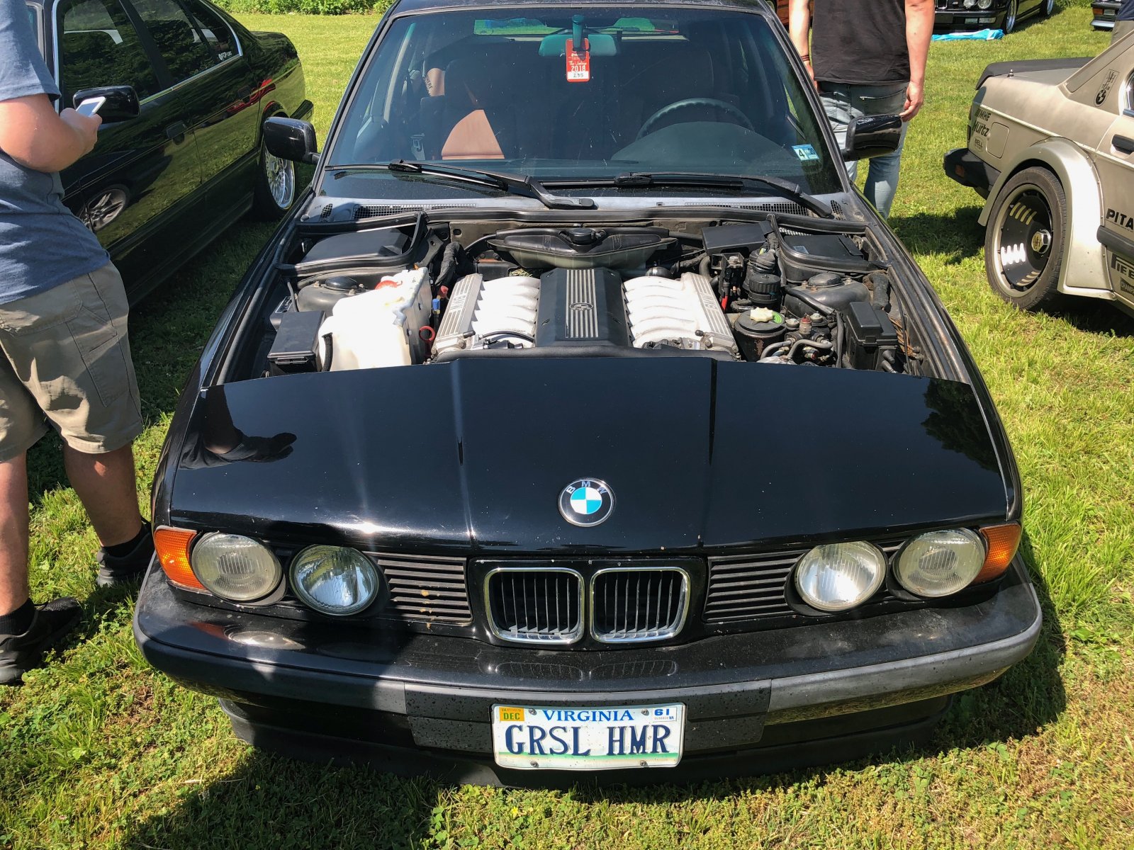

I know of two BMW 12 Cylinder engines transplanted into other BMWs. One into a 1986 535is by Paul Muskopf, the other in 1993 525i Station Wagon/Touring by Jeff Hollen. Bothe were at The Vintage in Asheville/Hot Springs in 2019.
