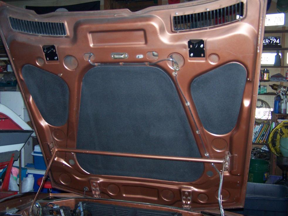

I made my own using Dynaliner / Dynamat material....1/4'' The process was this....First I stuck up a sheet of heavy mil plastic using that black sticky window caulk that comes in a roll from the hardware store....handy stuff. Traced the contours to the plastic and glued this to heavy cardboard using 3M super 77 spray adhesive as to make templates, fine tuned the rough trace with a straight edge and compass and cut the cardboard. Then cut the pieces. Sprayed the foam with bumper paint "Honda black" to knock out the factory logo from the material....turned out nice....yes?
