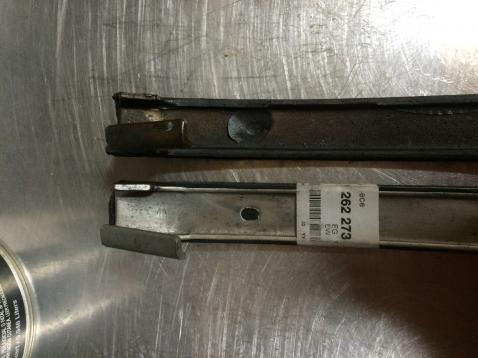

SFDon has been talking me off the ledge on a few engine issues I am working on (thank you Don), one of which is my low idle chain noise. A few years ago I replaced my original tensioner rail with a new Febi one and that's when the noise began (goes away above 1000 rpm). Now that I have my car up on blocks for the 5 speed I am also doing the front engine cover work again. Don has said in the past that the new rails don't fit the piston well and I am documenting this to show that it may also not have enough travel to keep the chain taught. He kindly offered to alter one for me but upon removing the current one and comparing it to my original one (thankfully I kept it, for once my packratting paid off), there is a huge difference in fit and quality.
I can see evidence of the Febi tang hitting the cover wall, there is not enough clearance so the tensioner piston bottoms out the tang and causes noise. Now I know why, the original has between 7.25 and 8.5mm more width at the critical area nearest the wall. Therefore preventing chain slap etc. The original rail is also longer, better made, and has a different curvature. I am putting the original back in and trashing the Febi.
Comparing the dimensions and clearances:
Original on the right, Febi on the left, The original is heavier and solid, the Febi is light and flimsy:
Height difference - original on left:
Clearance difference - wider is original, picture the cover wall coming up in between the arch of the tang:
Hopefully this will show you what you will be up against if you have to replace this part, I think the Febi came from BMW but am not positive, if anyone has bought one of these from BMW please post a pic for comparison.
Bottom line, if you get the Febi or MTC version of this part, be prepared to grind out/bend the tang to increase clearance and alter it to fit the piston (this may weaken it however), even then it may not be enough. A few extra millimeters makes a big difference when tensioning chains and preventing slap/noise.
I just ordered one from BMW just to see what shows up. If it is the crappy version it's being returned.

Well done Steve- just because its new doesn't mean it's good....
You studied it well!

Here is a pic taken by srennoc showing the wrong shape of the new part

I found the same and trashed the non-OEM one and purchased the BMW item. Better made in every way, not just the steel but also the thickness and quality of the plastic/rubber surface.

Steve, the timing of this couldn't be better. I have the same issue with my timing chain tensioner where the tang doesn't land properly where it meets up with the fork of the piston. I had to bend the tang to get it to line up correctly. However as I mentioned above I source everything from BMW. Don confirmed that he has had the same problem with BMW parts.

You may also want to check that the rail goes far enough onto the chain to provide proper tension before hitting the case wall with the tang.

Especially such a critical piece. I suppose some saftey clearance could be had by dremeling a small semicircular area a few mm deep out of the tang where it lines up with the wall.

After seeing Don's picture of the dealer part posted earlier I cancelled the order and am going to reinstall my original one.

So the tensioner (Febi) that was installed in 2014 broke the tap off that goes behind the slot on the tensioner piston and the broken end was stuck behind the piston end.
So basically no tension on chain for who knows how long.
Ordered one from BMW so hope it is not a POS.
May look at reinforcing the arm and tap before reinstalling.
So anyone that is going to install a knew tensioner arm should be very careful about the brand of the part they use.

Haven't seen a good one in 2 years
Dry fit each one with a hammer on the bench first.

This is what I found when I removed the upper timing case
cover. You can see broken off tab behind the tensioner
piston. There is a cavity below this so it could not easily
fall into the oil pan.
I bought a new BMW part and it is not any better.
I had to move the tab to the right to align with the piston.
Cast piece so metal is not that strong.
I can tell you though that I ran my engine for quite a
number of miles with this broken with no damage.
I could hear it now that I know what I was hearing.
