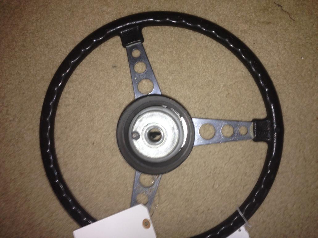

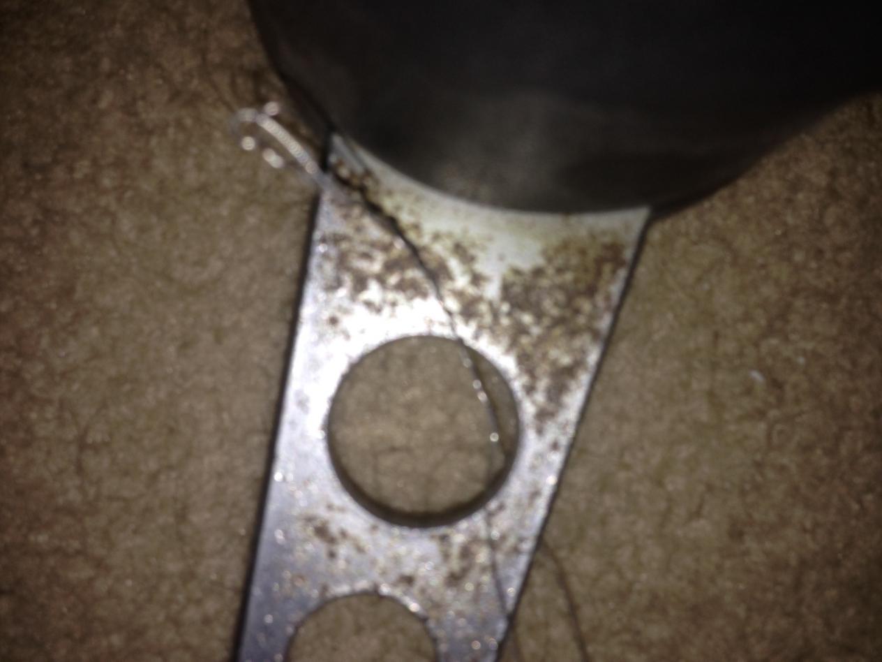

I have a Petri 38" that needs some refurbishing. Main question is the grip. The glue under the grip is no good in certain areas, I was thinking of injecting some kind of rubber/metal friendly glue underneath those areas to make it stick again, but not sure how to do that. Needle and syringe? I don't mind that the rubber is older, I like the squishy feel in a way. Or, take it off and have it nicely leather wrapped is another option. Or leave the rubber on after gluing, then have wrapped but worried that would not look right and too thick of a grip. Then as you can see there is some rust on back side, what is best way to clean that up? I don't want to scratch nice areas by using wrong Brillo pad, polish, or whatever? It looks chromed is that correct? So, shouldn't be able to use anything course. Chrome polish is what I am guessing but do not know this for sure. This is not going to be for a concourse car so I just want it to look presentable, some patina is ok and preferred actually, but I want it to function and not have rubber come off when gripping in a tight turn or something, that would not be a good thing. And if anybody knows anyone that really specializes in restoring these that has a great reputation if I have to send it there, that it will not takes weeks and weeks and I will get it back. I'd prefer someone local from LA to San Diego ok.

good luck on the metal spokes. i don't think chrome polish is going to do anything for you. the metal is oxidized ... and it isn't chrome plated. i have heard that it is next to impossible to cure what ails this wheel.
i hope that you can, as i'm sure there are other petris with this issue that would love to know how ... and given the value of them, you want to figure it out.

Chris, that was what I was wondering, I kept looking at it and looking at it and didn't think that it was chrome plated. But the way the little bubbles came up I second guessed myself. I was talking to our buddy about this and his suggestion was to take it to a local leather shoe guy, I forget his name, Fred or something I will ask him again, and have it leather wrapped/stitched. But I would have him take off the wrap that is on there now right? And not worry about over wrapping the leather to the worn out wrap, especially since it is loose underneath. I know that might sound like a dump question but I just want to make sure I do it right the first time. Your suggestion sounds right with the metal then as long is that is not plating of any sort. Good thing is most of it is on the back and you can't see it. No structural cracks or anything either. I think I will end up tackling the metal part myself and leave the wrap to the shoe guy. Probably be cheap enough that if he doesn't do a good job I will just try somewhere else. I guess next question then is, any suggestions on a nice black leather wrap for this wheel? And then stitching?
Bronze wool on the nasty stuff, polish on the rest, and a new leather wrap. The Collector would approve.

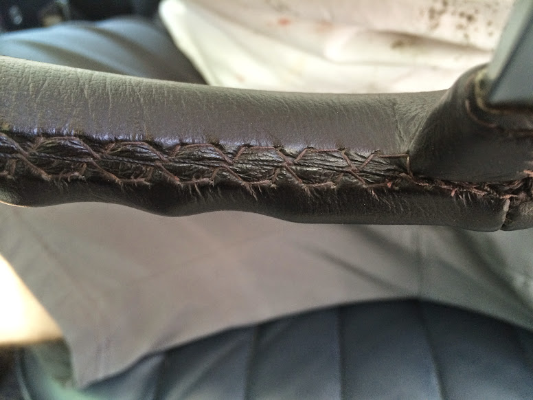

The CSL leather wheels had a cross-hatch style stitch, not the baseball type one.

Thanks for the continued advice on the injecting and stitching....now decisions decisions, I think if I can save it by injecting adhesive I might go that route just to keep it original, clean up the metal as best I can and see how I like it. I can't reverse that course of action once I go leather. Also, thank you for the stitching pic. It will be going on a Bavaria but should be the same stitch as CS correct? Oh, does anyone have any centers horn buttons for this that they want to part with while I'm on the subject?
