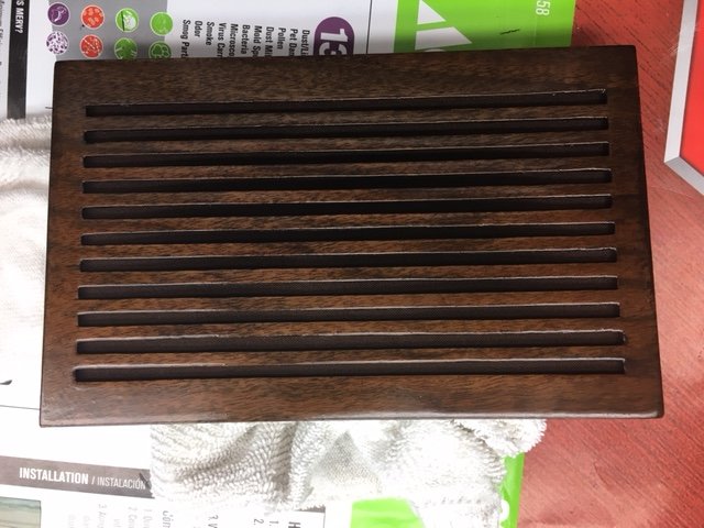

Hopefully, attached, you can see the inquiry of my ignorance ( a new forum title...:)...)

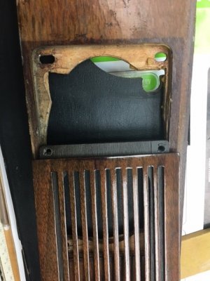

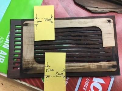

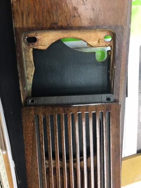

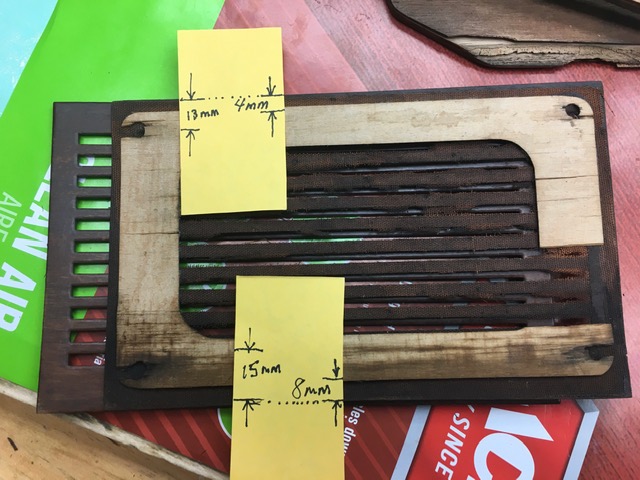

Which is the top of the grille? One "band (facing) " is 13mm and one is 15mm. Anyone with an original dash to check to see which goes on the top near the chrome trim, and which goes next to the vinyl tray? I've probably pulled fifteen or so apart, and ignorantly never really checked. Pic one shows the difference...pic 2 shows the back side with the dimensional differences...AND the grille cover doesn't center on the frame...slightly higher on the 13mm band. From the water stains on pic 2 I'd guess the 15mm band goes at the bottom, so I may have answered my own Q,. I looked at "interior photos" and a 71 brochure, but saw nothing definitive; would still like to see/know what they were virginally...
Why does it matter..? because there is a wooden fin on the vinyl tray that almost touches it upon install....

i believe wider at bottom also. here are the drawings i did a while back of the front panel and back panel. mine measured 12mm and 16mm (top + bottom)

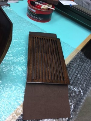

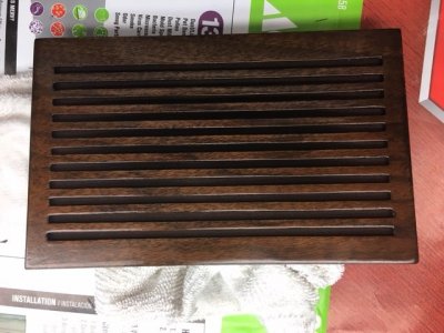

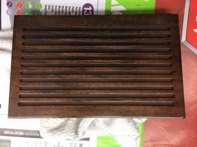

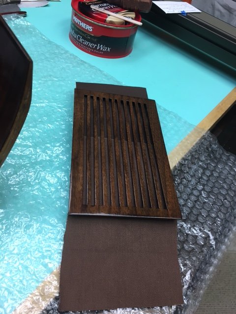

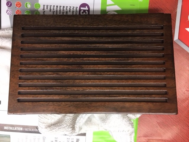

I remember the pantyhose thing...I have a dark brown fabric (pic 2) from JoAnn that looks good, (and doesn't have lycra or spandex type thread that UV will eat)..and another that is closer to the original, (pic 1) sort of a rusty (appropriate..) colour...and the two compared (pic 3)
I haven't figured out a way to laminate the grille and frame with the cloth in the "sandwich" and make it not permanent/not reversable, in case the fabric goes south...

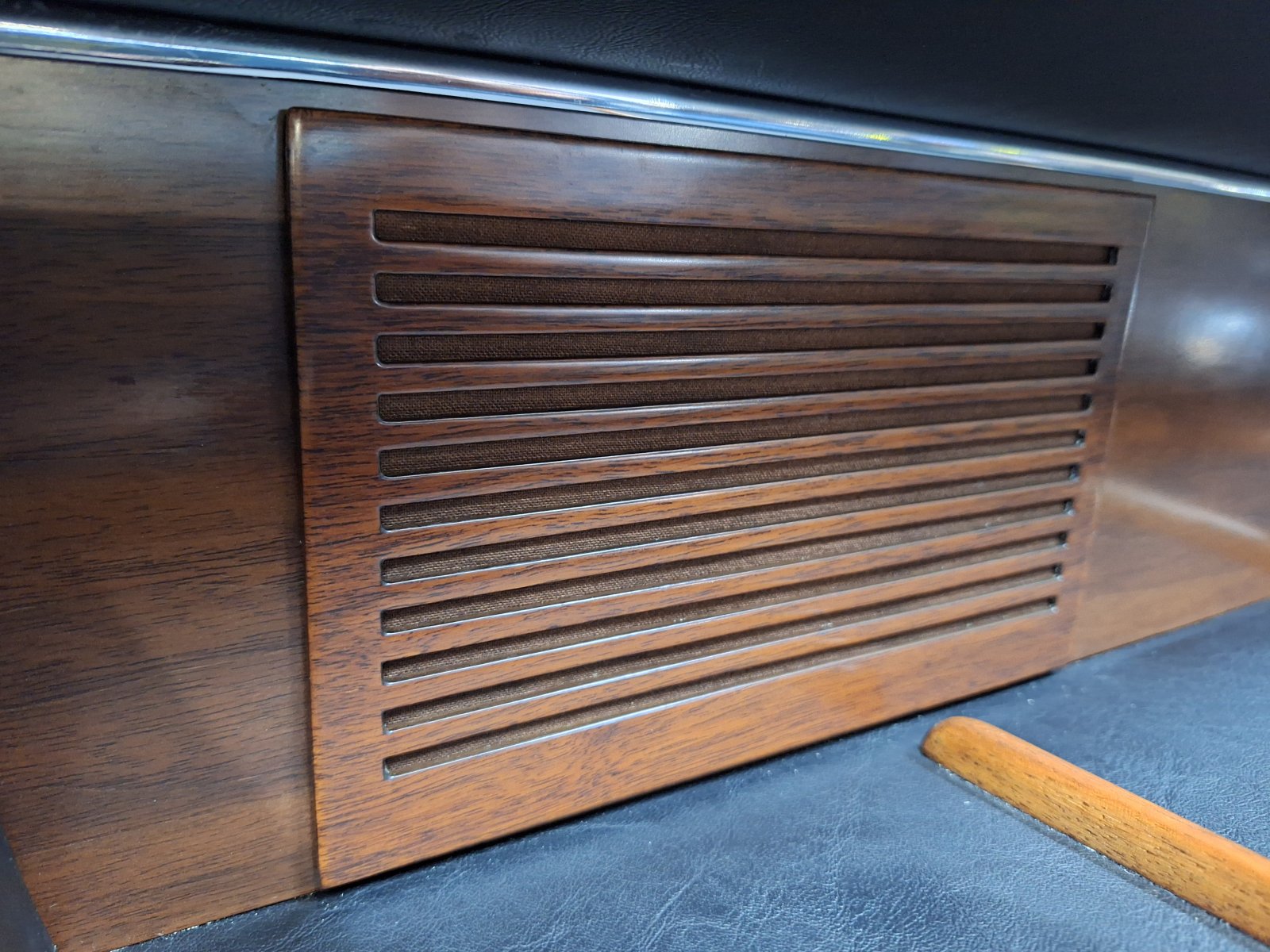

@deQuincey ; o how nice the wood looks!
I just pullled up this image and i think it shows that the height of the top band almost exactly matches the width of the side bands. Though i can't see the bottom, I think it thus must have the wider band on the bottom. In line with @Markos and @rsporsche
Image curtesy of our own site :
