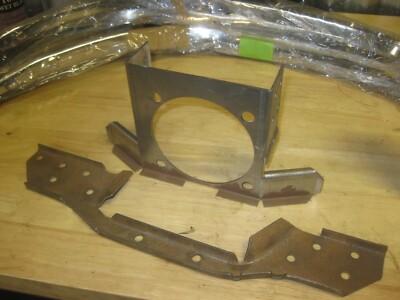

Regarding frame reinforcement, this is a common update:
