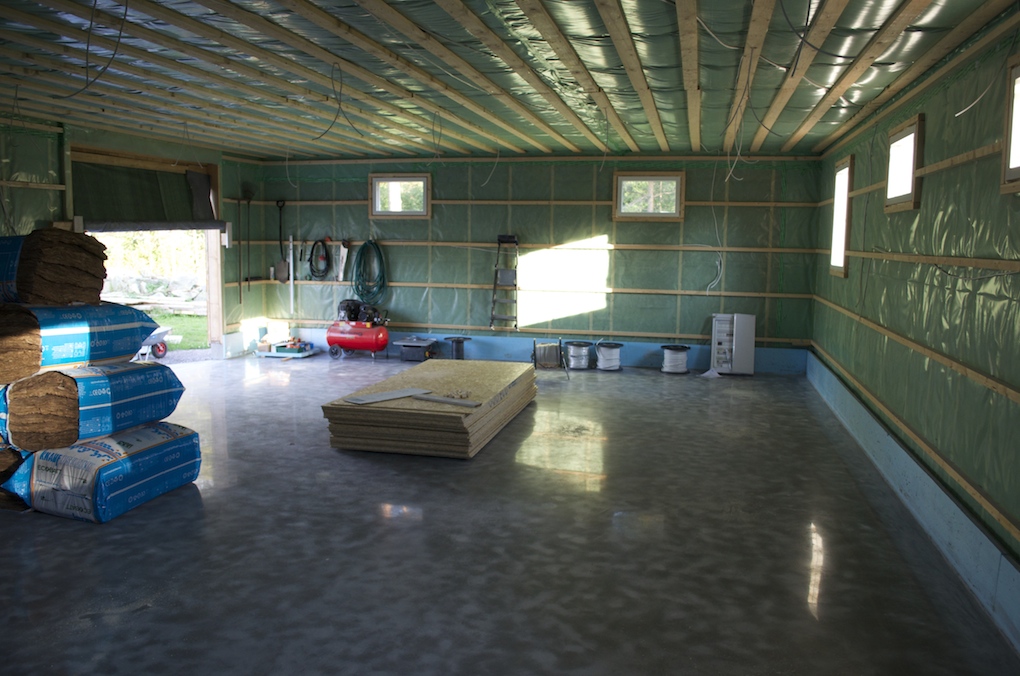

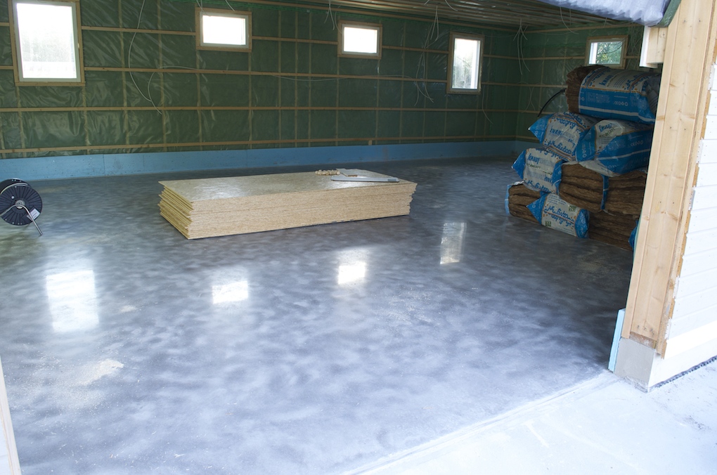

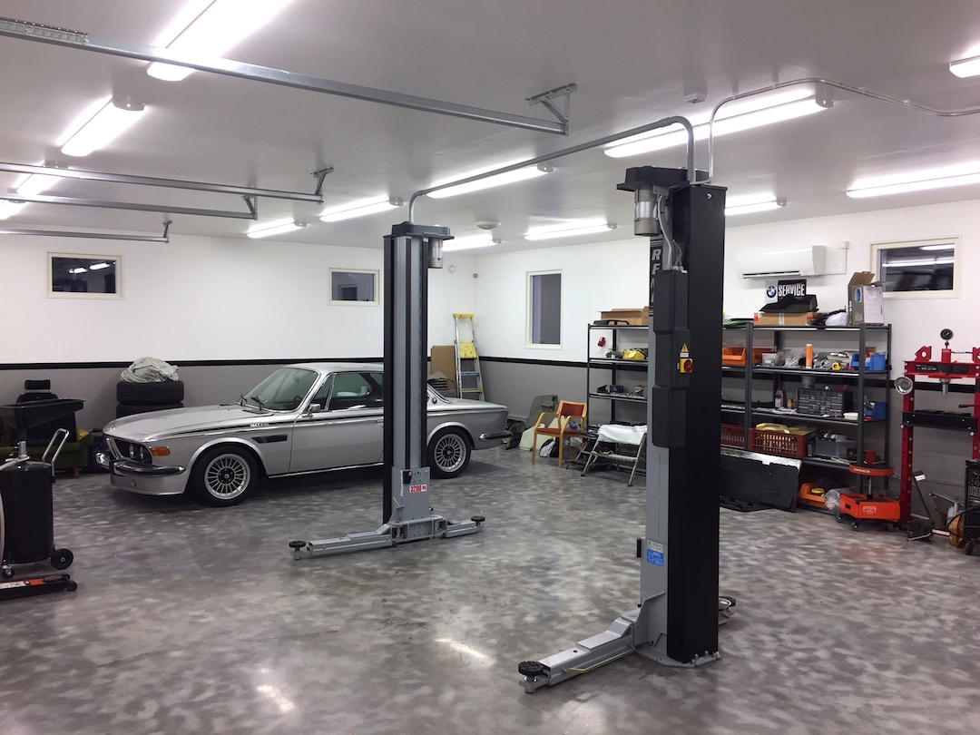

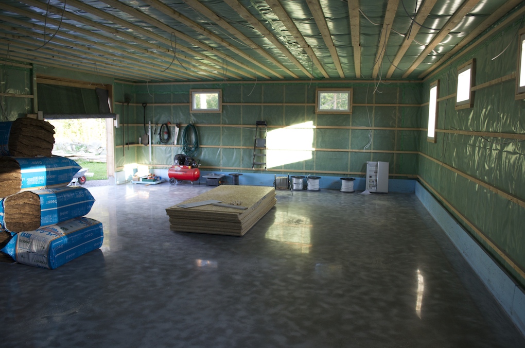

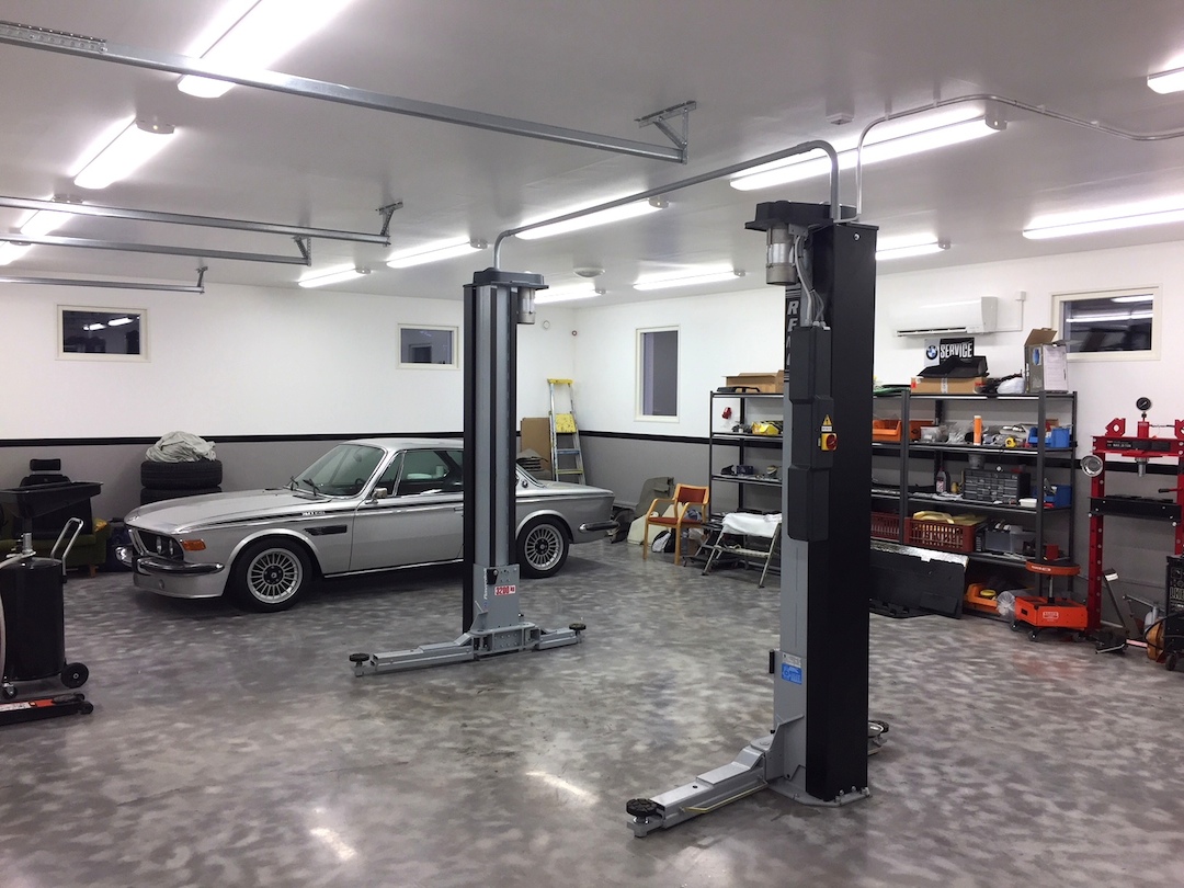

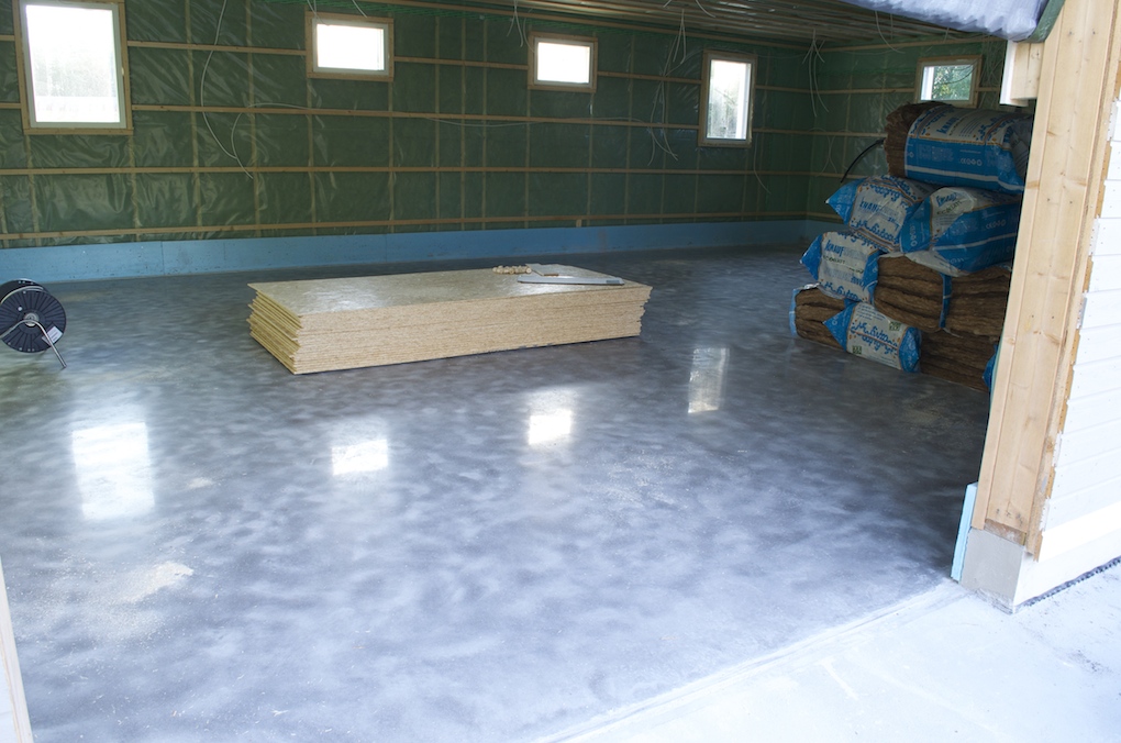

C30 concrete with Fescotop light gray concrete hardener on top, after that it was (lightly) grinded + polished and sealer on top of that.
Couldn't be more happy with it, so easy to clean and should last at least a lifetime in a hobby garage. If it ever was to get worn and look too shabby, it's easy to lightly polish and seal it another time to make it look new again.
The finished look depends on how deep you grind it before polishing, and what kind of concrete you have, and if you add some kind of colored concrete hardener.
Maybe you could make something fancy of your old worn concrete floor?
The last picture is a phone picture and doesn't do the floor any justice.

View attachment 51778 View attachment 51779 View attachment 51777
Aaaah, okay, you win. Holy crap!
