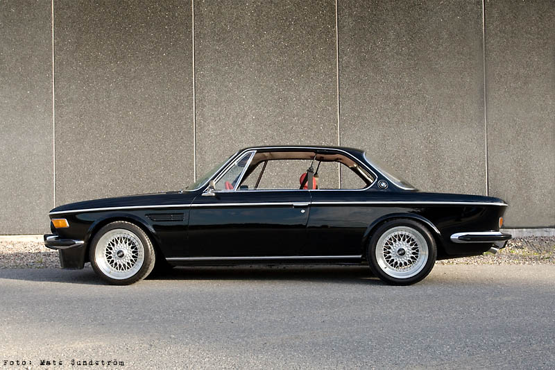

Should I or shouldn't I change the paint color from black to ?

While I think black is a great colour for our cars, be aware that the body underneath needs to be in absolute perfect condition, black shows every imperfection and magnifies them ten fold, poor prep WILL show, but get it right and it will look a million dollars.
John
It is already black, and looks like a million dollars already, with some slight nicks over the years and only one small bubble forming on the hood, that is hard to see unless you are looking for it. He is not going to bare metal, but rather painting over the paint now, so since the paint looks good now, I am hoping it can't look worse, right?

Sorry I thought you were going right back to metal, if it looks good now I’m sure it will look brilliant after it’s done, do make sure to get new screen rubbers though, be careful not to twist or deform the aluminium trim when removing them.
