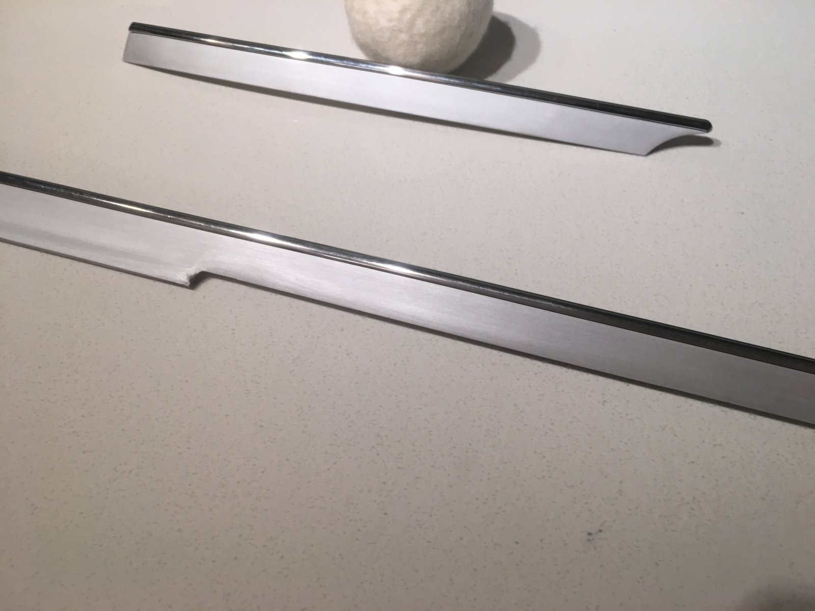

The 2800 CS has two piece trim.

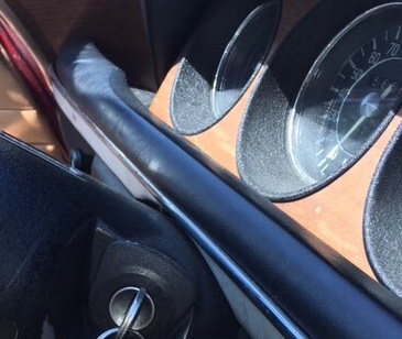

This is the one piece trim from a single-owner 1974 that I drove:

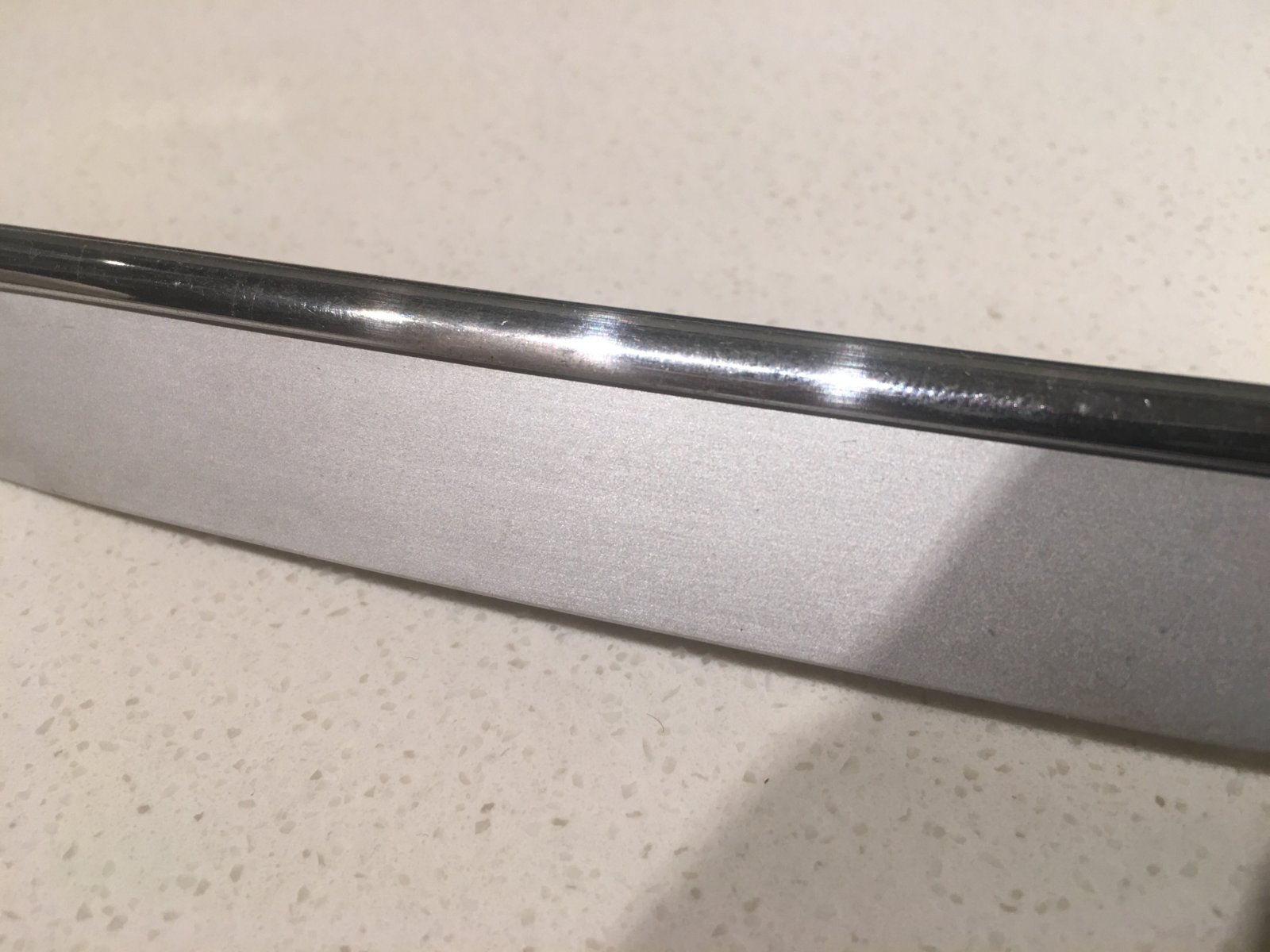

What some people may not know is that the stainless steel strip on the top of the aluminum trim is removable. The face is aluminum, and the top is stainless steel (not polished aluminum). It slides off, and I have done so several times now. I have cleaned and sold two sets now - removing the stainless both times.
Now if you look at the picture above, I would seriously question whether the 1974 aluminum is actually one piece with a delicate aluminum strip above the column - hidden under the stainless lip. Rather, I suggest that the stainless strip is one piece but the aluminum face is still the two separate pieces that we found in all years. The implications of this is that you can use older trim to replace your scratched up 1974 trim. Just reuse the durable one-piece stainless steel strip.

The 74s have the one piece trim as the adjustable column left a small gap above it I believe.
Just checked the parts book, 74 has different part numbers for both the Alu trim and the stainless trim attached to it.
What some people may not know is that upper strip - is just chromed steel (not SS) that like to have ugly pitting from rust if was in humid place for a long time;)
Funny I thought it was chrome and I had chrome in my original post. It looked more like stainless sim i edited my post after looking at my pics closely.
