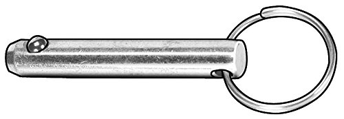

Interesting issue. Love your car btw! A quick fix would be to drill a hole through the other rail and run a bolt through it. If you didn't want to make it permanent, you could use a ring pin with a ball bearing detent. None of this will be overtly visible. Alternatively you could use an extra pair of adjustable sliders. You can remove the chrome lever and use a screwdriver to adjust. Will be tricky because you'll need to do both at the same time. Given that you likely never adjust your seat, my vote would be for the first option.

Gotcha! You could also a put the rail in a vise and tighten it up a tad. I suppose that all of my solutions may be a little more abusive than desired. :D Based on my better understanding of the issue, the ring pin wouldn't work anyway. A nut and bolt or your shim just may.
