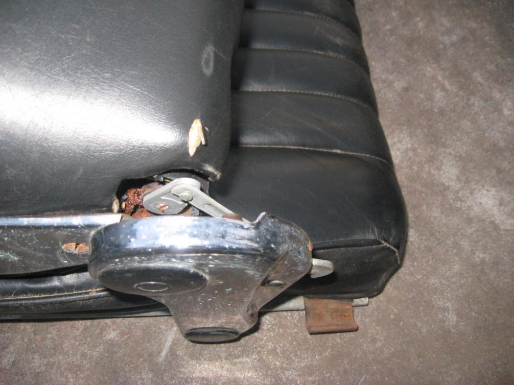

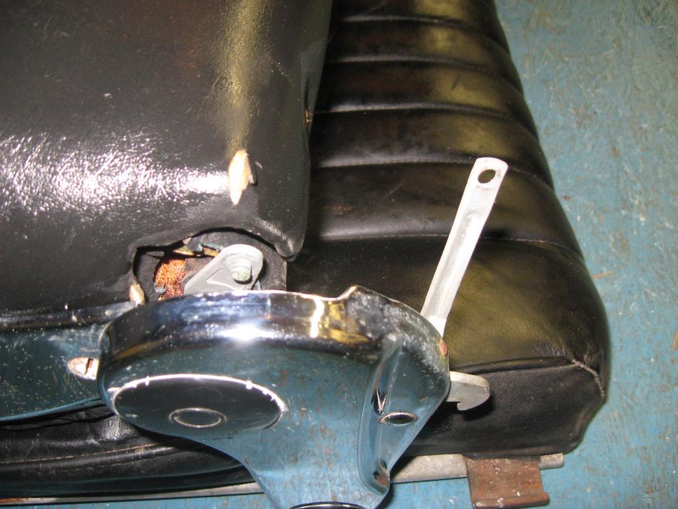

Start with seat back tilted forward to give access to components.
There's a little gray metal piece with a pin coming out from seat back bottom,the pin fits thru a bracket that is attached to seat bottom.Pin is held in place by a little clip,pry off clip and seperate two pieces.You can now slip seat release cable off of hook.

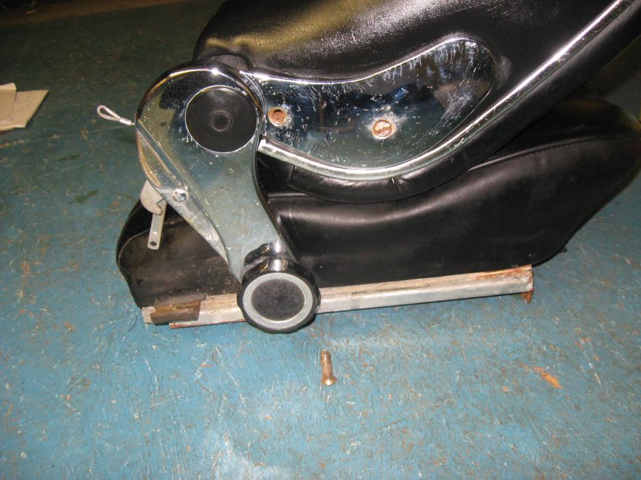

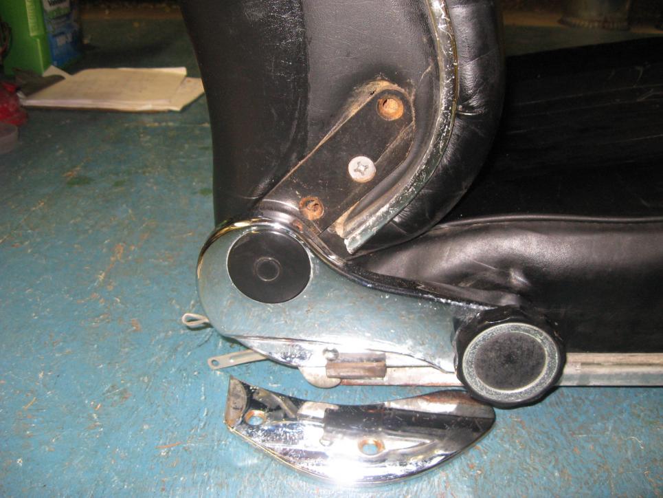

Next remove two screws holding chrome kidney shaped piece.

Remove single screw holding black bracket to seat back.
Seat halves can now be seperated.

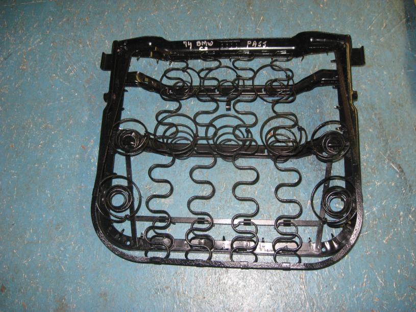

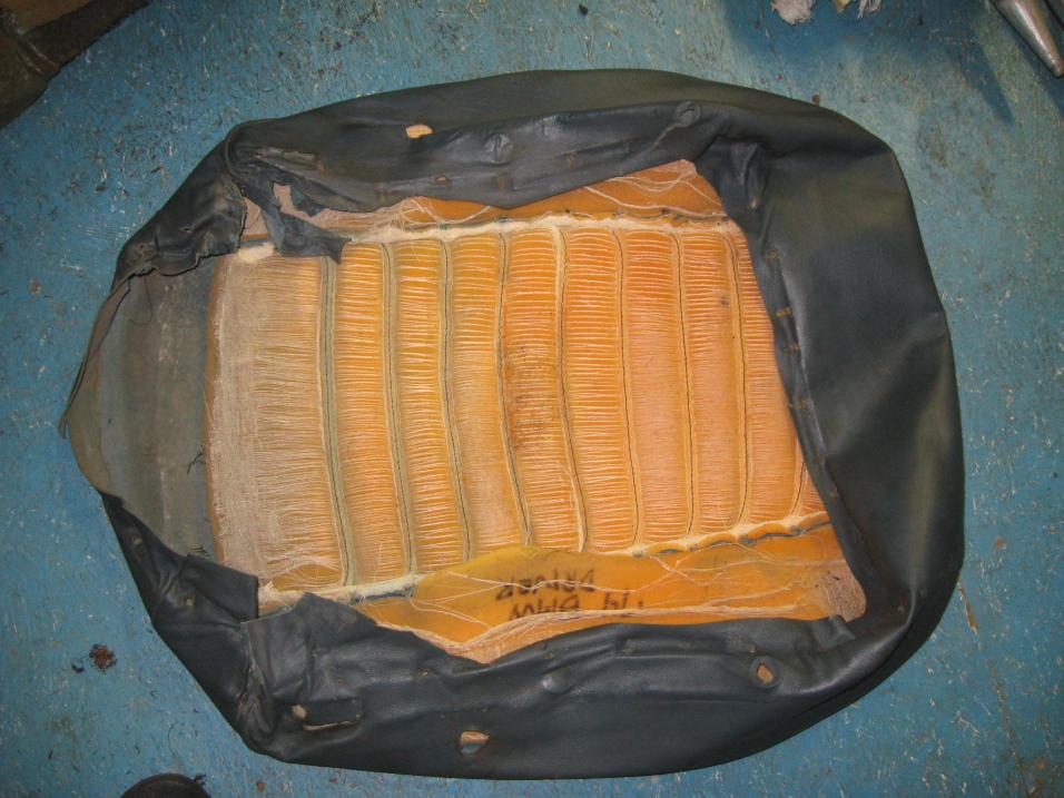

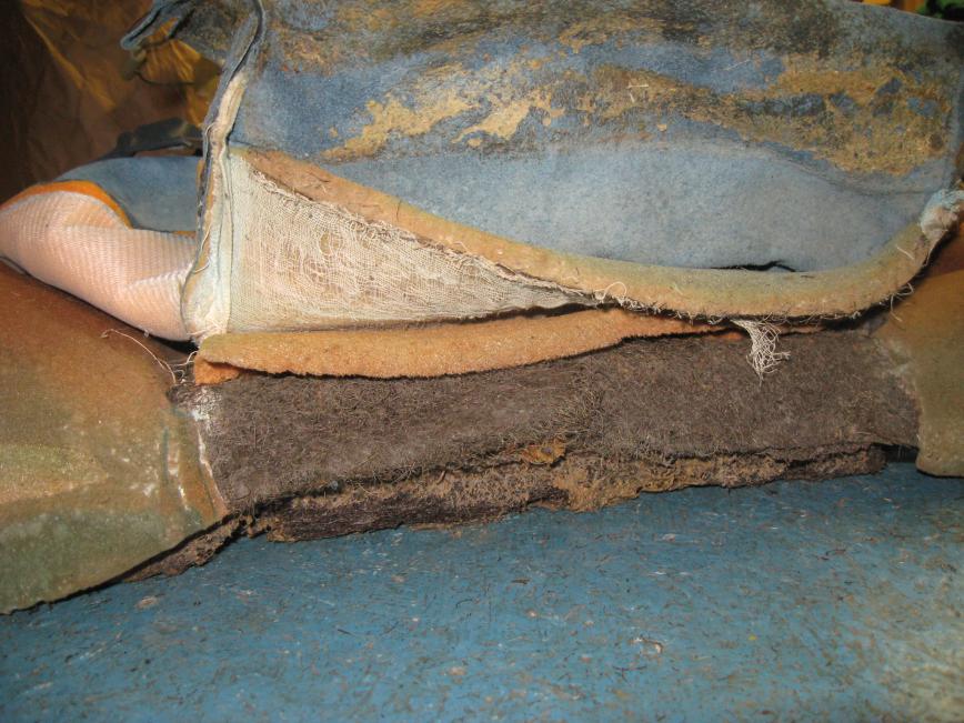

Seat foam
Pics of seat covering and frame.

Great photo expose, you are giving deQuincey excellent competition. I can even smell the horsehair at my computer!
