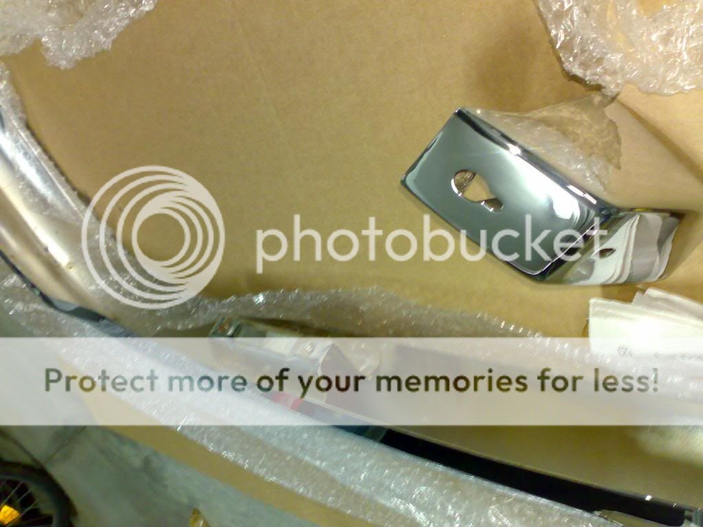

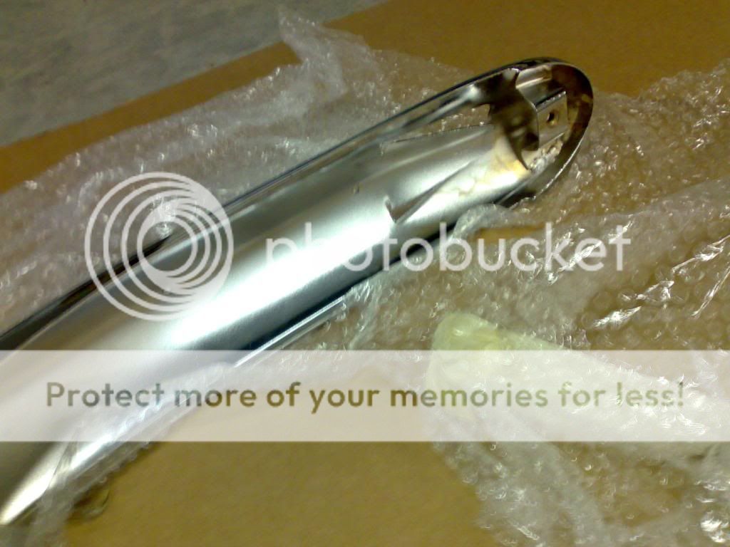

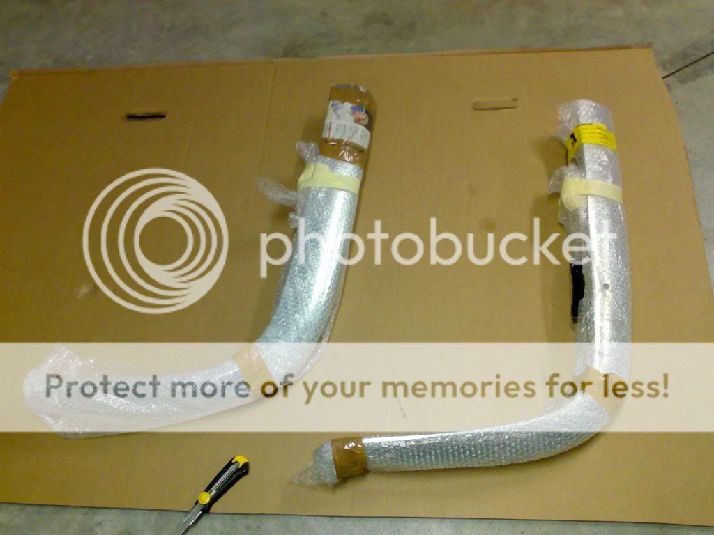

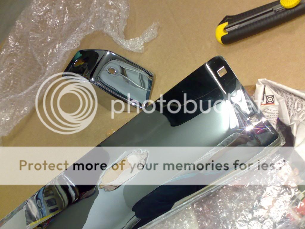

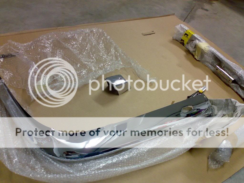

i can share this price with you,
i have a local chrome expert for classic cars and bikes
six months ago i rechromed my rear bumper, complete including two overiders
it had a bit of rust underneath the bumper, and a deformation due to some old parking bump, so it needed some work prior to rechroming
they were first made straight, polished, prepared with copper and then nickel and chromed
total cost for the complete rear bumper with overriders (5 parts) was 500€
the result was excellent
