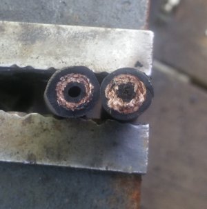

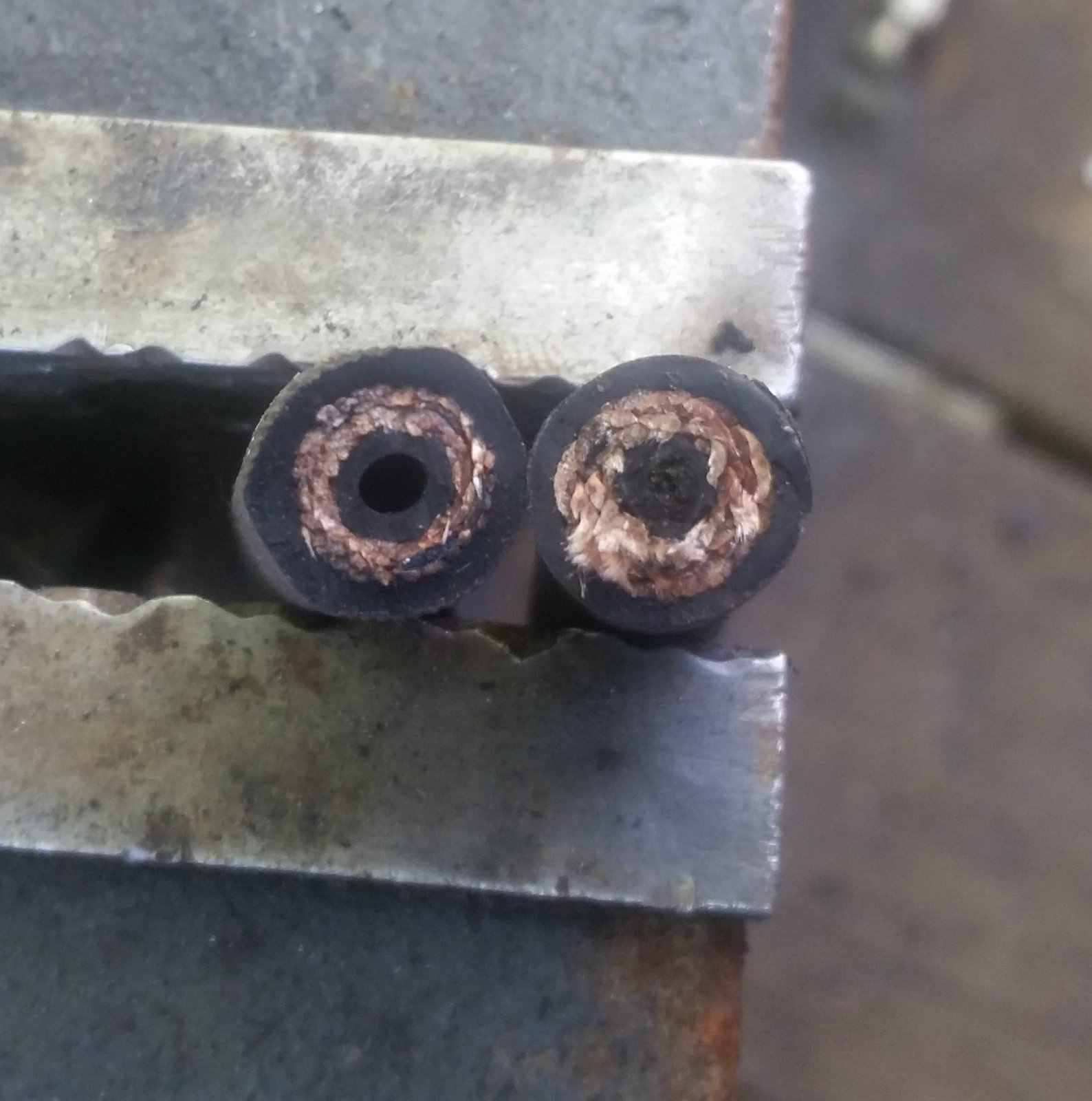

This is what those flexible brake lines look like inside when they go bad. Plugged one on the right.
