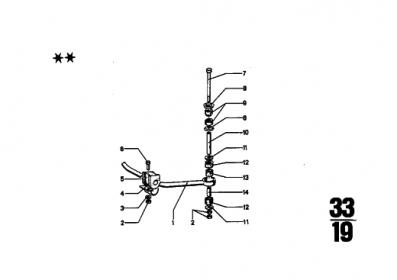

I'm having all replaced and am looking for confirmation that these two diagrams (33/16 and 33/19) will provide an accurate inventory. Was also thinking about calling Carl to see what he recommends in lieu of the factory bushings, or if anyone has experience with this would be interested in your thoughts. Thanks.

As a follow up, can anyone clarify which Part #10 I would need in Diagram 33/16? There are three listed—'68 to '75 and '73 to '75 left and right. Thanks.

Looks like 55 and 56 are unique to 74 models that is why it says 10/73. The stabilizer links are sometimes tough to compress to get the nut on. I cut one of the rubbers in half, eliminating one full bushing in effect on each side. It won't make any difference in handling. Oh, and subframe needs to drop a bit to get the large bushing on.
