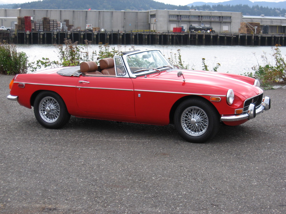

The best view of the right side of the car and all right side blind spots was my stock 71 MGB with the right mirror in the factory location on the right wing. Mounting the mirror here never caught on in the US, but it works great.

The MG photo is quite helpful. At Laguna Seca Historics this year, I recall lots of vehicles with fender-mounted sideview mirrors. I'm
certainly not an expert, but the general conclusion I came to goes like this: it seems fender-mounted sideview mirrors were quite common
in the 50's and 60's, and began to be phased out in the late 60's and early 70's... I noticed it seemed to be more prevalent on Euro
vehicles...
