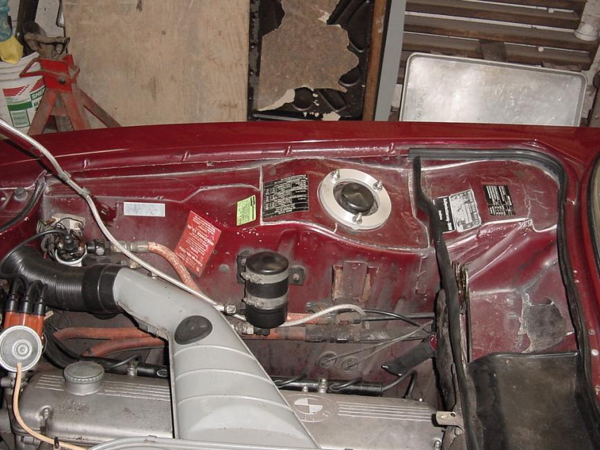

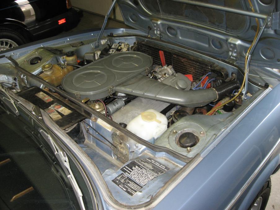

I’m 110% with Nicad & sfdon, most of all before I would even consider looking up airline prices I would want to see excellent photos of the shock towers, fender skirts and the fender’s rain gutters that connect to the top of the skirts. I’m attaching photos of a near mint California car so you can get a feel for what the stock sound deadener and panel seams look like.
Even my own maroon coupe is a pretty decent example except that the sound deadener has shrunk back and exposed white primer at the edges. When I initially contacted the previous owner I suspected it was a white car that was repainted maroon. Good luck with your search. ~ John Buchtenkirch
