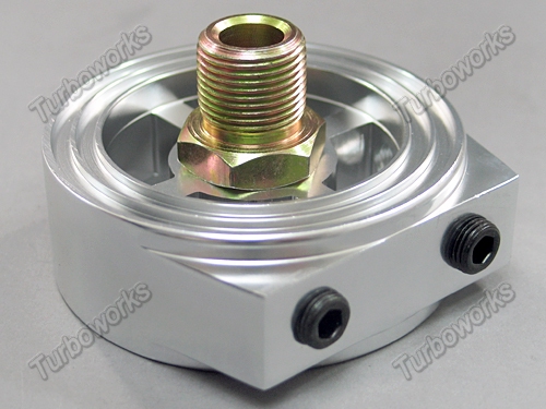

I am having trouble following your narrative. There is probably no consensus regarding which filter everyone prefers. Each has its pros and cons. Regarding originality, it's the red canister with a bolt that enters the bottom of the canister that I think you are describing. Hint: a picture may be worth 1000 words.
It is a common practice to install a later updated version of the oil filter housing (top bolt). (Second image) If, as you suggest, you have a spin-on adapter or spin-on assembly, the (probably red) housing is not much use to you other than as a desk ornament or momento. Speaking only for myself, while a a spin on adapter is definitely not original, it may be more desirable to anyone who likes to frequently service his engine.

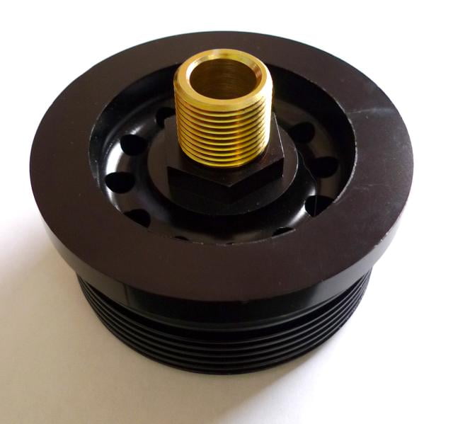

Summarizing what Lloyd wrote and referring to the great photos he posted, was your engine was converted to:
- The later BMW canister filter assembly with the bolt inserting down from the top (1st photo)?
or
- An aftermarket, spin-on adapter (2nd - 4th photos)?
Trying to decode what you wrote (yea, a photo would have clarified things), I'm guessing that you have a spin-on adapter, and need the bolt that comes up from the bottom.
GolfBavaria said:
Do most of you run those original style oil filters or have a lot of you switch to what is on there now. I want to stay as original as possible.
I haven't done a survey, but I think most people have stuck with the canister-style filter, either using the original e9/3 style (bolt up from the bottom, dribbles oil when you remove it), or the later BMW style (bolt down from the top, like in Lloyd's first photo). Personally, I have had problems with the type of spin-on adapter shown in Lloyd's third photo. The smooth surface doesn't grip the square O ring on the spin-on filter, allowing the ring to blow out when the temperature is low and oil pressure high.

If it is like the 2 spin on's I've had on my coupes (I like them), you'll have to unscrew the double threaded pipe piece out of the spin on disk base plate, this goes back into the original filter housing base. It had to be swapped over when fitting the spin on adapter.

Jay is right, the spin on goes onto the original piece, part # 4 in the second parts diagram in the previous post. The tube that was taken out of #4 to make way for the spin on piece needs to be replaced.

I have produced and sold over 150 spin on adaptors. There are 3 congufigurations. A 4” canister bottom bolted, a 3.5” canister bottom bolted and a 3.5” canister top bolted. Each one takes it’s own special threaded adaptor.
I have had only one complaint of the spin on leaking and that was because the fellow used a smaller filter than the Fram PH8a I recommended. The smaller filter couldn’t circulate the oil fast enough and it built up pressure and blew out the “O” ring.
