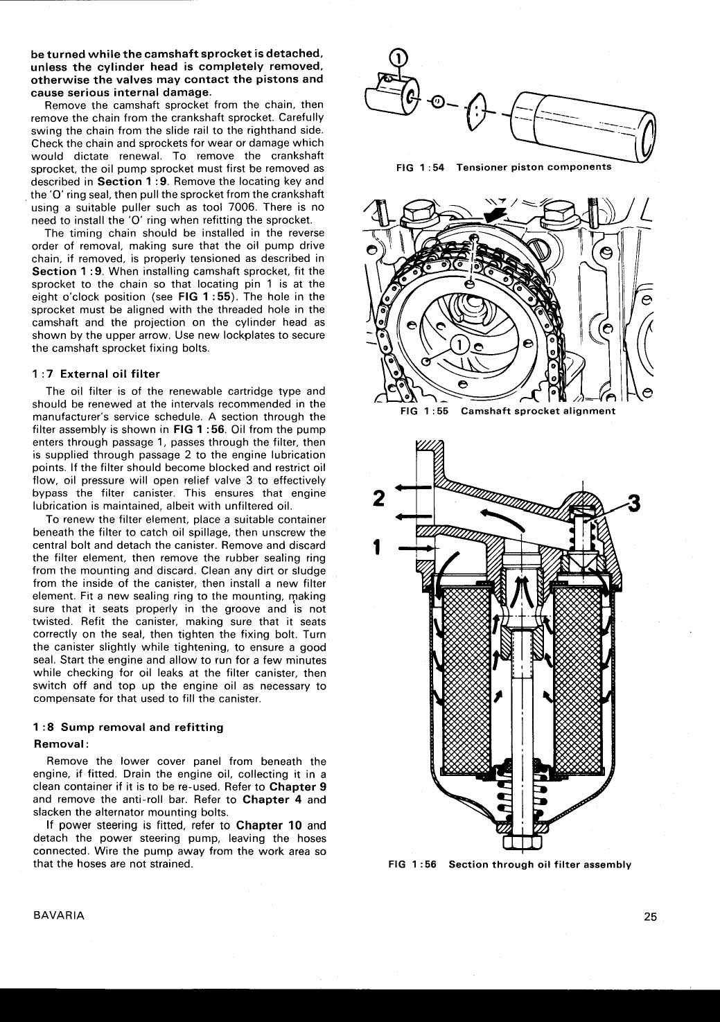

I just attempted to change the Oil Filter in my 74. Is this a design flaw or is there a secret to changing it. It looked like a tight squeeze but I thought it would drop down between everything below it. Well no such luck. I ended up lifting the old filter out of the canister from the top and dropping the new one in from the top and then screwing in the canister. Is this the correct way to do this or do you need to remove all of that below to get the canister out. I also now seem to have a leak now. Tightening as much as I felt comfortable doing. In side the canister was a spring that I could not figure how it was to go back in. I thought maybe the original filter was smaller and needed the spring to hold it in place. I ended up leaving it out. It did not seem to do anything. The hole in the filter was bigger than the spring and the spring would have just moved up and down not doing anything. I checked the filter that came out and it was the same as the new one. Any suggestions or comments are greatly appreciated.

Also there is a plate that goes on the spring which fits against the filter to hold it against the block, if you don't have this, get it asap! They are available and my PO's mechanic had left it off thereby making the filter useless. #13 in diagram plus #14 which is a rubber seal that fits into the plate. #3 is the crush washer, #11 is the rubber housing o-ring - both needed to cure leaks:

If you plan to continue using the original style filter assembly, examine the picture below for the orientation of the spring. It keeps the filter media snug against the top portion of the filter housing. Without the spring, the practical effect of your filter assembly is nil.
It is also a good idea to change the washer that fits on the bolt responsible for securing the filter cannister to the housing. It must be in decent condition - especially on the original bottom bolt style housing. Otherwise, you may have a leak even when the engine is not running. Add oil pressure, things can be much worse. The rubber o-ring that fits the top of the cannister housing is likewise essential. If it is compromised (kinked or pinched) when the engine is operating and producing oil pressure - it can become what seems like a major news event about a threat to the environment.
