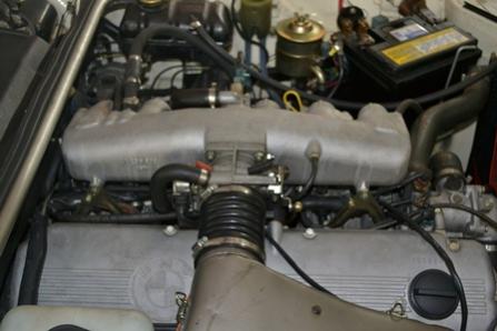

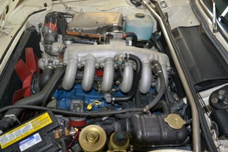

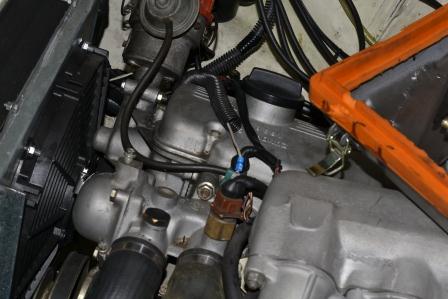

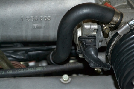

Before
Here are some photos showing the Motronic installation.
Ray

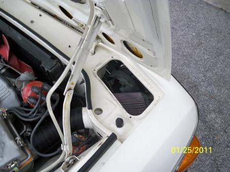

Very cool! Love how you incorporated the L-jet AFM into the D-jet air filter box.
BTW, where did you locate the new air filter housing?
RJRuiz
109
39
Coral Gables, FL
K&N behind the passenger side headlight; works well there.
Will be removing the AFM and using a MAP sensor with the Mega Squirt, going back to the standard filter configuration then.
