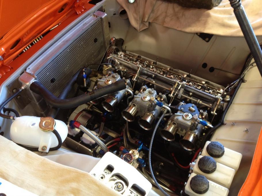

We developed an overheating problem that actually followed us from Sonoma. The inlet tube on the water pump was being sucked closed at high RPM. We didn't discover it before we experienced some overheating issues during the last run in Portland. End result- warped head. We sent the head off to Korman, but it was too far out of whack to resurface, so Korman put the rush on and prepped a new head for us:
It arrived at GMT this morning and Tim and crew are putting it on as we speak. We also sent the carbs out to Loyning's Engine in Portland for a little modification to help with fuel surging on left hand corners. They arrived back at Tim's shop last Friday.
