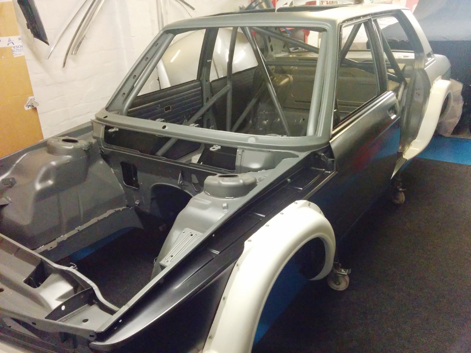

My e9 was sent through SPL process; dipping & ecoat finish, and my e12 through Paint-Strip process; thermal pyrolysis and epoxy finish.
Pros and cons for both. Plenty on the internet rather than me do a full report on both! Found ecoat expensive, but reached inside box sections etc. Very minor post dip weepage. First dip struggled with very tightly packed corroded seams. Pyrolysis cheaper, left some minor corrosion behind spot welded brackets etc (maybe because the shell is phosphate rinsed vs dipped for the rust removal and so you don't get the same penetration). Comprehensive rust inhibition required in box sections etc after painting (which is also worthy on an ecoated car too)

e12 and e9 post process
