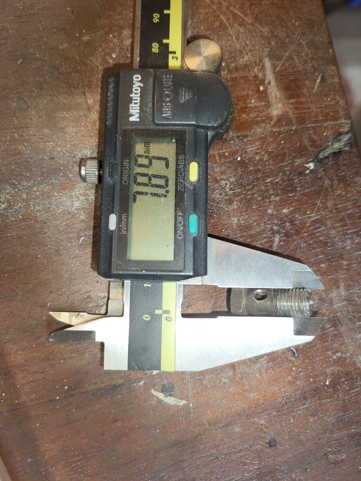

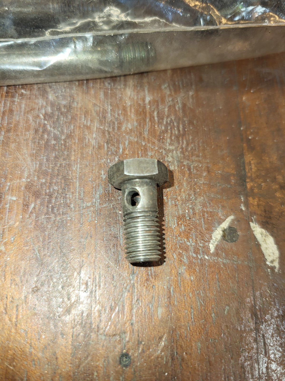

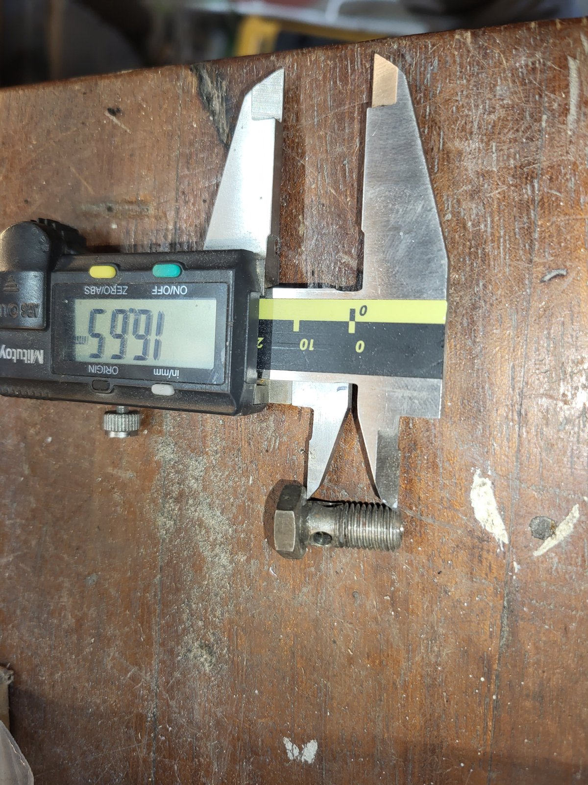

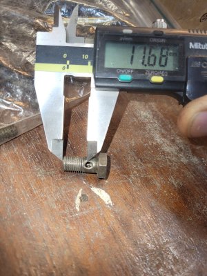

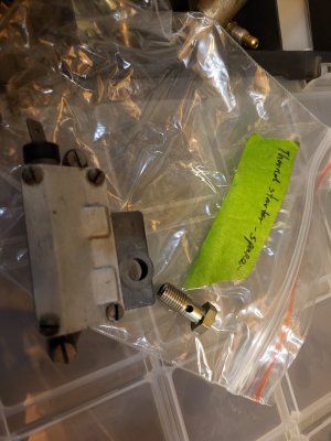

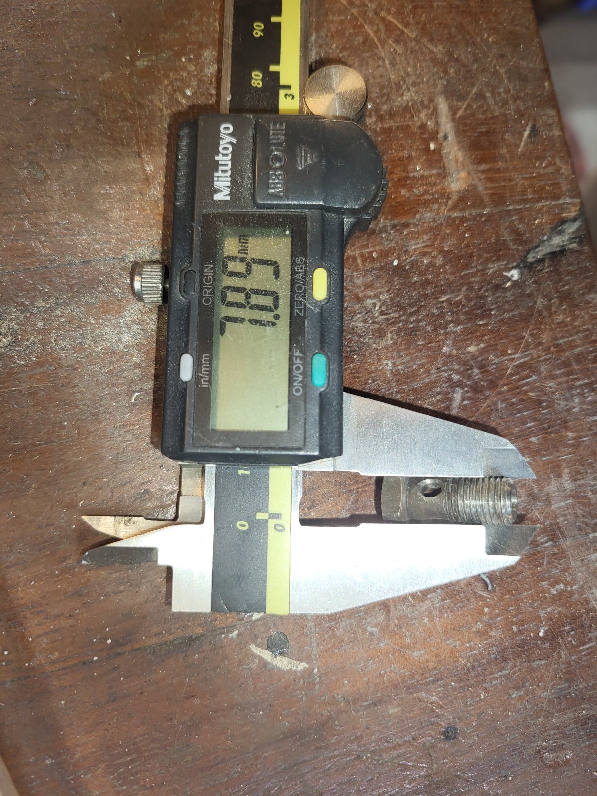

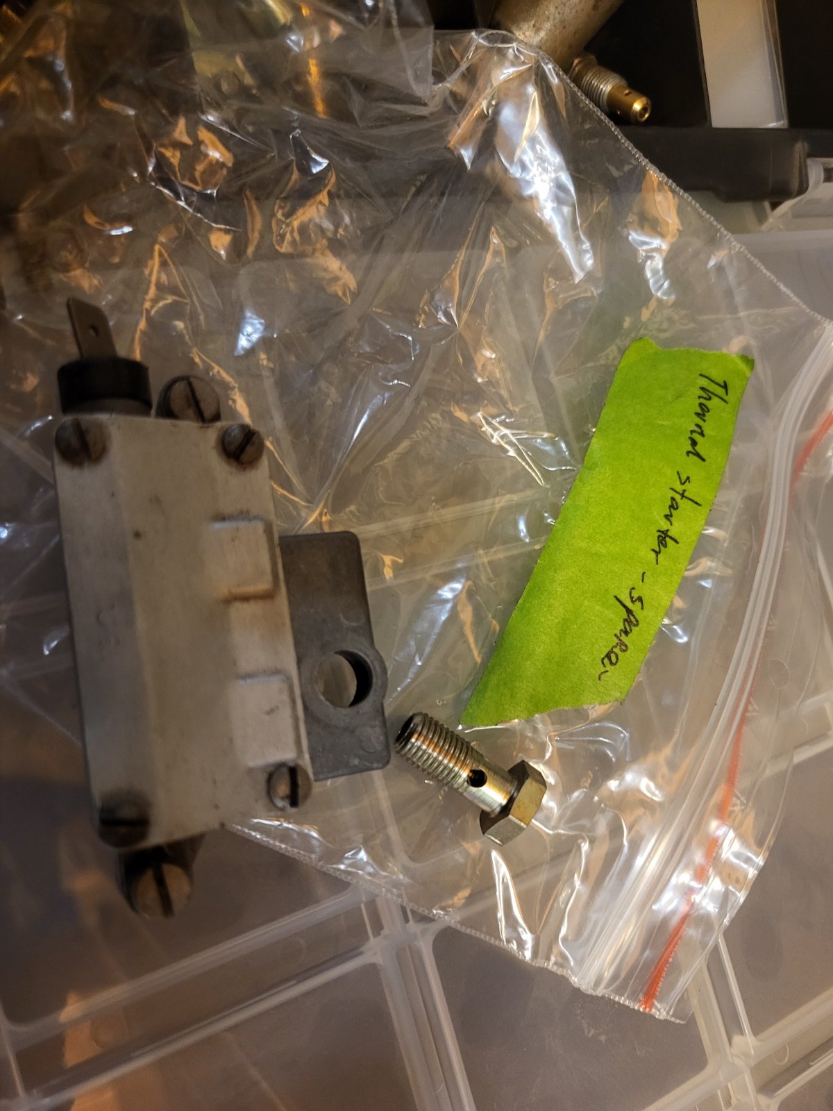

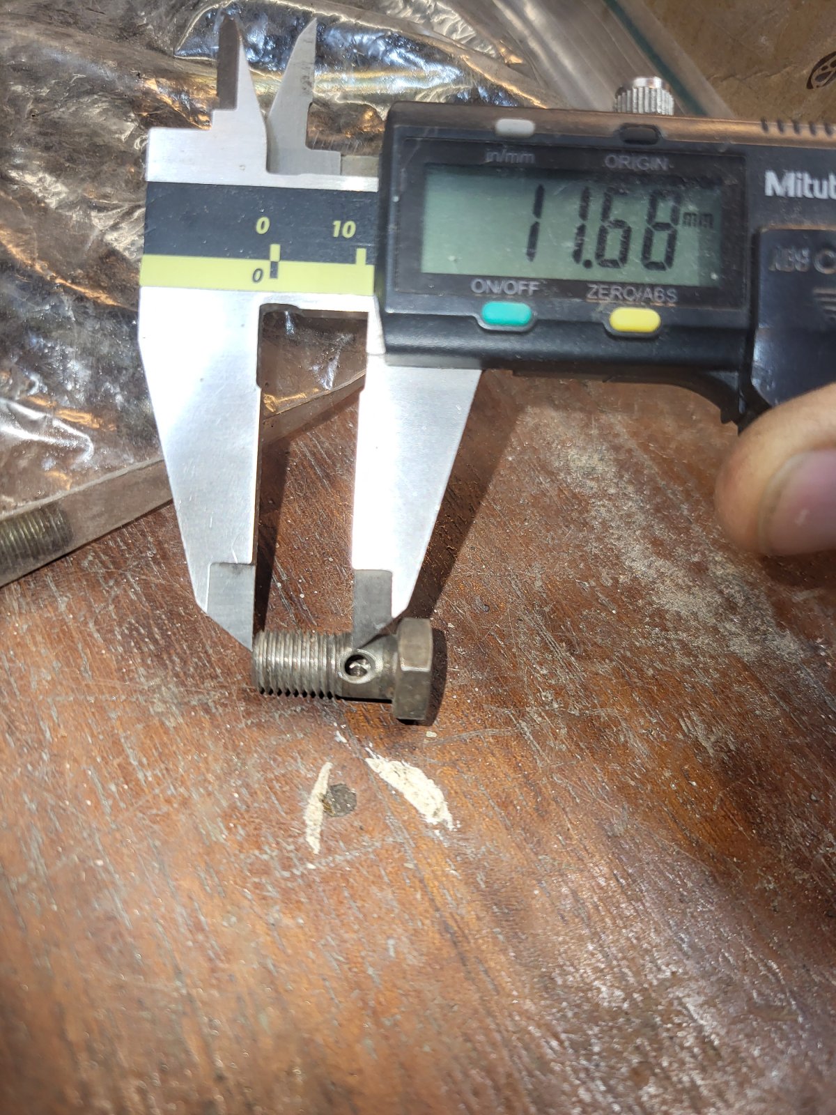

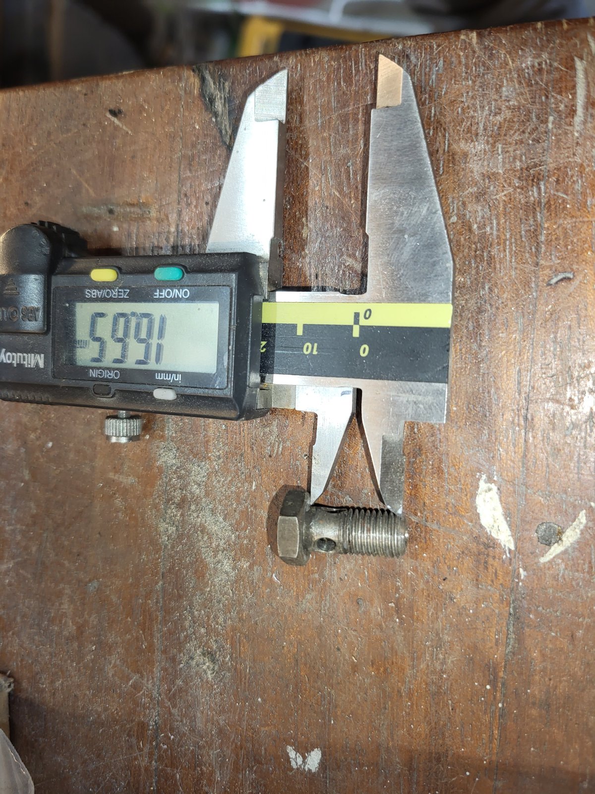

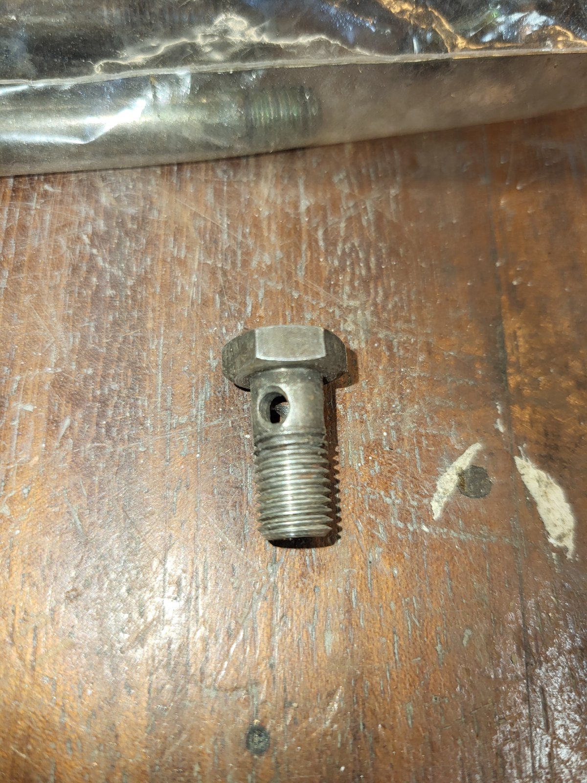

Hollow bolt should be this one. Shiny on is from my own car, so can't sell that one.
The used one is also from a thermal starter unit, but funny enough it is 2mm shorter. Still same M8 fine pitch thread and drilled for fluid/air transport. Should still work I think.

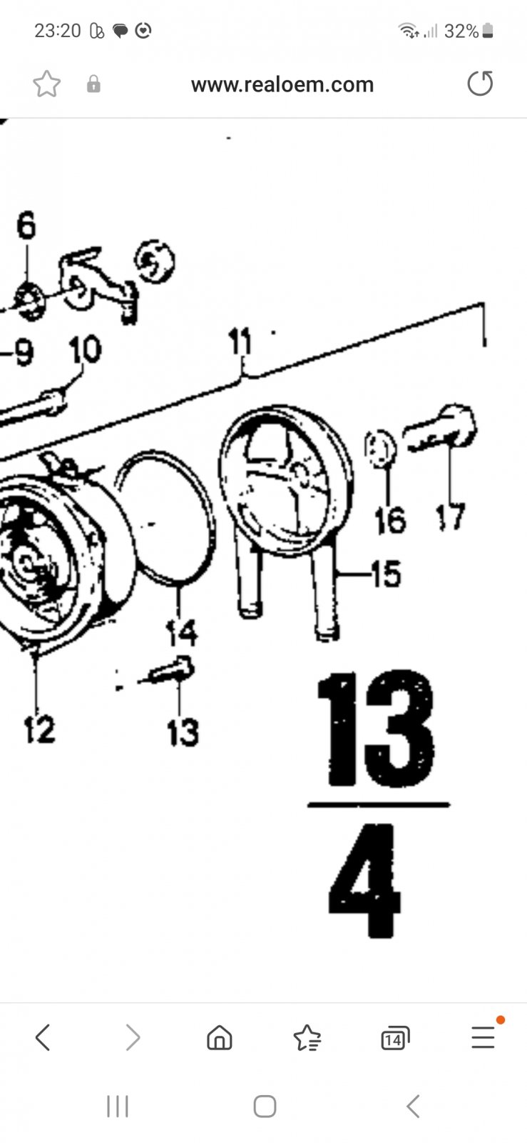

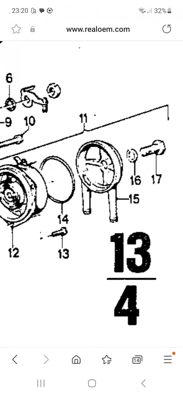

I think the "gasket ring" can be any std copper washer / crush washer. It should seal the cooling fluid from escaping.
#16 in the image

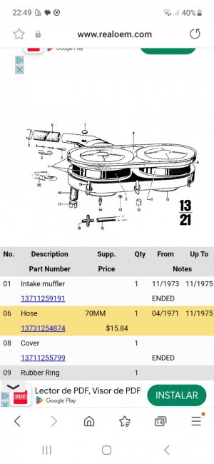

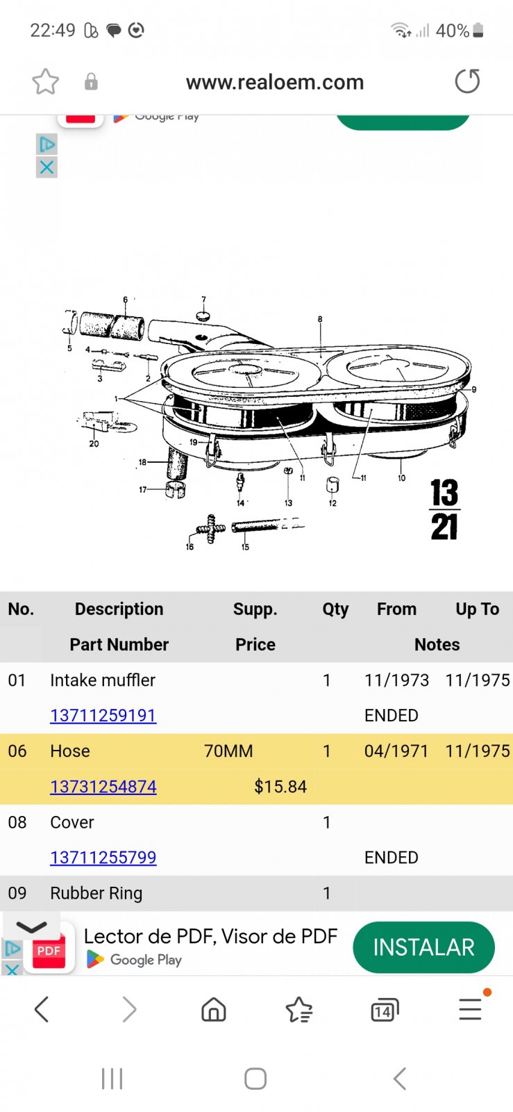

The last pn comes up as a 70mm hose for air intake, not a "screw".
FYI, realoem.com provides these nice images. It gives you something to reference.
Pls check the part & number.
If it is a screw, I may just have it, fresh zinced even if you're lucky....

No cooling fluid here and a standard Alu crush washer works.
Alu, good choice indeed.
You sure about the fluid? I added the realoem.pic in the post above. Isn't there cooling fluid going through those two pipes on the part it screws into?
I know those screws are stubborn, and often one of those pipes breaks off while trying to unbolt them.
